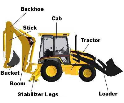

Starting to look like your back-hoe is double jointed compared to the below diagram, might be in the unusual category...........

Yes, well I said before it will be a tripple boom style. Many excavators use this kind of boom, especially "city" types. This way you get maximum reach and height, but you can also dig in tight places, near walls etc.

Many............ Maybe over there, but over here It took me 10 minutes just to find a picture of a triple boom back hoe and wasn't even on a tractor, this back hoe build will be interesting when all done next year epically if it works. No pressure but the whole world is watching...
