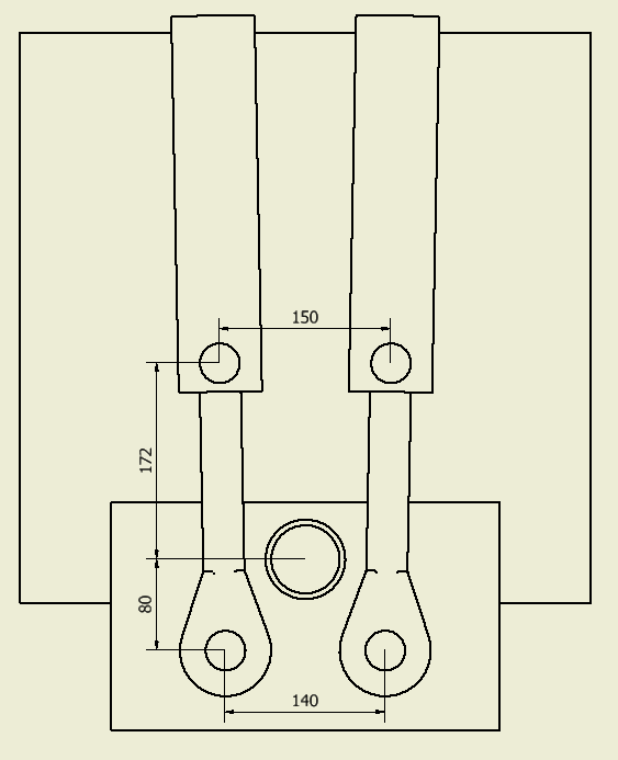

Hi, I really like your project. I came here because I'm looking for a rotation solution for my excavator. I have a serial, old excavator where the rotation is on a toothed rack. I know you mentioned that you spent a lot of time coming up with this rotation mechanism, but is there a chance you could provide the specific distances between these axes? For now, I've come up with something like below, but it seems to me that it still lacks a bit of an ideal solution.
It will never be ideal, at max stroke the cylinders will always counterpush, but since they are almost dead on the boom swing hinge it doesnt really matter.
