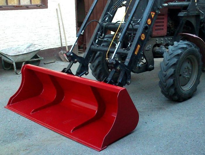

The thing I've been wondering about since I first saw this part of the project is the top plate held down by the 6 bolts. There's a lot of stress in this area with all the metal that will be swinging around out on the business end of this thing. Do you think it's going to hold up over time or have you considered reinforcing it? Not bashing the design. Just looks like a potential spot for something to let loose.

Thanks. I started to put things together. Here's the connection of the main boom for the first time. I had to put everything in place to weld the bushings for the best parallel alignment. The deviations were negligible. After tacking everything in place, I tested the whole boom movement, just to make sure it moves in a straight line; and it's ok. :)
The 6 bolts just have to help the top weldment/pin bushings hold things in place. They are in "shear" condition, meaning they would have to shear off sideways to fail. They have to hold the forces applied by the 2 cylinders underneath the plate and any force built up with momentum of swinging the boom. And remember, about 1/2 of the force available will be on the underneath weldment. The momentum mass could be greater than the force of the cylinders. Could it be the weakest link? Possibly, but If BFreaky puts a pressure regulator in the line to the 2 cylinders, he can adjust the amount of pressure which will also slow the speed of the cylinder movement. which might be a good thing.
