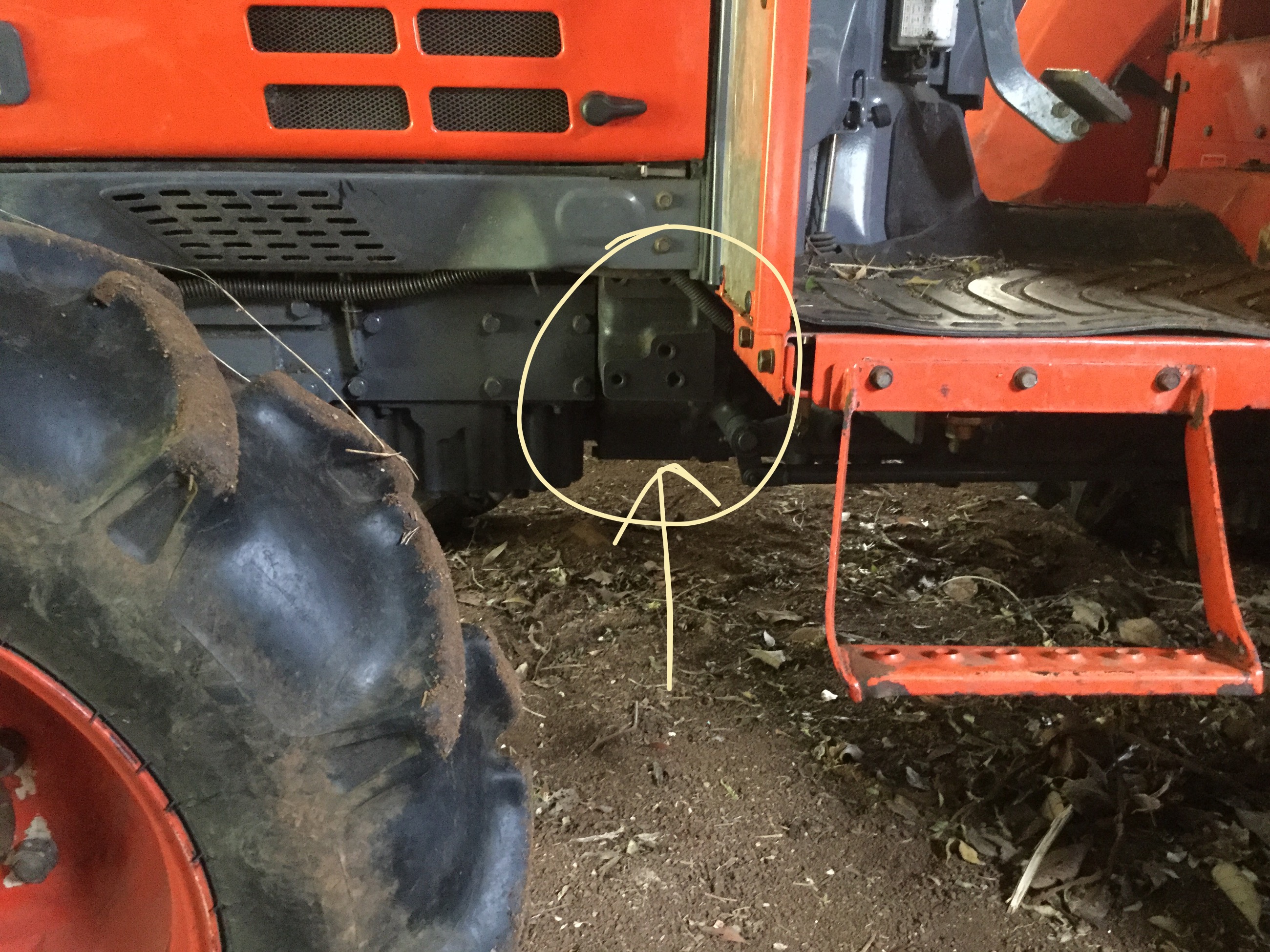

I am planning to put a dozer blade on the front of my Kioti dk35 and wondering what mount points are the best to lift it from.Is the best spot to say add a 1/2 inch thick bar down from where a front loader would connect ,see image,and then add the arms to pivot from here and under the front axle?
I will mostly use it fro pushing over small bush.
thanks Michael

I am sceptical this will work satisfactorily. FELs are designed to lift, not push. My Kubota Operator's Manual specifically warns against "bulldozing" with the bucket. A blade on the front will decrease weight on the rear, driving tires, so you will loose traction fast.
I do not think your chassis will stand the load with a center mount, using indicated holes as pivots.
What advantage do you see to this over a Three Point Hitch, heavy, adjustable, rear/angle blade?
The Three Point Hitch is designed to take heavy loads. Tractors are engineered to PULL, not PUSH.

Center only mounted (FELs) concentrate a whole lot of stress ... I believe an additional rear axle set of supports tied to the mounts you posted would make the proposed blade addition a bit stronger and safer for the tractor
Guess it could be possible- and make sense if coming off of a small dozer
jmo using only the center mount only might be a bit risky- again, if some extra supports could be run between the rear axle and the attachment point pictured I think that would be helpful or if already there, then well on your way, i just wouldn't mount a 3000lb+ blade is all . Hope it works out well

I would look at how the loader is mounted. The center bracket for the loader probably has reinforcing that also connects to the rear axle, where the majority of the tractive force is generated. I would duplicate this so the majority of the dozing force is put on the back axle, with the center or front mount being primarily to locate the blade side-to-side and lift it up/down.

Using the points you indicated on the tractor, which appear to be where an FEL would bolt on, will put less stress on those points than the FEL would. Warnings against "dozing" with an FEL are to protect the FEL framework, not the mounting holes.
A dozer blade properly designed will remove weight from the front axle and transfer it to the rear axle when pushing. That's why they are so effective. How much transfer happens will be determined by your design of framework.
Front axle traction weight can be added when lifting the dozer blade while pushing if your design permits it.

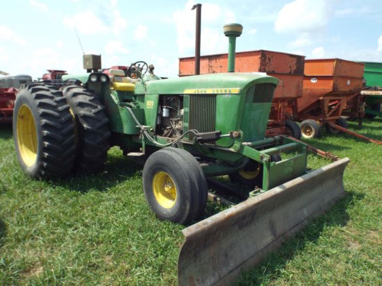

My old 8 hp Farmall Cub has one did a lot of clean up with it. Grouse makes a nice front blade. Most tractor mfgs sold a blade kit. I'm not a fan of a rear blade myself hate looking backward. A friend had an early eighties 2wd 40 hp JD with a JD blade does good work.

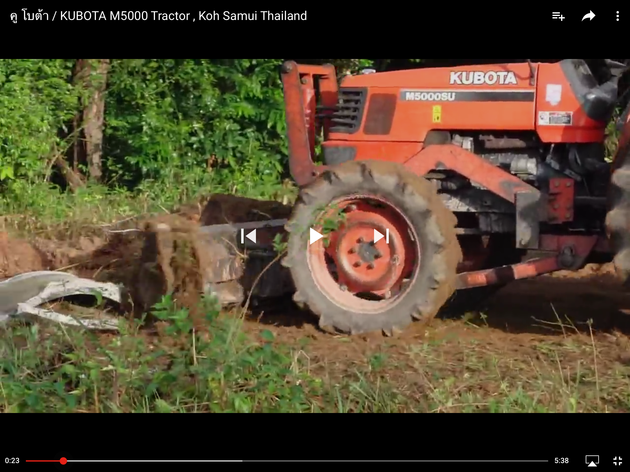

Hi All Thanks everybody for taking the time to reply.One of my inspirations for this project was this video youtu.be/USZf6pwY8_w you will have to add https:// to get around posting links for newbies like me
I however would only be pushing over some small brush ,the blade would be about 4 to 5 ft wide. I already have a 300 kilo 7 ft blade on the back which is great but I still end up having to push backwards with it. From some of your suggests I will brace it back to the drawbar or a similar strong point.Also try to design it to fail befor my kioti does. he is a photo of anothe exampleimage.png

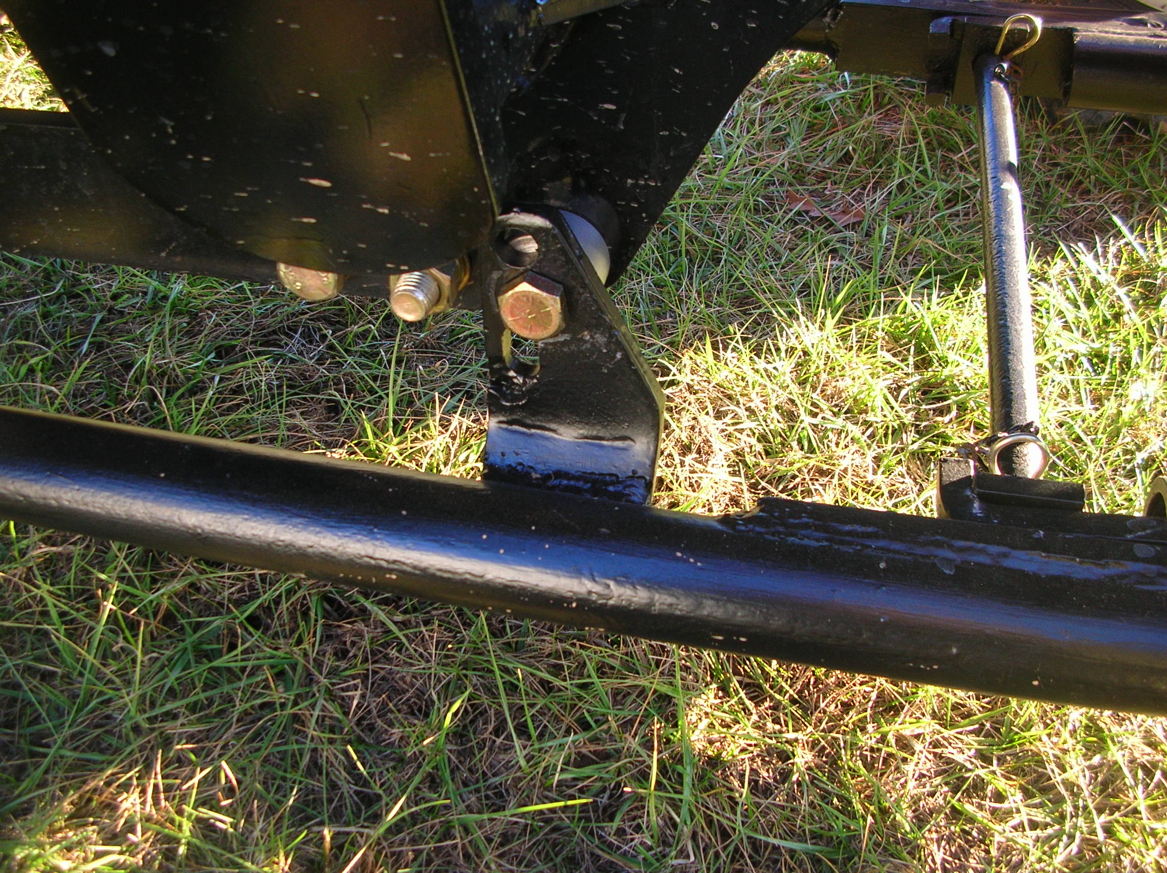

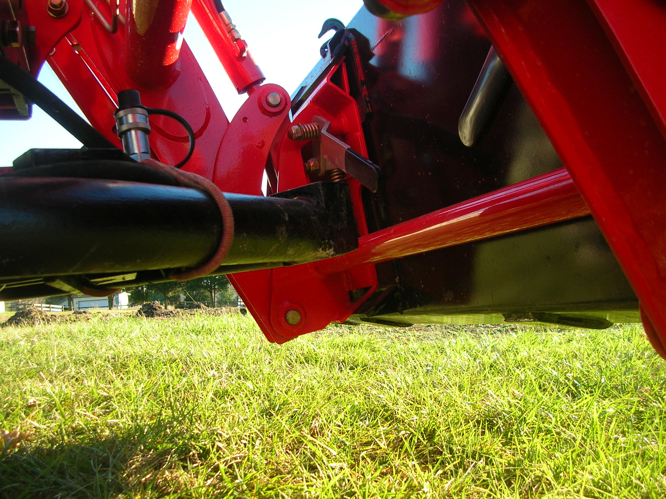

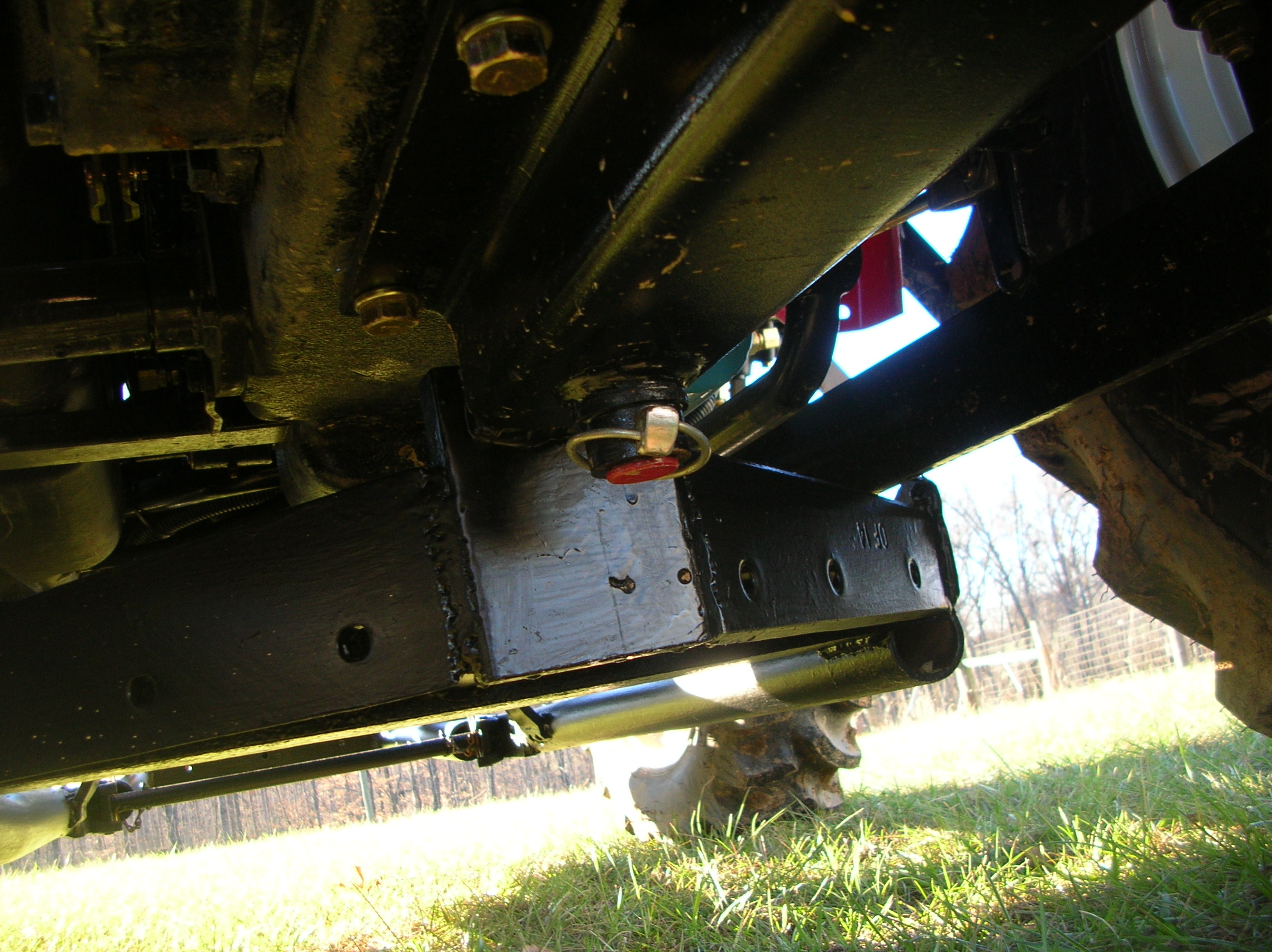

Here is how I mounted a modified front blade to my Branson 4520R. I push mainly from the rear drawbar mount and hang the frame from two holes on the front loader frame. The up/down cylinder mount is from the front cross frame. I have this on in the winter and am still able to mount the FEL when needed. Mounting is 2 bolts to the FEL frame and a pin in the rear drawbar. I had to add the boss and pin to the existing bracket.
   / Tractor bulldozer #16
Makr sure you have the lateral loads covered by a proper frame that extends to the rear axle. It is not uncommon to break a mfwd tractor right behind the bellhousing when theres no support frame.
