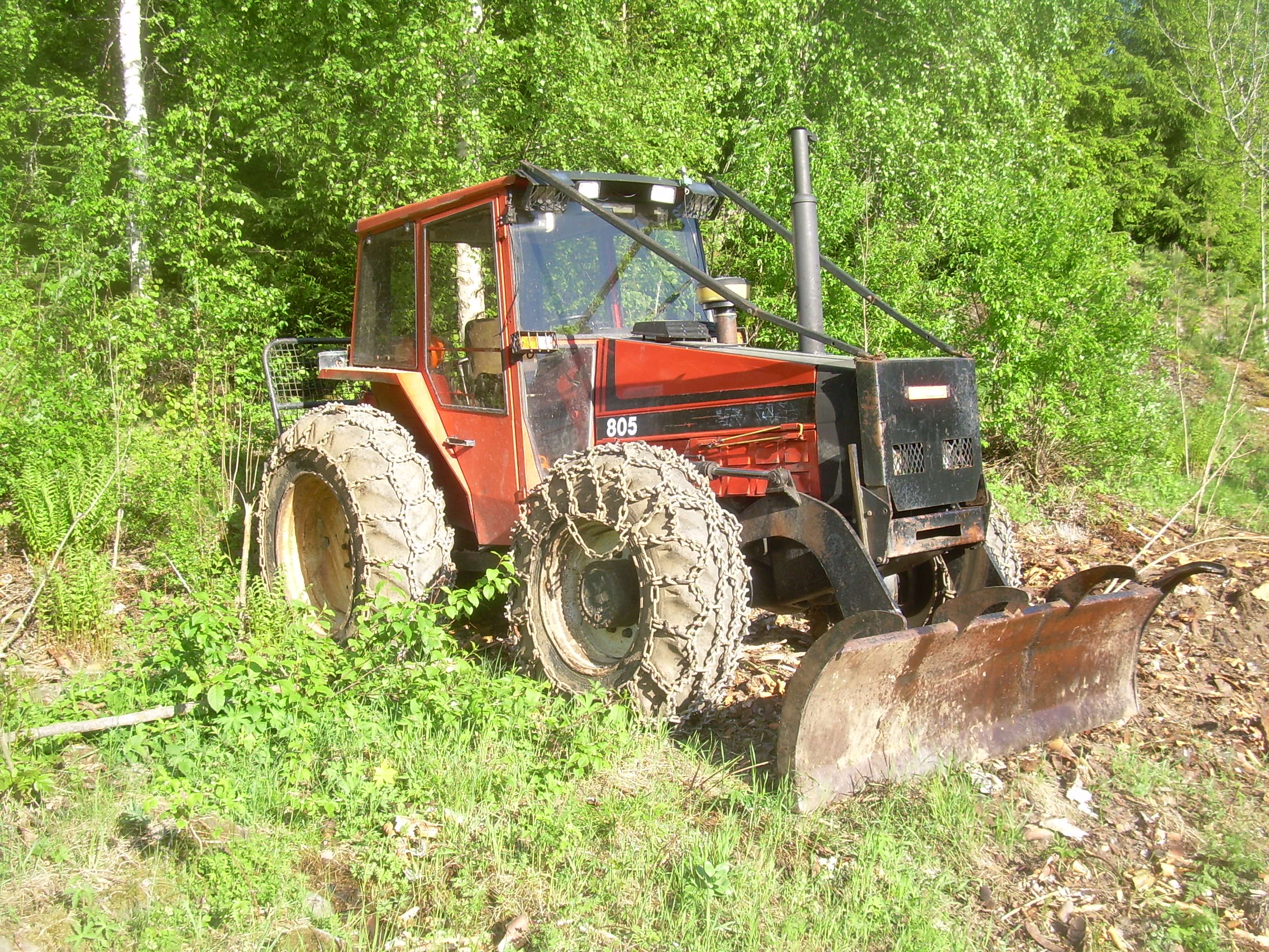

These blades are produced a half-hour drive from where I live, they are intended for forestry use but can easily be used for phushing dirt and some stumps. They cn be angeled to som extent in ether direction. They are attached to a subframe which extends from the rear axle to the front of the tractor. Built so you do not lose height under tractor
