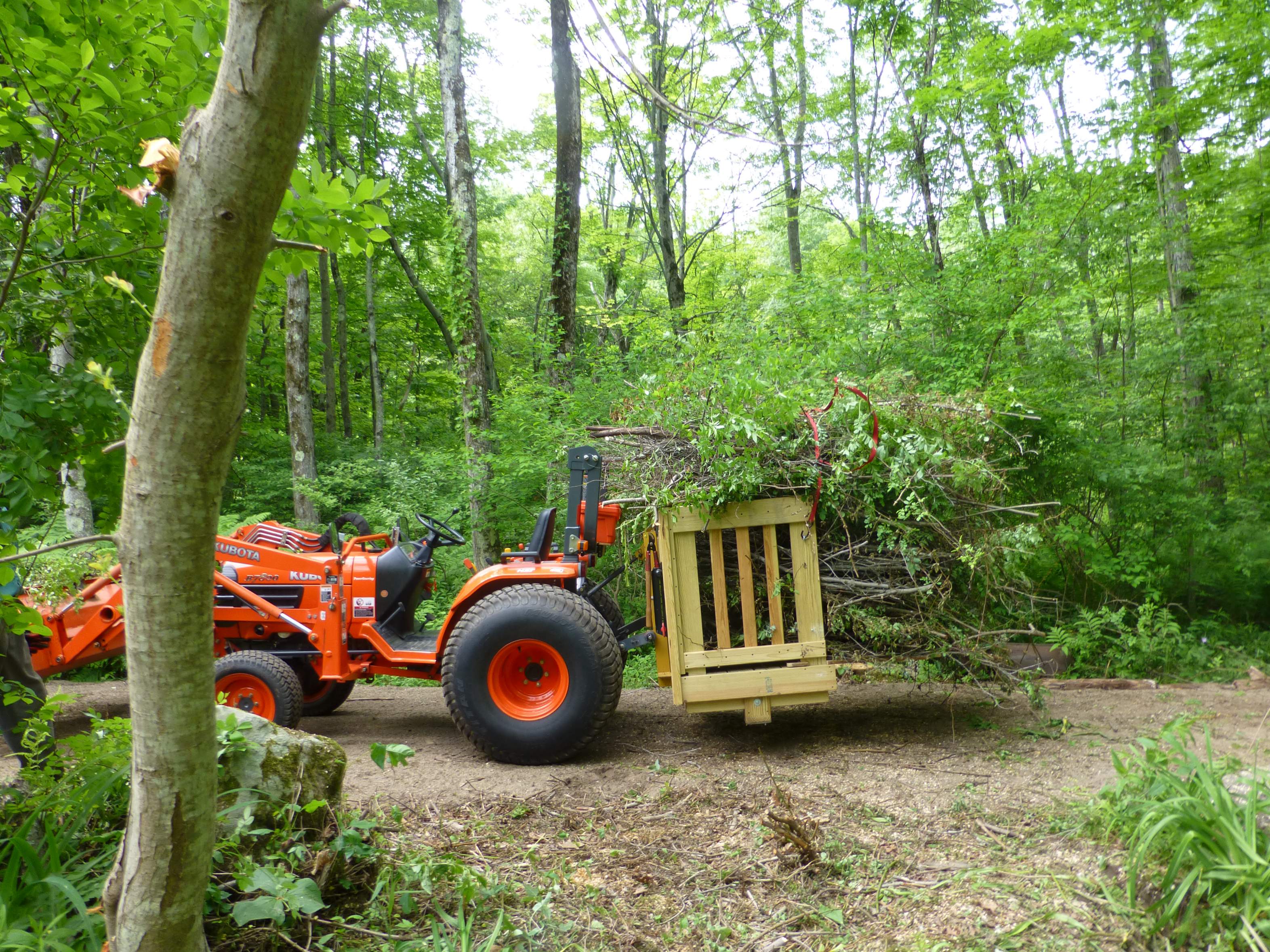

The hitch was purchased from Harbor Freight. It is a bumper mount design. They had 2...one small and a larger version. I went with the heavier, larger one. I looked on their website
and did not see it. I am sending a link to show you what they look like. The photo shows a smaller version available from another seller.
The upper mounting plate on mine is 13-14" wide. Hope this helps.

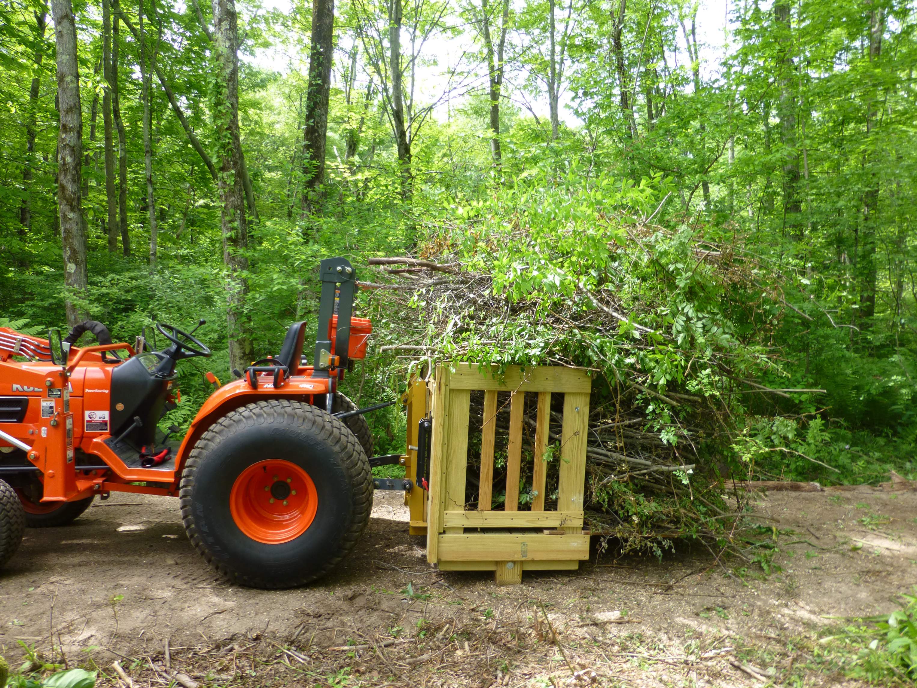

I will be posting additional photos of the carry all soon. I have added quick detach feet for use while mounted on tractor, and also a piece of plywood that extends the bed out 3" for carrying fire wood. Flip the plywood 180 degrees and it extends the bed further for brush hauling. Works great for brush-holds a lot!
Thanks for your compliment. We could not be happier with the results. Great ballast and utility.

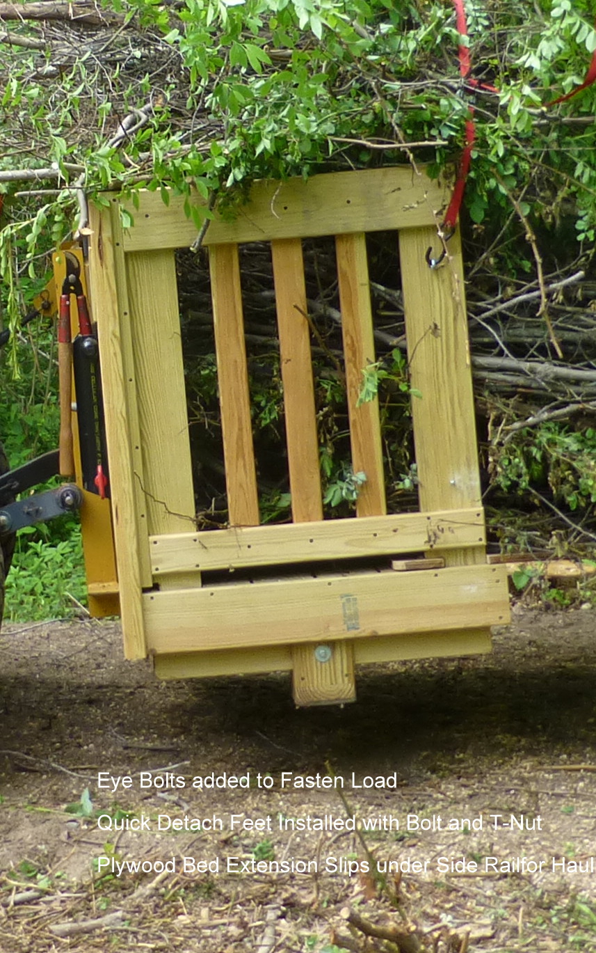

*Photos of recent additions to our Carry All.
Eye Bolts were added to upper rear corners of rails to secure loads.

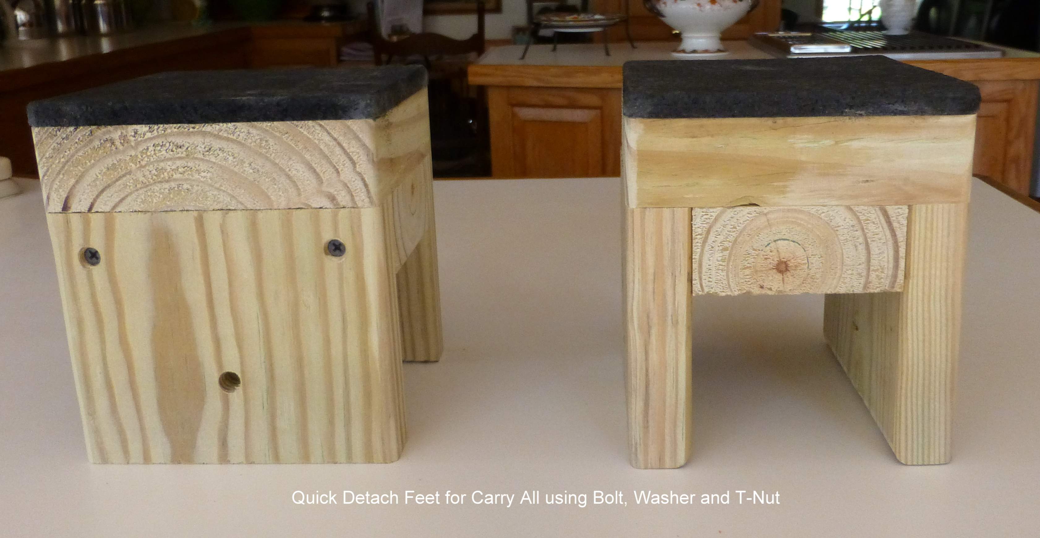

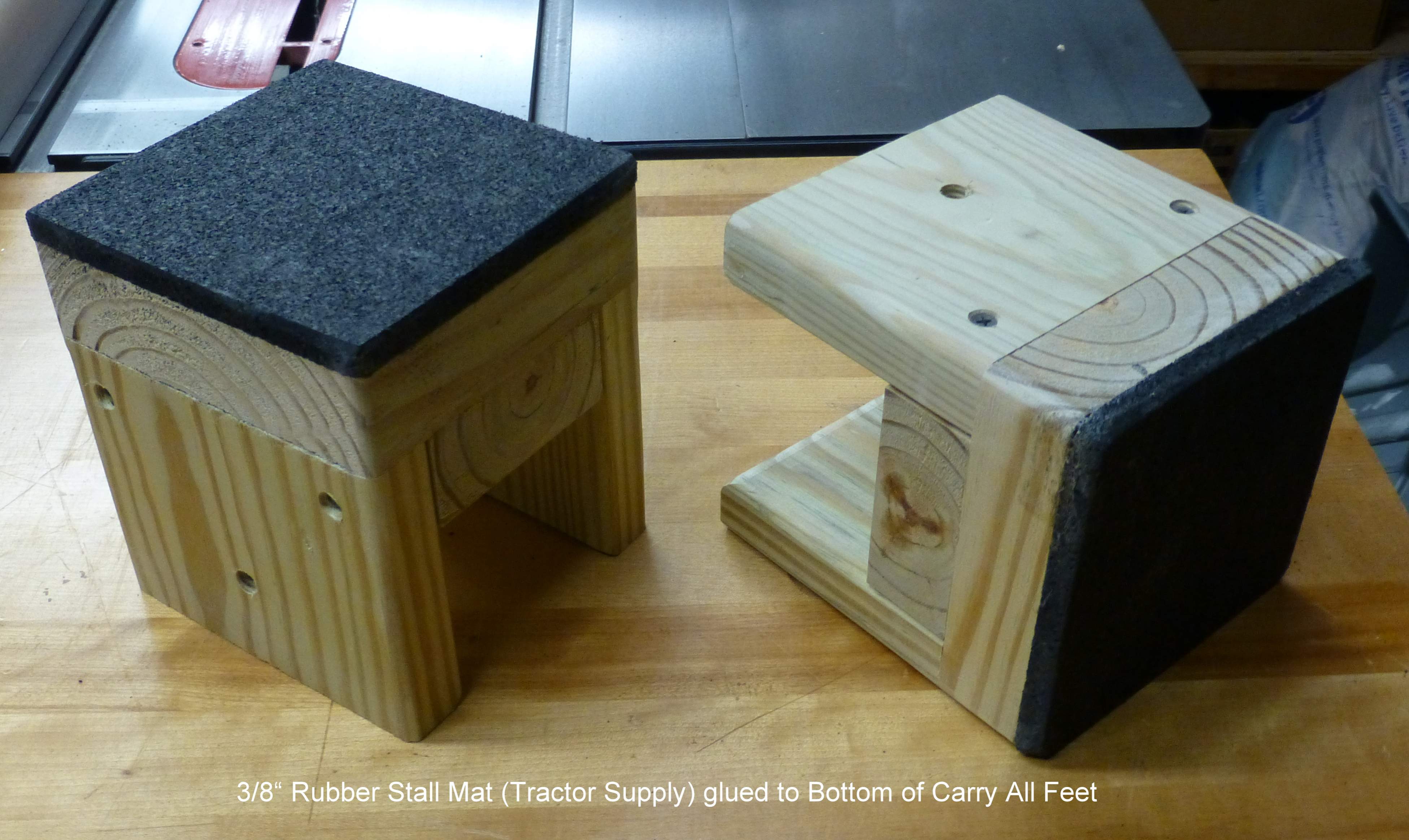

Quick Detach Feet are secured by one bolt, washer and permanently mounted T-Nut. These are left on
while carry all is attached and in use. When I detach the carry all I first remove the 2 feet, and then lower the carry all
onto the installed casters. The caster allow me to roll the carry all while dismounted.
Also, I recently cut 2 sets of notches in a piece of plywood.
One set of notches secures the plywood for hauling brush-long extension.
Shown mounted in brush hauling photo.
The second set of notches sets the plywood into a short overhang position which allows me to load and support 2 rows of firewood in the carry all.
I will take a photo of the notched plywood and how it is mounted soon.
I purposely designed the carry all at a specific distance from the 3 point hitch mounting pins.
The plywood assists on those occasions when extra cargo space is needed.
