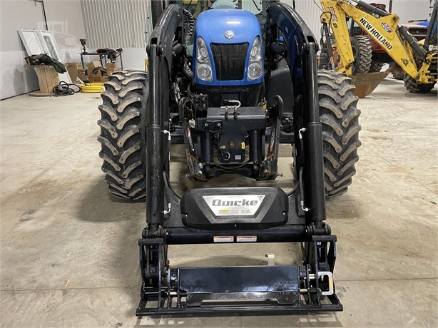

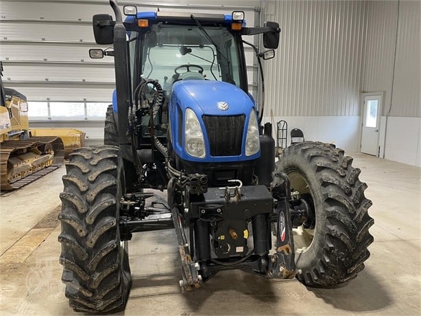

I might be buying this tractor, but I’m not crazy about it. Has front 3 point/PTO and a quicke loader.
