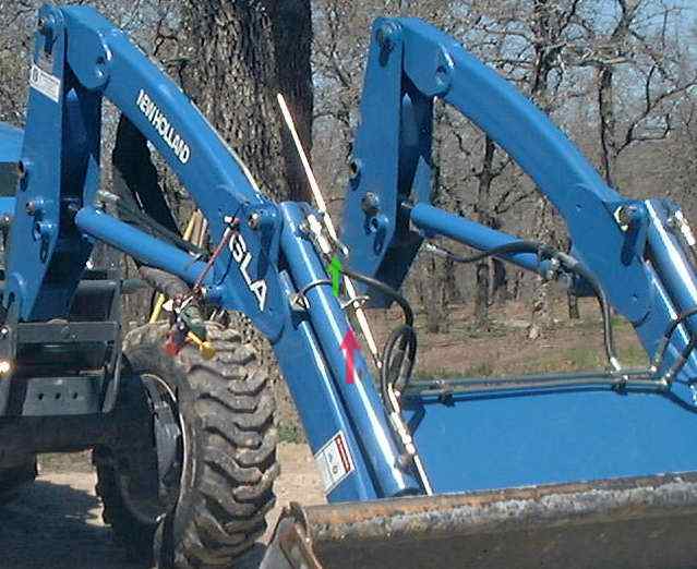

</font><font color="blue" class="small">( FEL's a dream to operate, although I guess nothing beats experience when it comes to knowing when the lip of your bucket is parallel with the ground....any tips other than learn by doin'?
)</font>
Choreboy, your loader has a rod along the right side lift arm that shows the postion of the bucket curl. The rod has a bend in it that is supposed to align with a clamp when the bucket is level to the ground. I've included an attachment showing these items. The red arrow points to the clamp and the green arrow points to the level bend in the rod. You can check the adjustment on level ground or in your driveway by lowering your loader and rolling the bucket until the notch perfectly aligns to the clamp. Get off the tractor and look at your bucket. If it's not level, loosen the clamp and adjust the indicator up or down on the hydraulic cylinder until it exactly matches level. /forums/images/graemlins/cool.gif

Good picture Jim. What graphic software are you using to tweak your pictures and add your dodads?
   / Tractor delivery today!! #13
I used ACDSee to crop and size the photo and then when I wanted to add arrows, I opened it in Corel Photo-Paint and used their shaped brush to drop in some arrows with 50% transparency and the two colors. It's quick and dirty, but it gets the job done. /forums/images/graemlins/smile.gif

Thanx byax, ah the blessings of experience...... few more hours in the seat, quite a few hours staring at the yet to arrive manuals and my fluffy questions may grow less frequent..... Will check out the leveling rod before I do any more plowing!!! /forums/images/graemlins/grin.gif /forums/images/graemlins/grin.gif
