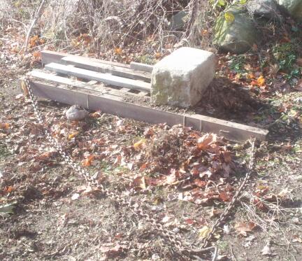

I forgot to take a pic while I was using it, so you can't see the hardened cutting edge on the bottom edge of the leading 18"-20" of the front blade. It is welded on about 1/2" below the bottom of the front blade. That cutting edge goes on the ditch side of the road and scrapes up a little dirt. The dirt flows to the middle of the road, but without a hard cutting edge on the rest of the blade, the dirt goes under the blade and is pushed into the road surface.

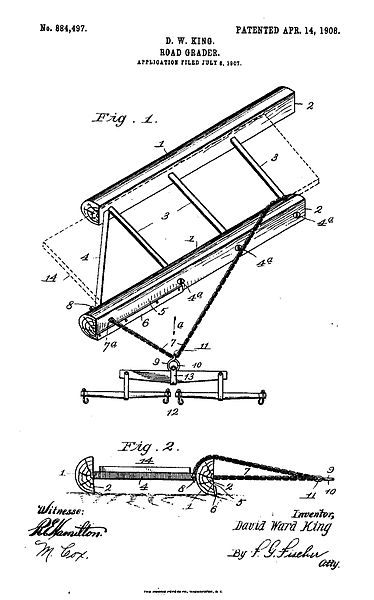

That's almost an exact copy of the King Road Drag.
King road drag - Wikipedia, the free encyclopedia
