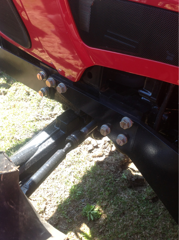

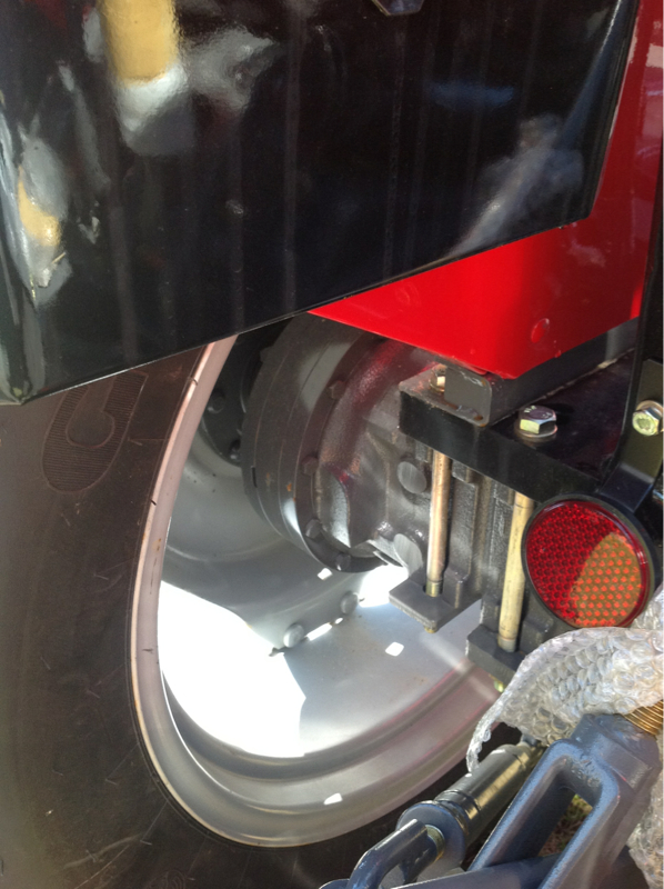

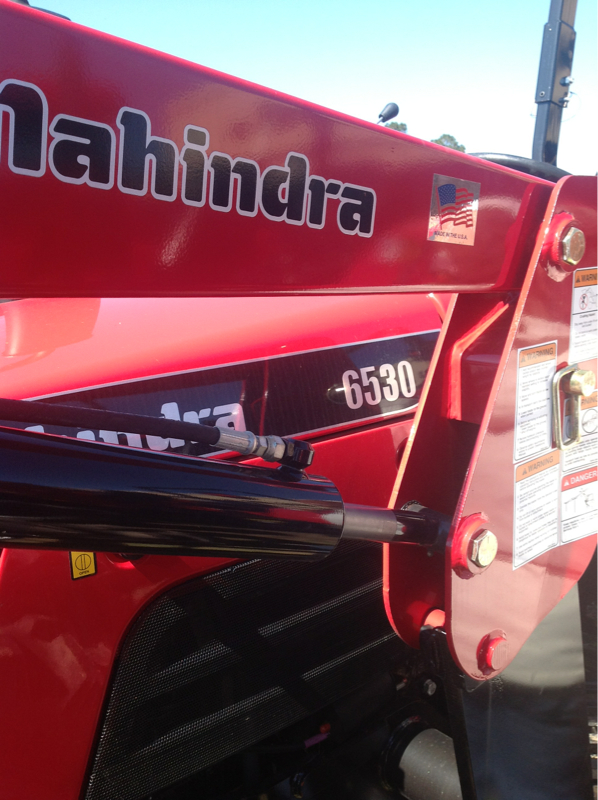

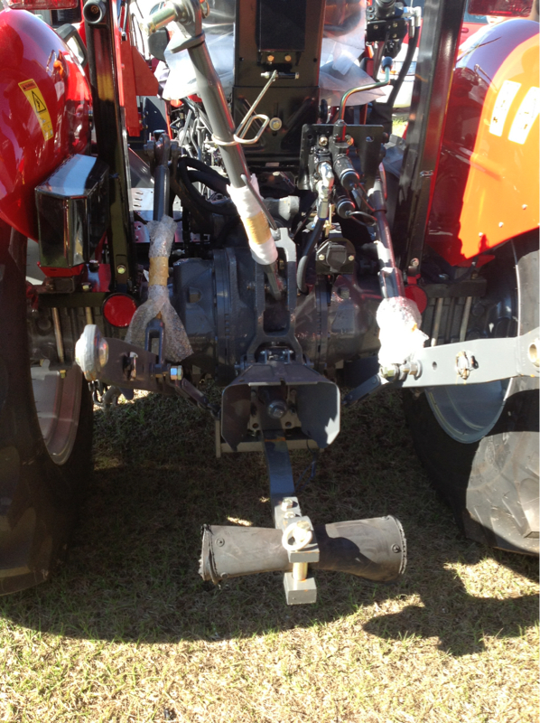

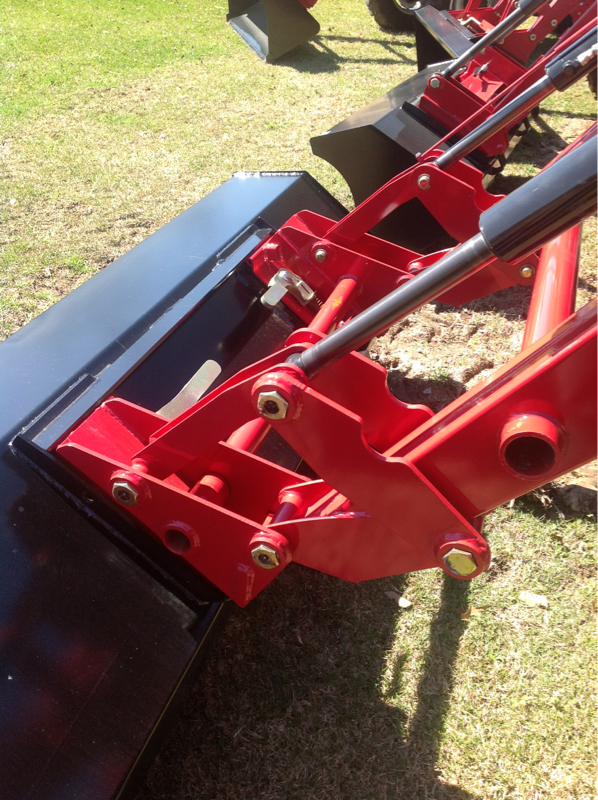

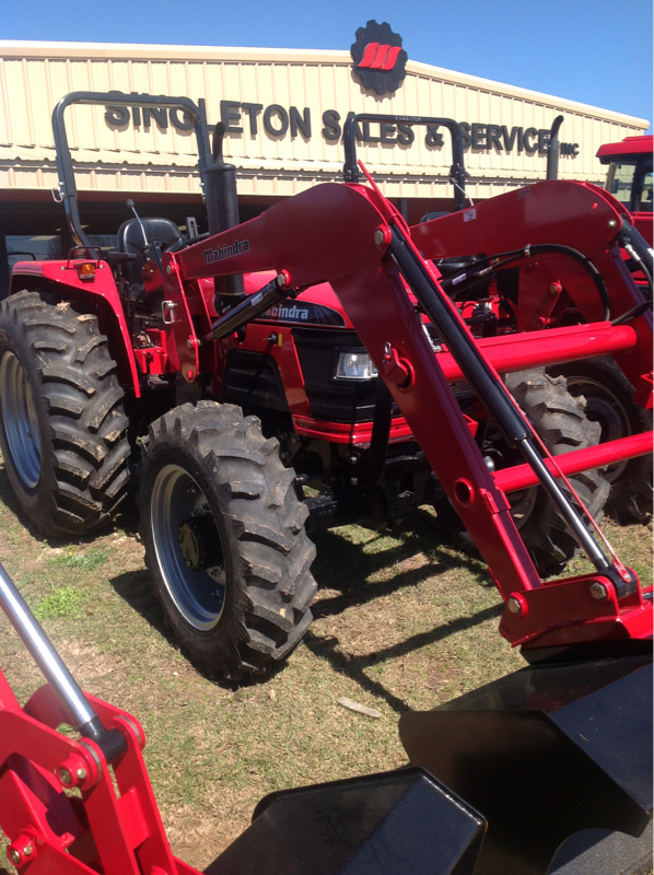

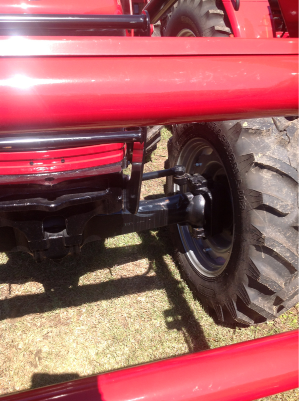

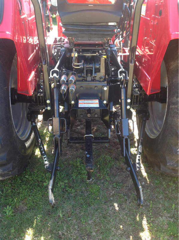

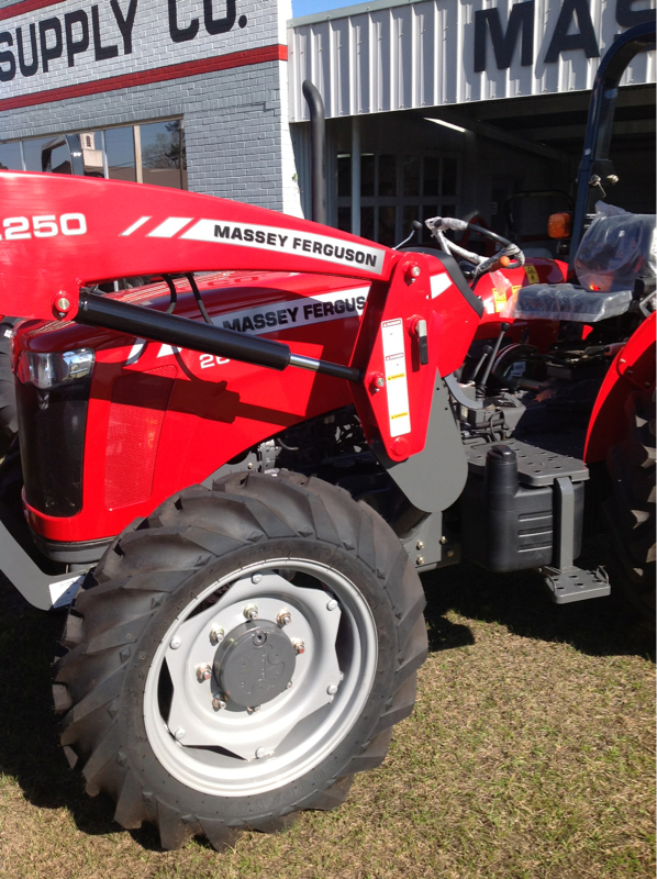

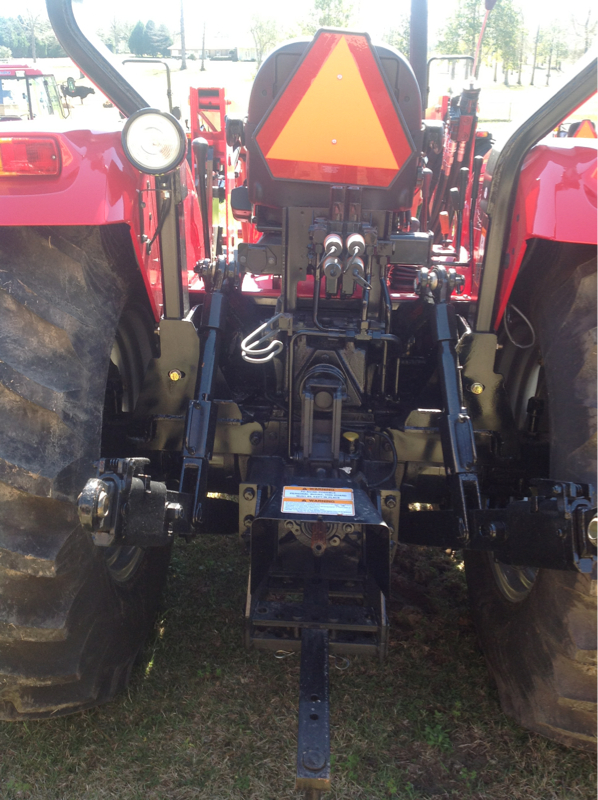

Today, i looked at the Massey Ferguson 2635,mahindra 6530 and mahindra 8560.
Here are a few pics.

The massy ferguson dealer quoted me 32,453. That included a skid steer type fel instead of what was on it, and 2nd hydraulic remote, filling the tires with fluid and delivery. It's a 74 hp,62 hp pto. The only two dislikes I had on this tractor were the clearance on the back end and the placing of the gears shifters, they could have made the handles longer, I had to bend and reach to shift it. It has independent pto and a 8f x 8r synchro shuttle transmission.
I won't say much on the 6530. He quoted me 28430.00 on it. It has two remotes on back also. I didn't dislike this tractor but I figured for 4,000 more I could get the 8560.
6530 is a 65hp I think a 53 pto. 8fx 8r synchro shuttle.
The 8560 was quote at 32,700.00. 2 remotes. It has 83hp 70pto. This thing was a big boy it weighs in around 7000 lbs. I really had nothing that I disliked about this tractor. I just don't know about the quality of mahindra products. I know a couple ppl that has them and th oth love em. They ont use their's like I'll be using mine though. Ppl seem to always have a company they like to talk down on and some choose mahindra. I've heard the pto are light wight on Hesse tractors and they won't hold up if you use them bailing hay. I don't have but maybe 20 acres to bail so it won't spend that much mid pulling a bailer. We also have the 2510 we use or that also.
The transmission was 12fx 12R synchro shuttle. It was the smoothest shifting of the tractors I was on today.
