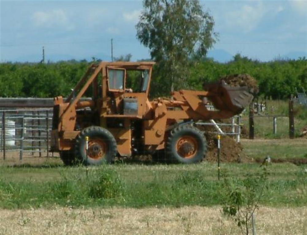

To SAFELY handle 3000 lb loads, I'd look for a pre-owned wheel loader.
Here's a photo of my neighbor's Allis Chalmers 545 loader.
You can find something like this used quite a bit less expensive than a 100 hp tractor.
Good luck
