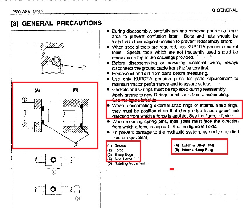

Do you know that circlips (spring clips) both internal and external need to be installed in one direction?
Installed the wrong way and there is a good chance they will come off.
This issue is so important all Kubota manuals include this info.
