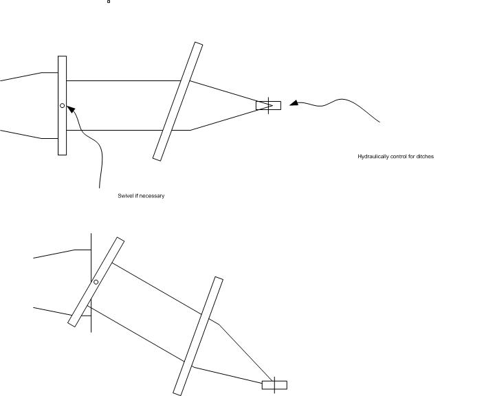

Does anyone know a better construction to build a tractor drawn grader, that goes inbetween the standard 3pt grader and the motorgrader ? i want the functionality (tilt, swing and offset) but not the cost of slew rings and many pivots.
I have made some sketches, but i'm not sure how to attach the blade to the frame, and where the offset pivot must go: on the headstock, or should i mount the blade on a separate offset arm ?
The blade is 3 meter wide, 45cm (18") high. I have 5 inch round tubes to use for the frame.

What about using a floating "A" frame with the point attached to a ball hitch (like a trailer hitch) near your 3pt) and the center pivot pin attached to a cross bar between the legs of the "A". (A center pin is necessary if you do not want a ring) The individual lift cylinders could attach to the legs of the "A" and rotating cylinder could attach to the "A" frame. To get your offset the easiest way will probably be to slide the blade, like flail mowers that have the sliding hitch arrangement. That would give you all the movement you are asking for. Well it would be difficult to get the blade swing and offset of a real grader without going to the ring, but it would get most of the action that you would need.
You might need to raise the bridge frame a bit to give yourself a bit more room for maneuvering the blade. That center pin and the attachment for the pivot will have to be very healthy to stand the torque of working with a corner of the blade.

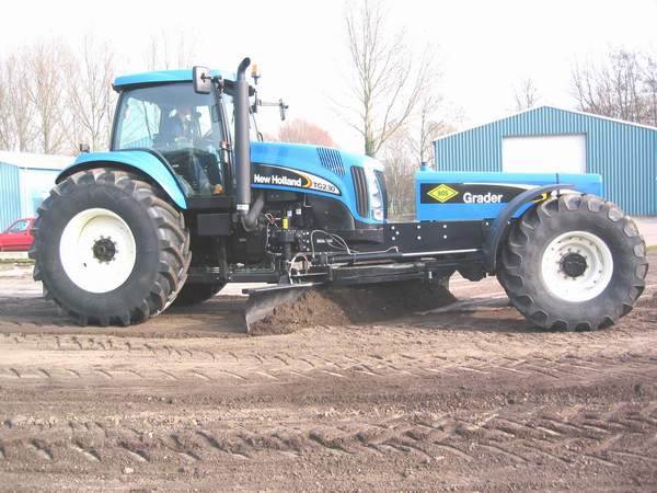

That aint no good... a 5245 mfwd with loader, brings in at about 4 metric tons, and will warp it like a soda can..

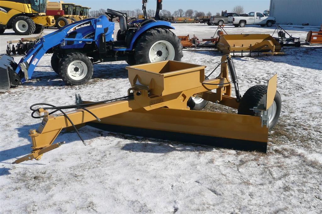

I sure need the heavier variety: #1 Double B Repair Pull-Type Road Grader
I also want it 3pt hitch mounted, so it can push itself off the tractor and use its full weight to pull a ditch. A drawn grader needs a fair amount of weight to remain on the tires to prevent being pushed aside by its blade.
One thing i'm missing on this one, is the tilt feature....
I am also thinking in that direction.. i have an old lower link arm with Cat 2 hitch balls. I think that will do the job, because the biggest forces are applied when the ball is not in motion..
About the A frame with 2 legs, i think i would simply replace one leg with a hydraulic cylinder to get my rotation.
Another important design feature i want, is that the cutting depth must remain the same during side shifting on the move: I need this to pull the first ploughing furrow back from under the fence after re seeding a pasture. We use posts every 4 meter, which is a lot of movement.
My brother has just taken a contract on a major park landscaping job, and he can use it for the cost of building it, so we both end up cheap ;) In the park are a lot of trees to manuever around, where the same thing counts: the depth must remain the same during side swing.

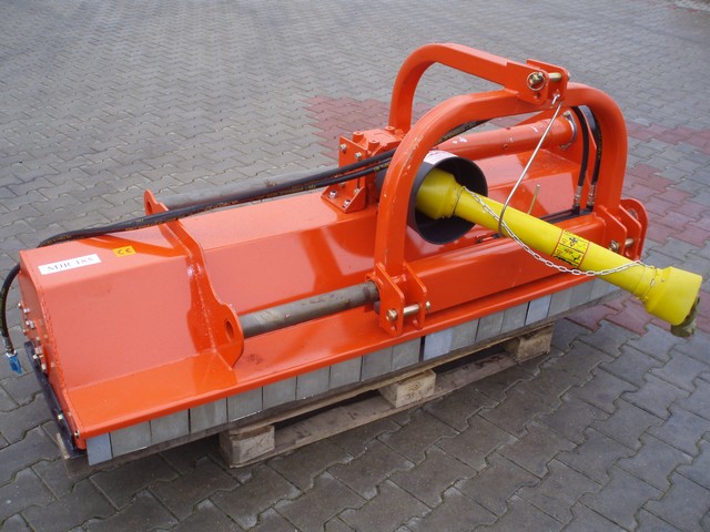

Do you have a good example of a poor man's sliding blade ? I am afraid of the dirt getting into it, but i do like it for aforementioned reasons.
Thats why i want a simple construction... A turret that can take this abuse, will get too expensive...

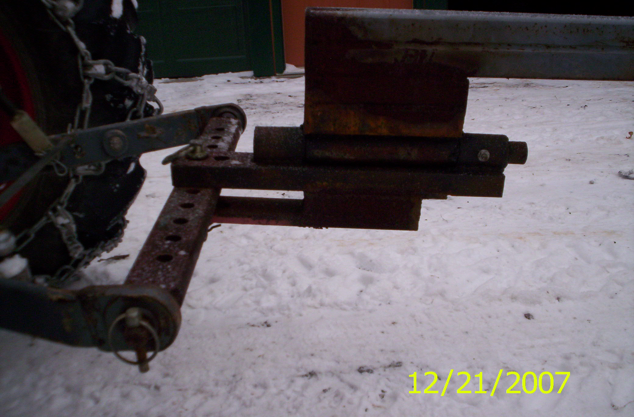

you can still get an off set by useing a three point set up like i have. with a seven foot blade that is wider than the tractor and using a three point hitch draw bar when i need to off set i hook the hitch to the outer most hole. this lets the grader run a few feet out side my track.

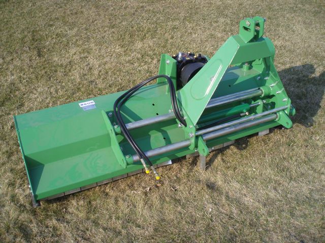

Cat puts a hyd cylinder there in their big graders for the side shift. Dirt does build up in there, but I do not recall ever seeing one leaking or needing to rebuild a cylinder.
I could not find a pic in a hurry, but I will post a couple of pics of Flail slides that I believe could be adapted behind a blade. Basically 2 parallel shafts and a hyd cylinder to slide the blade along those shafts.

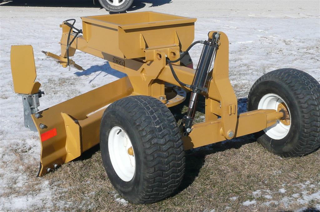

Here is another idea for a grader in the pull type. Definitely heavy duty.:cool: Orrr? Maybe you just want to modify your tractor thusly. :D

I doubt if the mechanism of the flail mowers with the two sliding pipes is heavy duty enough...

...But maybe the sliding design of two pipes isnt as bad as it looks, in a heavy duty execution.. We might have some piston rods and hardened bushes of an 18 ton loader at work.. Chromed 3" piston rods and hardened grenade motif bearings should take a lot of abuse...
:confused: Maybe I posted the wrong link, the grader I was mentioning is rated for up to 150 hp, the 5245 mfwd is 50 hp isn't it? Nevertheless I'm speaking about the design of the double B grader. I too have had the privledge of "running the wheels" on the old pull type graders, perfect machine for camp roads and such. Pulled it with a 1958 MF TO-35. :D
