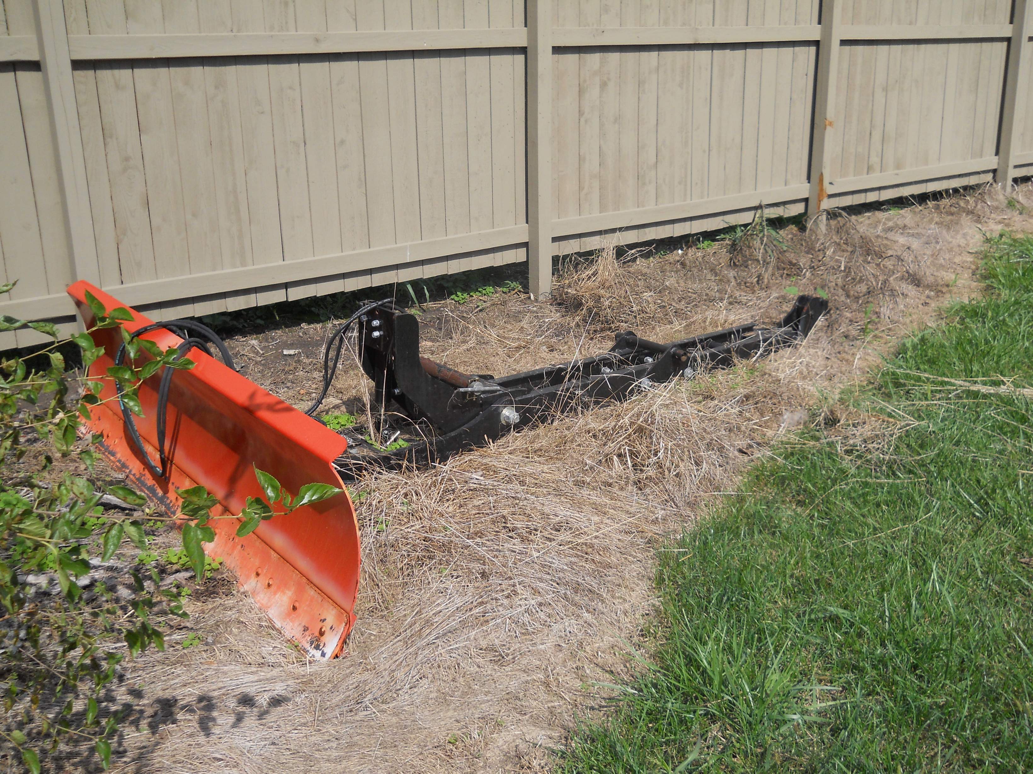

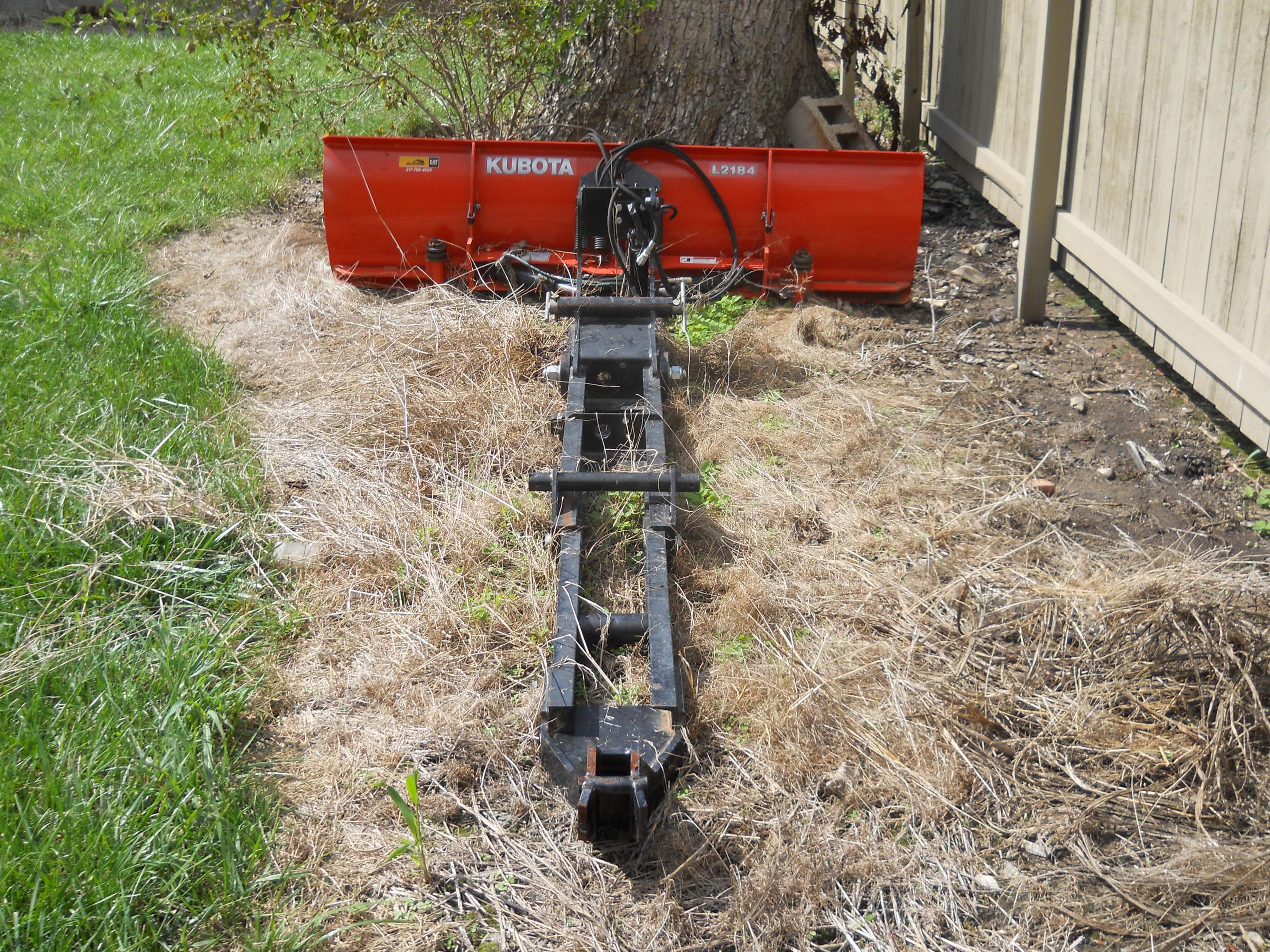

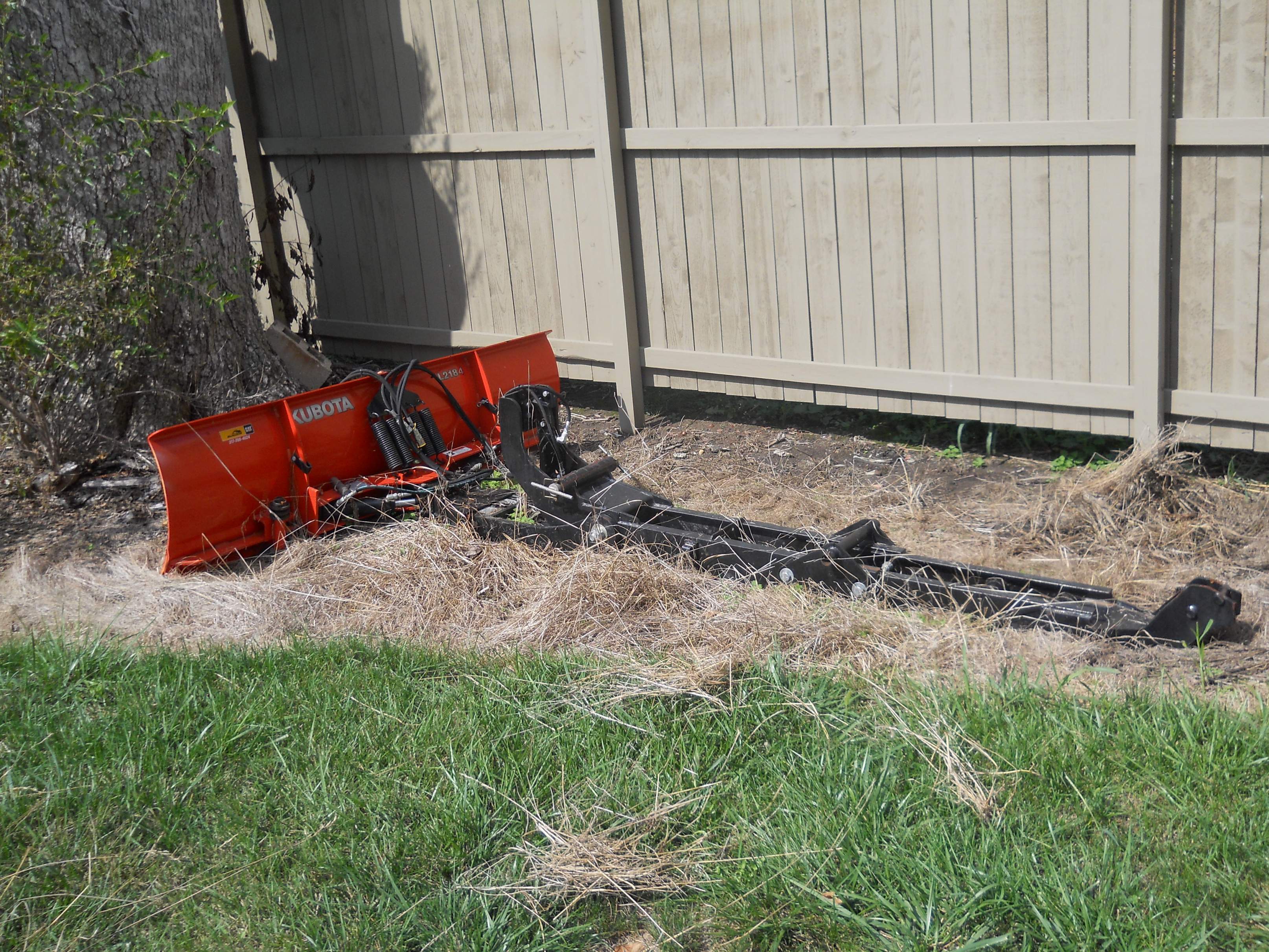

My GrandL3940 has the subframe for the blade/blower/broom option. I have the blade. I keep it stored outdoors in the offseason months. 1st time hook up in the fall, 30 minutes max, but I usually leave it on all winter after that. If I have to take off during winter and put on FEL, then I will take subgrame off in barn on concrete floor, which takes about 15 minutes to re-install. Not that big of a deal, but does take a little longer if sitting in the dirt for 8 months. Philip.
