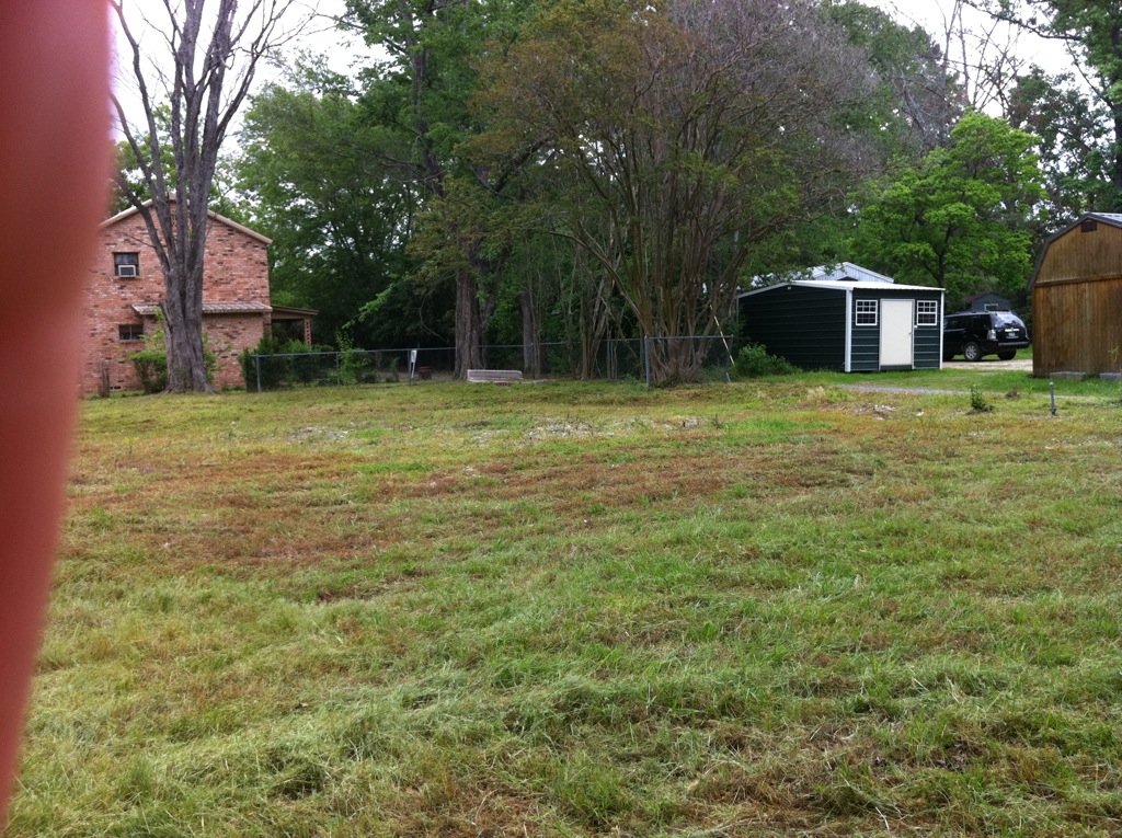

I want a compact tractor to do a variety of things. I have rental property. Houses in the city and several small mobile home parks. I have a zero turn for mowing but...
I dig up utility lines quite a bit. For example, 2 projects waiting on my decision...need to run 2 new lines in 2 separate locations. Both sewer. Both down to about 6'. Also have a 6 acre lot and a 3 acre lot that need to be bush hogged. We could use forks to move things often...rolls of carpet, appliances, etc. I remove small dead trees, top, trim up quite a bit. So far I have hired out the big tree jobs. Spent 5k last year on that and would like to cut that expense down :). I have tree climbing gear and cut out dead limbs that I can cut up and move by hand:mad:. Would like to take on whole trees...cut in pieces and move by tractor.
***Need to bush hog, trench for utility lines, maintain gravel parking lot, move heavy items, haul off small trees/logs, and much more. Hopefully for the next several decades. I like to buy right and hold on!***

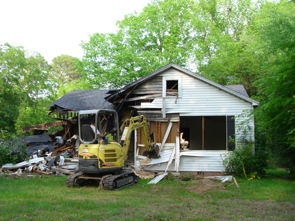

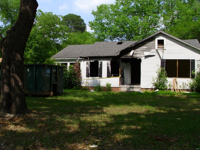

I have rented skid steers and mini ex's before. Had a fire at one house that was a total loss and tore down. Was a 1500 sq ft house and did that with a yanmar mini ex. Yes...not the best tool for the job but couldn't rent a track ho. Was fun but frustrating at same time. Also had a mobile home totaled by a tenant that ran through it coming home wasted. Knocked it off it's blocks. Hired that tear down out. Guy took apart by hand, scrapped what could and I hauled off rest.

Not sure how a tractor would have helped the teardown but i'm going to tell the wife it would have saved us enough to buy a new wardrobe :).
