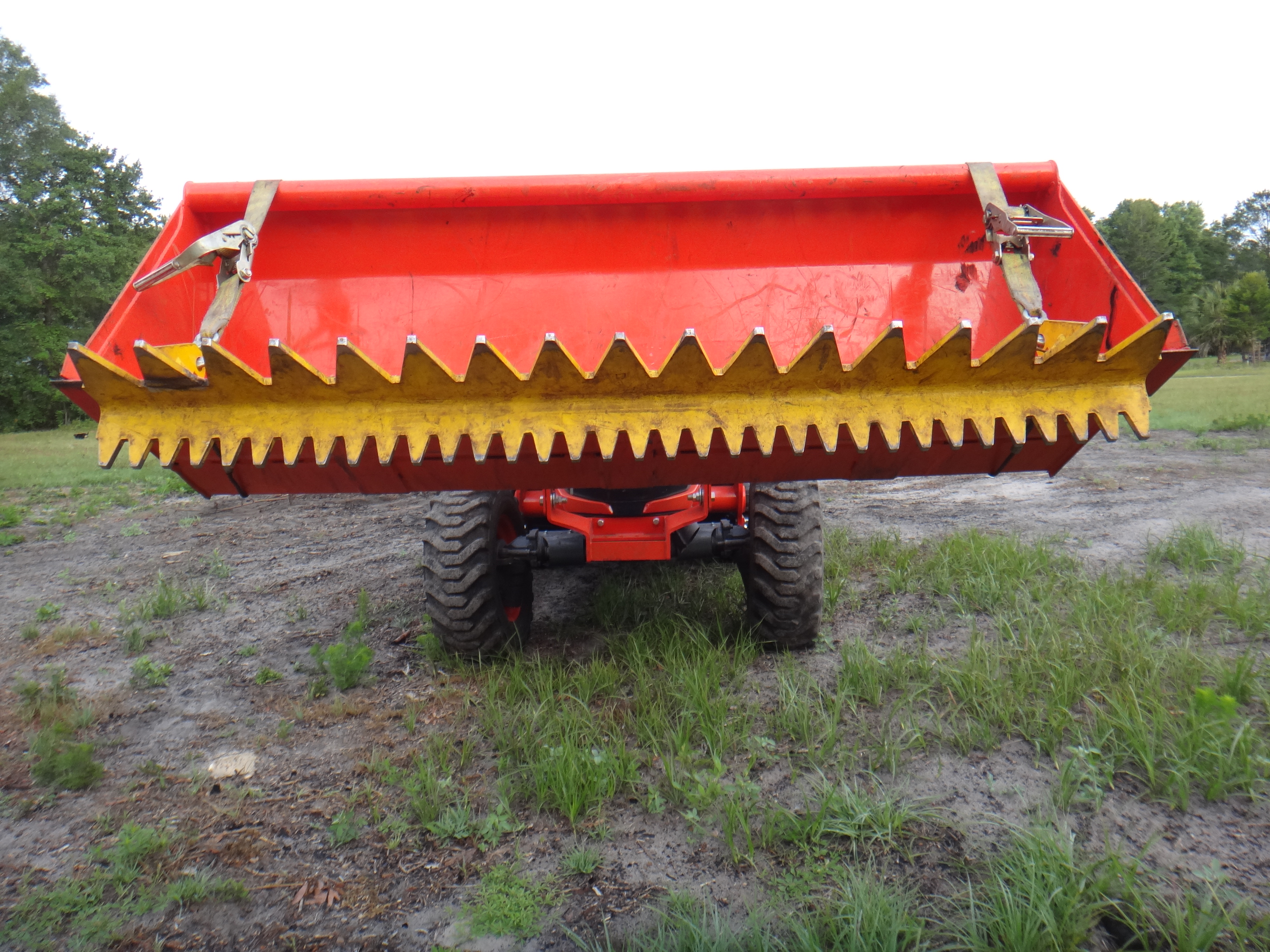

A Ratchet Rake bucket attachment is most useful for woods work and light grading.
VIDEO: ratchet rake brush clearing - YouTube
RR WEB SITE: Ratchet Rake, LLC - Tractor attachment, Bucket attachment, Loader, Skid loader, Kubota, Skid steer, Landscape rake, Brush remover, York Rake, Harley Rake, Rock Rake, Tractor rake attachment, Construction attachment, New Holland, Bobcat, Fire safety, Home fire safety, Fire prevention, John Deere, skid steer attachment, tractor implement

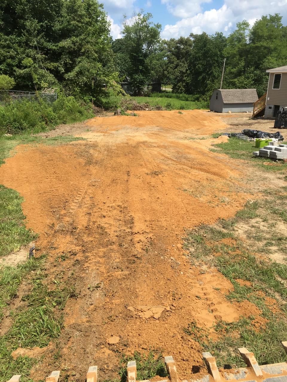

I wonder if a skid steer would be better?
Almost certainly if you can live with the ground disturbance they cause. That’s my number 1 complaint with mine. #2 is increased difficulty getting out especially if you need to leave the loader arms part way up.

....trying to reclaim woods to pasture......I want to be able to drive over lawns too without much damage
These two goals may be somewhat incompatible, depending on what you consider "lawn" and what your "woods" consists of. Big trees? little saplings?
As for a skid-steer, after it's done working, another tractor will need to come in to repair all the damage done to the ground. :)
   / Tractor HP #17
I can finish grade with a skid steer. Here’s 2 jobs I did with mine. You just have to work toward the back end and don’t make any turns on the finish area. You’re right that a skid steer wreaks the ground, but wrong that you need a tractor to fix it.
