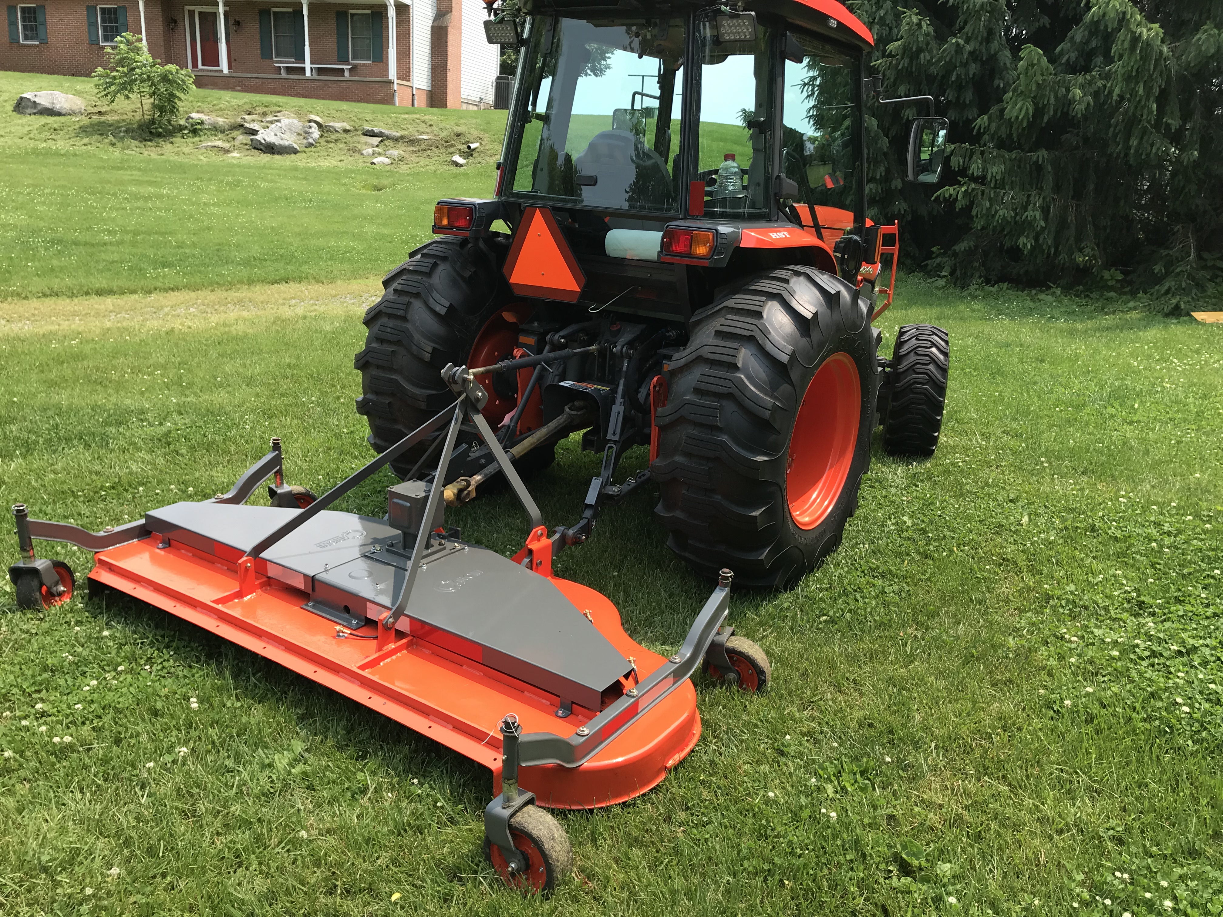

Wouldn't be without a loader. First tractor had MMM, next 4 all had RFM's. Tried a couple ZTR's and disliked them. Haven't needed a backhoe for anything except the one day when I buried the pipes off my rain spouts using a subsoiler and shovel. I'm not a backhoe hater, just never needed one.
Here's my favorite mower so far. I can trim whatever this doesn't get with one 5AH battery in the DeWalt string trimmer except for the 4 or 5 times I whack the creek banks each Summer. Don't mind spending under an hour and a half in the A/C away from the bugs, dust and pollen to cut our 3.5 acres.
