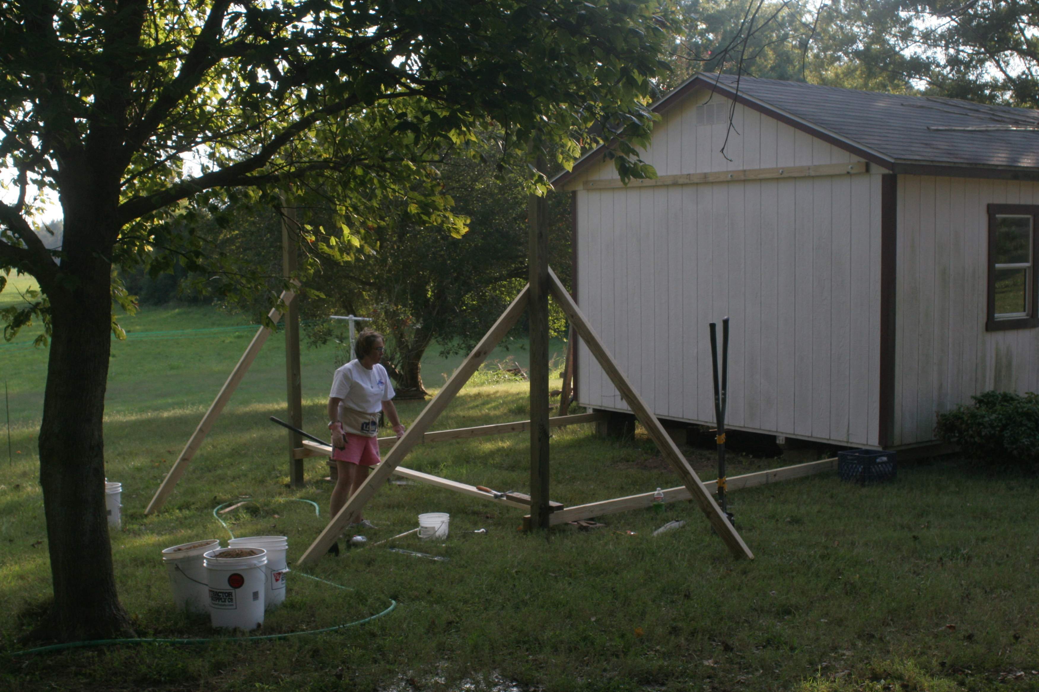

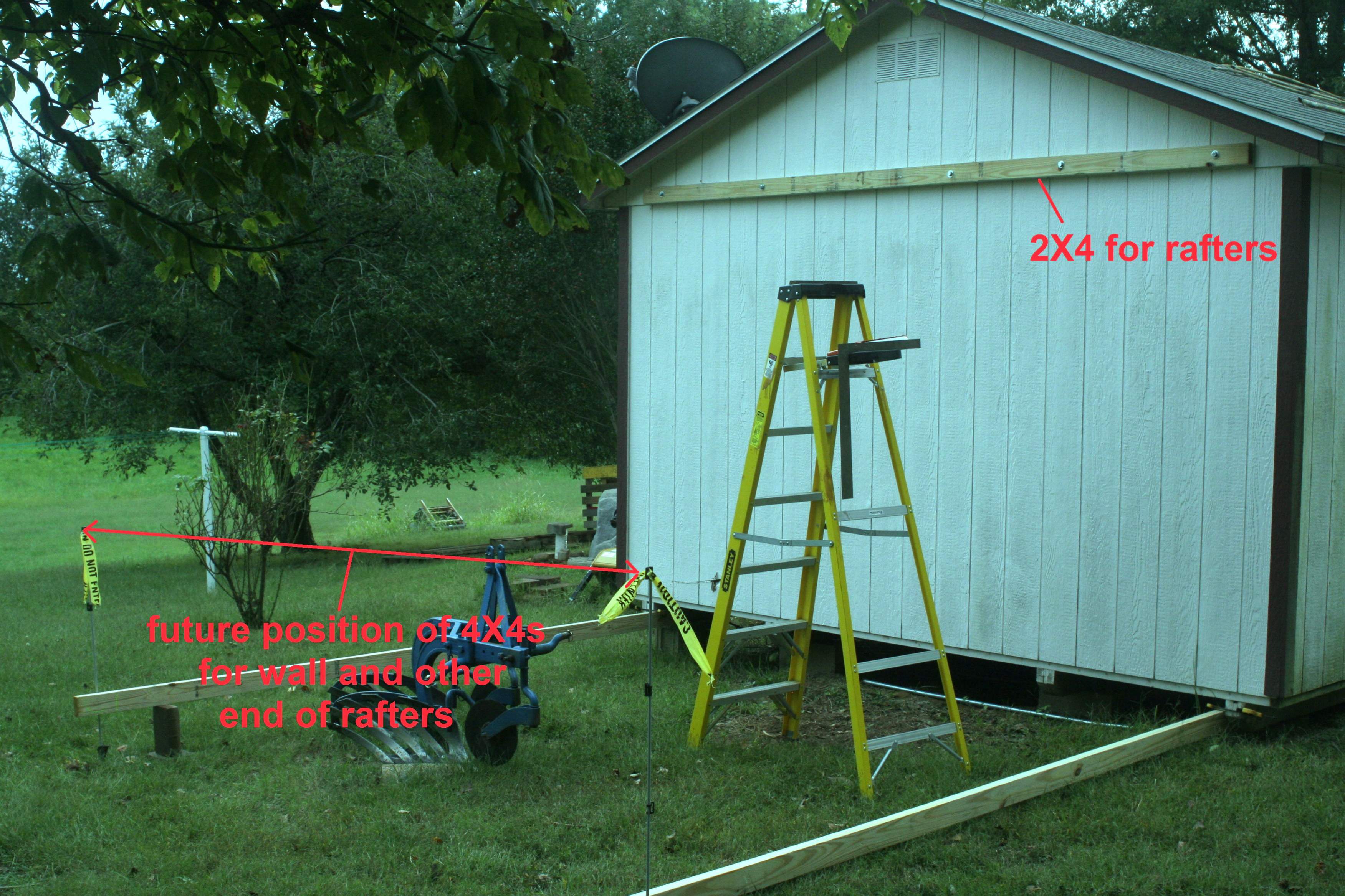

I guess some real pictures are in order. The pictures are titled day 1-4, but I didn't build this in four straight days. I had to take two days off after digging the post holes and setting the posts to let my hands recover. With the help of my sweet wife it took a week and without her I'd still be building.
Before

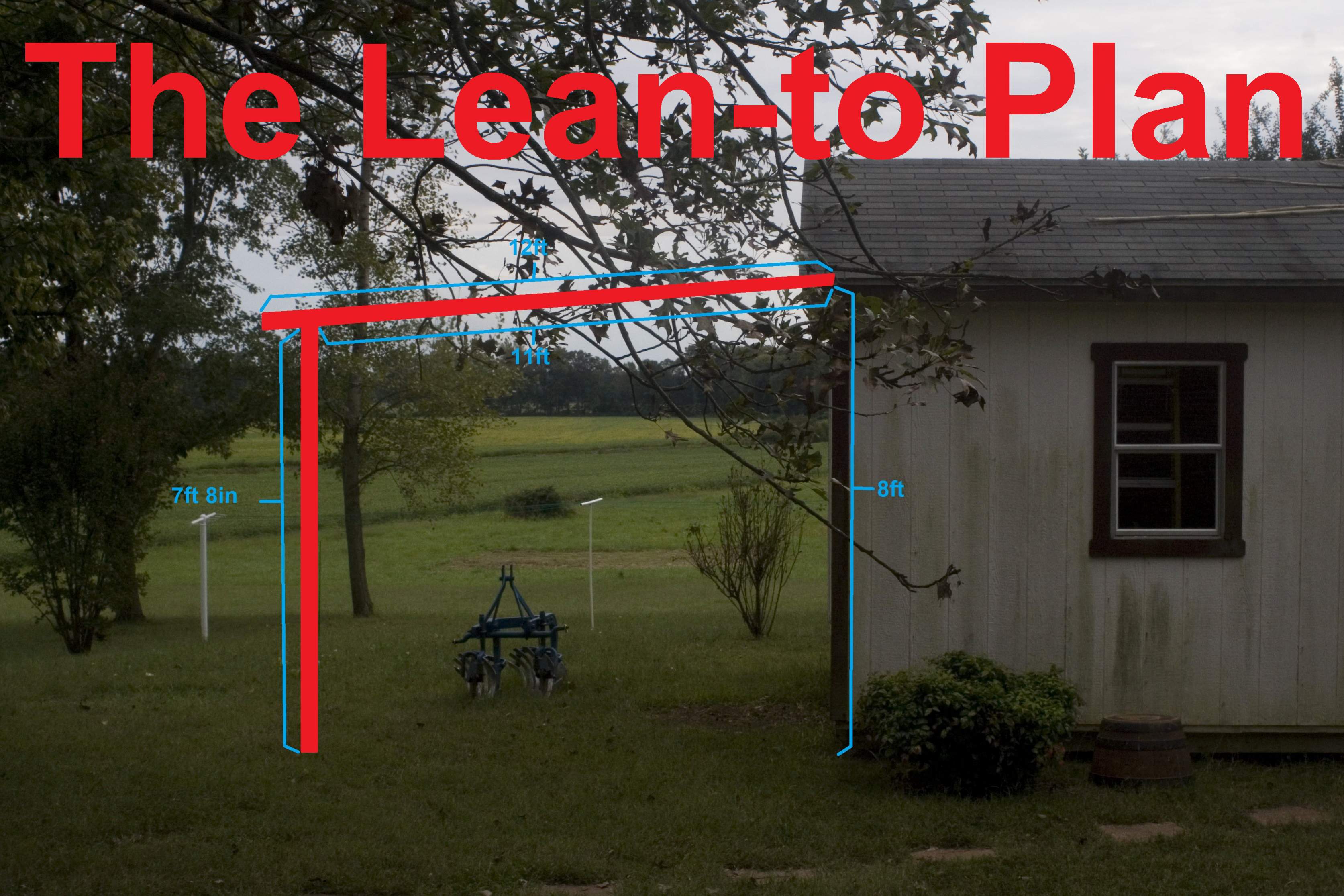

The Plan
Laying it out

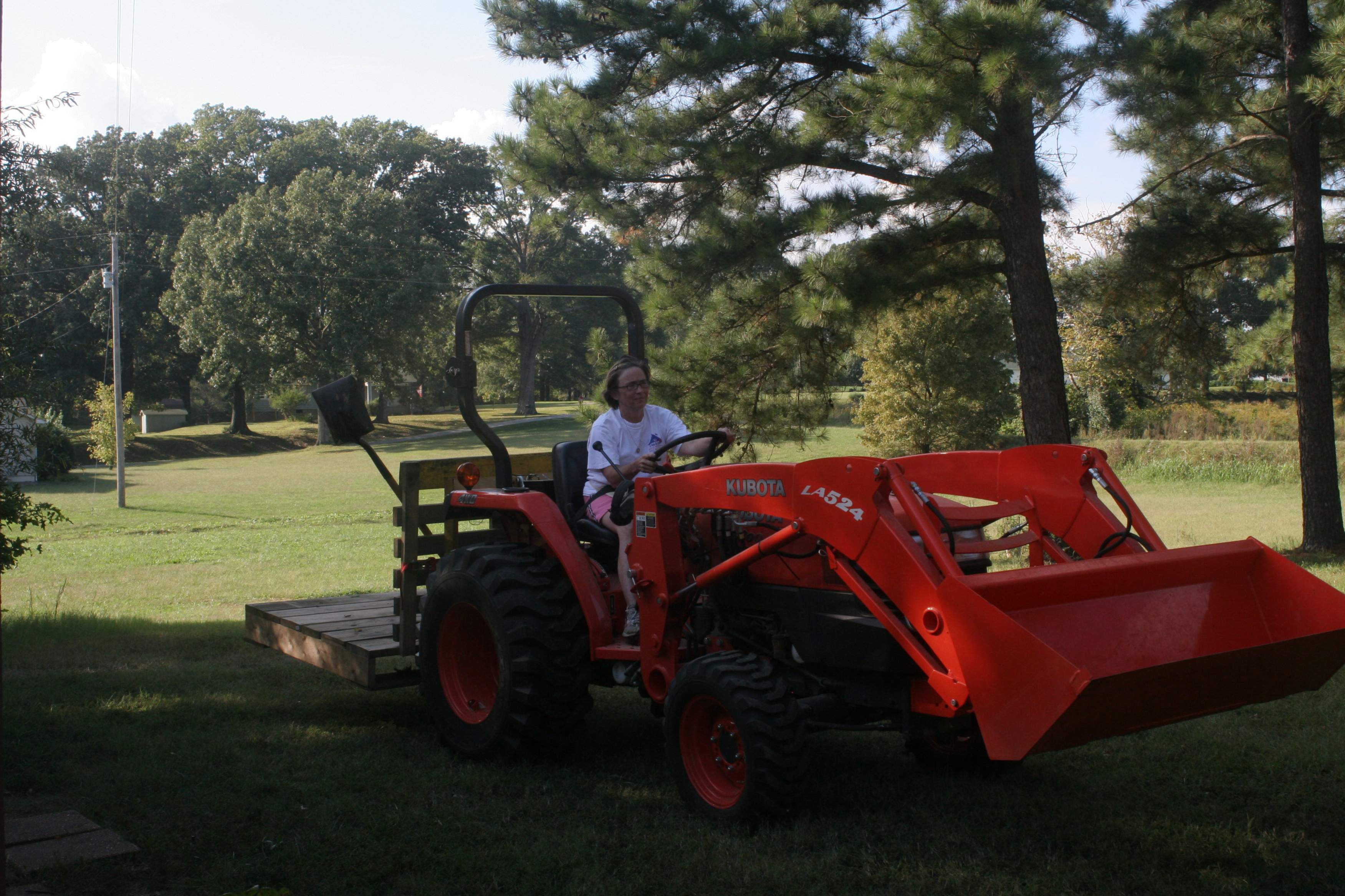

Wife moving the tractor
Posts set and waiting for concrete to cure

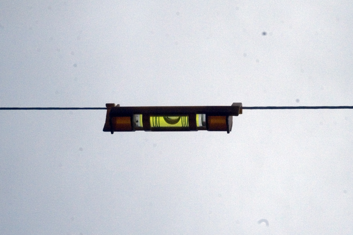

Using string and a line level to establish a reference height
Line level from Lowes 2/$3

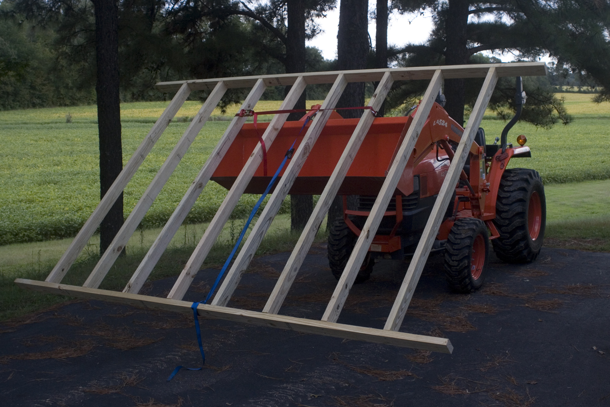

Getting the rafters up

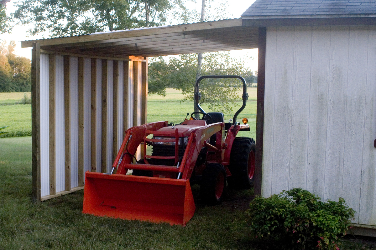

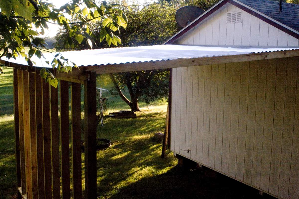

Getting the roofing on. I used two translucent panels
in the middle to provide ambient light inside the lean-to
Almost done with the roof
Roof finished
Side panels on
After. The tractor at home

How big are those rafters? Do you get any snow at all?
   / Tractor Lean-To Project (and checking to see if you can link a Facebook Photo Album)
The rafters are 2 X 4's. Here in Northwest Tennessee we haven't been getting vast amounts of snow in the last few years. However, the Farmers Almanac says it is suppose to be colder and snowier than normal. I'll probably be scraping snow off all winter!
   / Tractor Lean-To Project (and checking to see if you can link a Facebook Photo Album) #8
It looks good Dave. But I think I would have run the tin the other way. Or is that the way it will drain? And with that tree so close, you will need to sweep the leaves off. We had some of those clear panels on a shed. They held up for 15 or 20 years. As long as a limb don't fall on them.
Larro
   / Tractor Lean-To Project (and checking to see if you can link a Facebook Photo Album) #9
good job.
That is not the way the tin will drain, but I did it that way after getting the rafters up and realizing that there was no way to support where the two tin pieces joined together. I couldn't think of an easy way to join the edges. I thought about caulk and about drilling and riveting.
