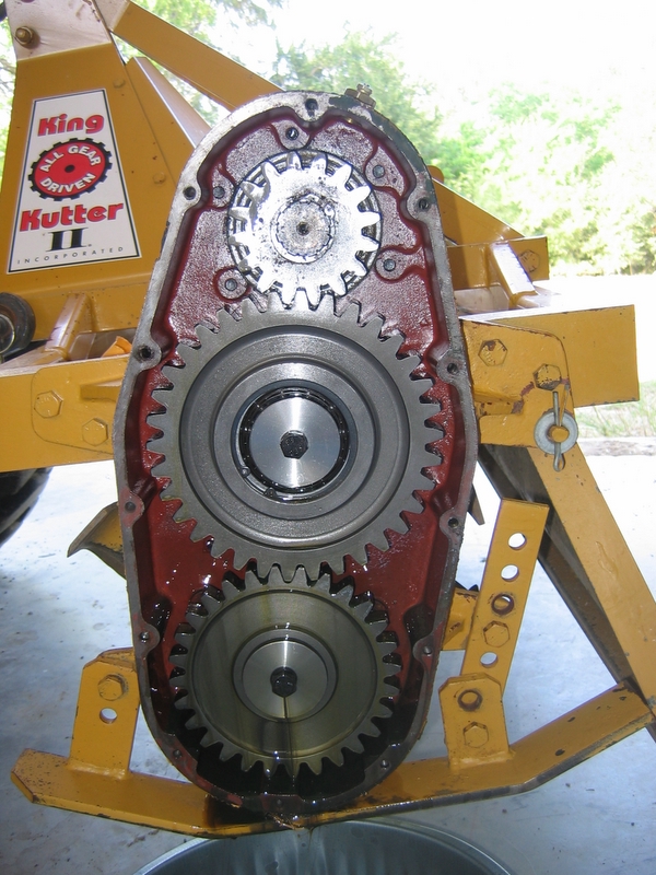

I received a new gasket and some new bolts from King Kutter, took it a part, cleaned it all up with brake fluid, and put it back together. Its no wonder the bolts won't stay tight because you can't tighten them to begin with, without squishing out the rubber gasket. I put the bolts back with medium blue loctite.
Found some dirt inside the gearbox so I'm glad I changed out the oil. Also, noted quite a bit of sludge in the bottom of the gearbox, so I cleaned that out as best I could.
Here are some pics. Note the clearance between the gears. There is a little play, but I don't see any wear, so I assume this is normal. Note the dirt gear, this is the one at the end of the shaft coming from the main gearbox. Its on top, followed by a transfer gear, followed by the gear for the tine shaft at the bottom.
I haven't gotten around to adjusting the clutch yet, though I know I need to. I think I'd rather have a shear bolt. Seems easier to just replace it when it breaks than making sure the clutch is slipping right all the time.
In hind sight I should have done the job, and if I had, I would have figured out it was too abusive and stopped.
I got into some pretty hard clay today after I put the tiller back together, the tiller was jumping all over the place. Its just too dry right now to do any tilling.

The gears look fine in the pics - straight spur gears normally have backlash (clearance). A little dust in the oil might act as a lapping or polishing compound - probably not do any damage. But it's good you cleaned it out & replaced the oil. If gears like this ever fail, its usually by a major chunk (2 or 3 teeth) completely breaking out of the gear from an impact load. Or sometimes they split across the center. Visible wear is less common to see because gears are usually hardened and keep their shape for thousands of hours of use.
On the shear-pin vs slip clutch topic, the slip clutch may protect the machine better, especially if someone other than the owner is operating it. If a shear pin is soft enough to truly protect the machine, it may fail often enough to be a nuissance, prompting someone to put a higher-grade bolt - and there goes the protection. Its less easy to cheat with a slip clutch. They do need to be checked once in a while to make sure they are not stuck from rust. But even if they are they may only be 30% high on release torque.
