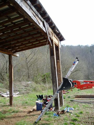

np,
Odd you posted this, because i just got back from my place in TN where i had to enclose an old shed. The thing is 32x15, 14' high on one long side and 18' on the other. I had a 12' ladder, so...when i was stripping some of the ecclectic mismatched siding i had to ladder myself up to the bucket, then pull the ladder up and lean it against the shed wall from inside the bucket. I know it is not a preferred/safest method, but it got the job done. It also got me to thinking about a "man lift" for the bucket because i will be lifting logs to a height of 10' when the house gets under construction.
