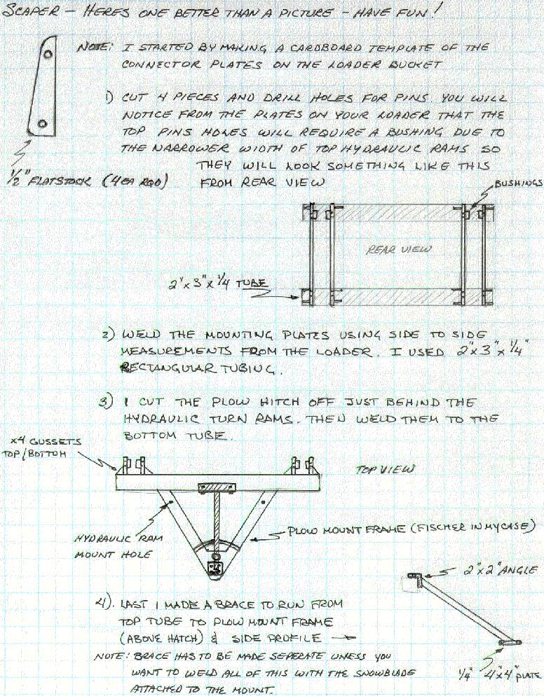

Scaper- Attached is hopefully what you need. Not to scale, but should get you from point A to B okay. Would have sent pics too but snowplow has three or four feet of snow on top of it now. I only use it the first half dozen snowfalls or so. Once I have a good base on the road I switch back to the loader and use the snowblower til June.

What? no attachment?

I thank you so very much. Your right that helps even more then the pictures would have. I will let you know whats up with my project as soon as we get started. As always thanks to all in these posts your always a great help.

Kadonte please send me an e-Mail address so I can get in touch I have some questions to ask and I need to hear the answer unless you can send some more excellent directions. The question centers on double and single acting hyd cyl. The plow is single and the tractor is double. So how the hell do I set it up?? Special type of valve or something so simple I'm over looking the answer. HELP!! Scaper LEver39537@aol.com I'll give ya a number to call if you would prefer.
