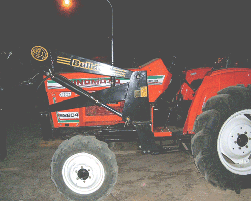

So is the Hinomoto 35 hp model a prospect ?
The seller is a dealer, and he wants to be sure I get what I want and will be happy, though he admits he will sell it to me anyway if I insist. BUT ! he wants to be sure I can dig with the FEL. or rather max out the load capacity. I found out this one too will not have a stepdown restrictor on the down boom valve. As it is I am ready to drive to it and do it. I like it, and the deal is within my range. I will adon the stepdown restrictor for 30 bucks and put the rest on a gift certificate.

On the Hinimoto. It's a grey market tractor and they made a lot of them in all sizes. I've heard nothing bad about them specifically, just that grey market makes getting parts harder. The loader may not be from Japan. Most of the grey's didn't have loaders. Lot's of Koyker loaders are put on them - good loader.

You scared me. I want this other deal to happen. I want to put this nitemare behind me. "Grey Market" as explained to me means Auto parts store or Hardware store, just about anything you could do to getrgoing again will do store.
I can handle that aspect of ownership, I just dont want it to snap in half on full loads coming down on the FEL. I plan to use it to clear out loose soil in holes I would be driving down into. Gradeing, trenching,backbladeing, pulling,dragging,lifting you name it I will be trying to do it but reasonbly, and not out to break the tractor. Two things contributed to my previous failure. 1 metal 2 experience.
1 the metal is like a willie wonka bar of chocolate, a chocolate bunny and 2 everyone else knew before I did what was gonna happen. Yet no one handed me the restrictor valve and built me an additional subframe. (I am glad they didnt)

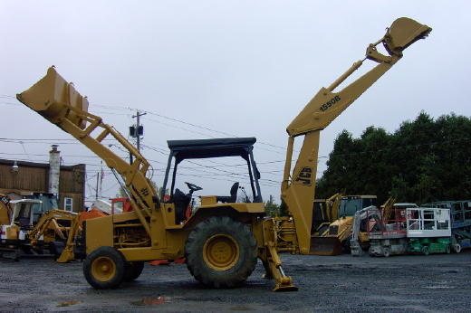

What's better a compact backhoe loader or a tlb ?
Now, from my limited research over the past few years I have come to know a few things. Nothing beats a full size backhoe loader when it comes to brute force and power.
They are also approx all 8 tons or so (see the attachement now). When it comes to a compact backhoe loader, they seem too small for me to fit in without banging my head and knees. They dont seem any more strong then what I see listed for a TLB. And they generally cost more but pound for pound they dont seem like a better deal then a comperable TLB. Granted it is my recent understanding that a TLB isnt designed to do two things at once like using a FEL with the backhoe attached. The way it was explained to me, the backhoe is too heavy a counter weight to be using the FEL at full capacity. I was under the impression that what happened to my old one was the fault of an inferior control valve that "dropped" the load and not that I had a backhoe attatched at that time. I determined a $30 restrictor valve and some additional subframing might have prevented it. Although both could have contributed, I want to know for you folks if your tractor with a backhoe attatched, can handle using the FEL to full capacity and what all modifications did you have to do to make it happen. ie extra subframe support. Pics would be really helpful in this instance.

Your Q on the TLB or compact tractor with loader and hoe is pretty broad. Mostly people try and match the job requirements with the equipment they own or will buy. That's why they make from teeny weeny all they way up into the giant-size. I don't care how powerful the TLB is if it's too big to get to the place you need the hole! I've seen a LOT of new subdivisions with 6' between houses. Naturally, a commercial duty TLB is going to be stronger than an equivalent hp ag duty tractor with a loader and a hoe stuck on. It all depends on what you need done and how fat your wallet is. You can get a decent old TLB like a Ford 555 or 4500 for 5-12K depending on year and condition. Might be too big for you to haul without getting a CDL.
I also don't get what happened with your original tractor. Is it their explanation that normal operation of the loader was so fast that the stopping stress caused the breakage? And that the added counter weight of the BH made it worse. And that a restrictor valve that would have slowed down the loader would have made it all better?? (cough, cough, Bull Sh-t! cough)
Old equipment used to spell out exactly how much counter weight to use. 2500# loader needed AT LEAST 3000#. 3000# loader needed AT LEAST 3500#. My old Ford TLB literature recommends the BH (2500#)and filled tires(1000+#) and 1180# of wheel weights all together. It also brings the loader down as fast or faster than my Kubota L3410. I don't think lack of a $30 restrictor was the issue. Bad design of the loader, valves and lack of proper a load supporting frame -- those sound like more of the issue. Exactly what was the old tractor model? I missed that bit of info.
