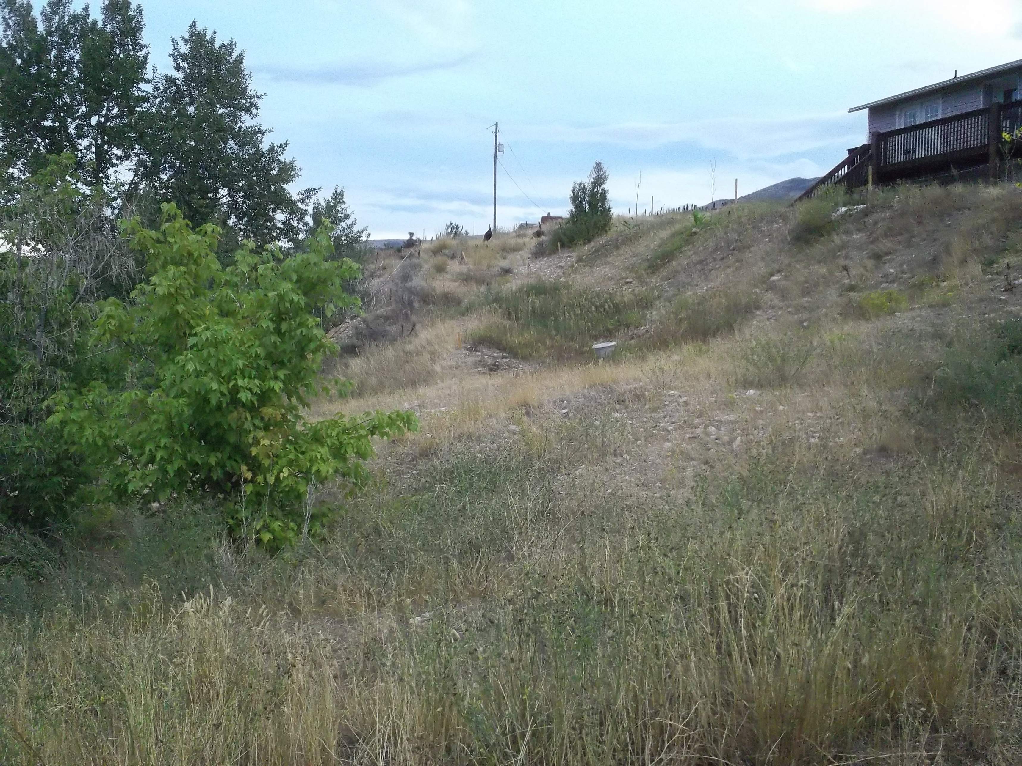

Sure. Here's a representative pic of the hills I'm trying to fix up.
(Turkeys decided to pose for me at the top. Ok fine, I'll take your picture, you vain birds you! :) )

Is this mostly the 3-6" rocks typical of the Utah foothills? An FEL "could" be used to do this, but a backhoe or mini excavator would be the better tool.
Maybe renting something would be the better option? Even renting for a month or two would be be a less expensive way to get a good sized machine to really do what you're trying to do.
