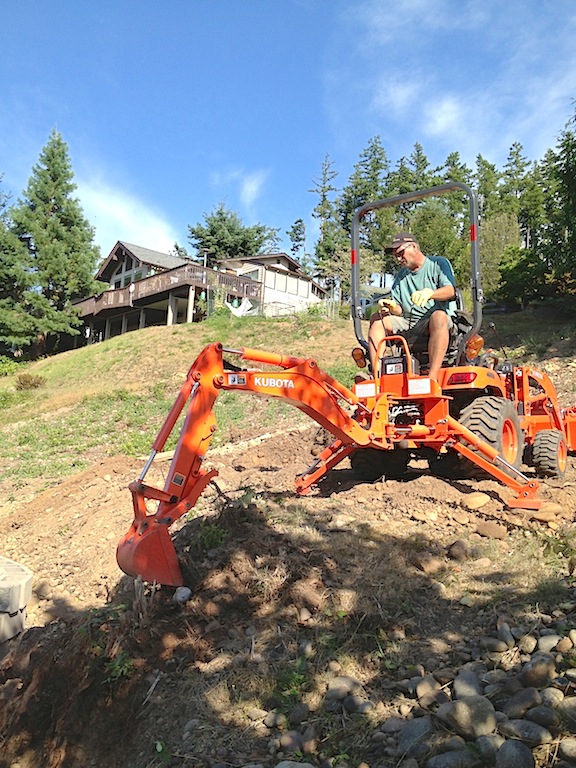

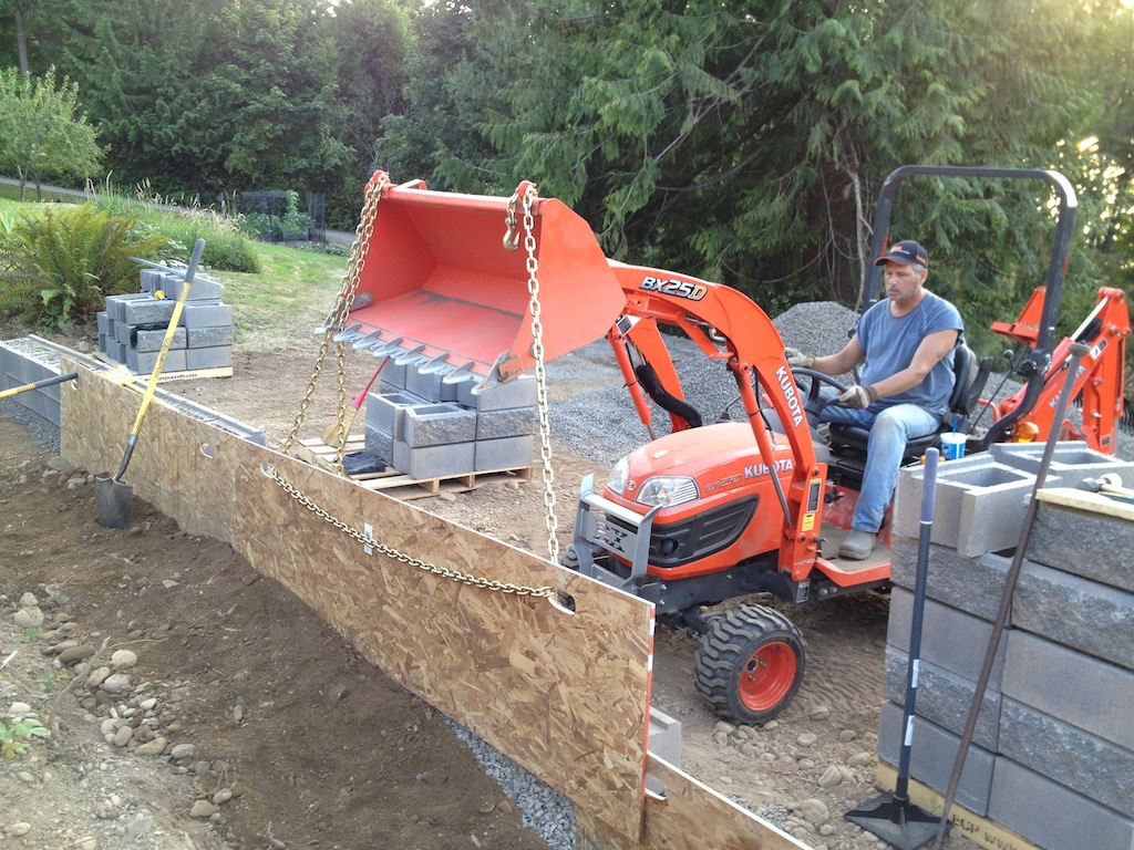

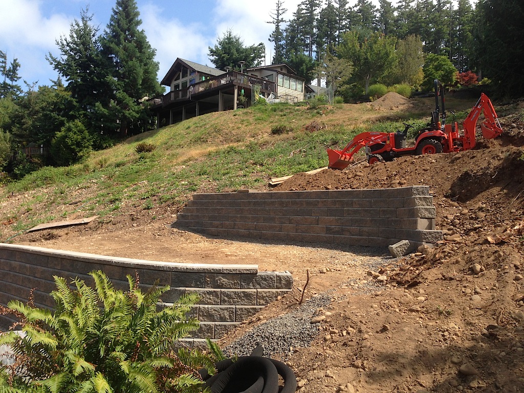

:welcome: from Washington State. I am probably not the best to be advising you but... Looking at your picture, it looks like you are in the same situation I am. I have about one cleared acre on a hill. Lot of rocks like you (maybe not as many) and a serious slope. I am putting in retaining walls and using my BX25D. This little machine is awesome! You may want bigger as I don't know how many acres you plan to deal with but after it is done, I wouldn't want too big a beast hanging around to do the maintenance. You could have someone come out with an excavator for a day or two and rough in your steps. I thought of that but I didn't know exactly what I wanted so I am doing it slowly myself. It is a heck of a lot of fun!
The combination of FEL and a 12in backhoe with thumb can do more than you would ever expect, it's low to the ground but still great ground clearance, and can get in tight spaces. Don't let the size fool you. I added a piranha tooth bar and hooks to the FEL from BXpanded, and skid plates and wheel spacers from BroTek. Highly recommend all. Here are a few pics of my big project to date. ONE THING I MUST SAY... be careful! It is easy to roll a tractor on slopes. Most of my slope is about 25 degrees sometimes more so terracing the hill is a must so I can better maintain it.
This is my first tractor and it is a learning experience. Go slowwwww!

I would be very, very careful trying to put a tractor on those slopes. I know you want to do this yourself, but the best tool for that is an excavator. You could rent a mini-ex but if you have not experience it would be best to hire a professional that can keep the cuts straight and level. They can do a lot of terracing on those slopes and do it safely in a few days and even put in a switch back road for you to drive up and down safely with mower or TRACTOR at the time when you start putting in the terrace walls.
   / Tractor models for small-scale rocky diggign? #14
I definitely second that!!! When the excavator cleared my slope he leveled out an area at the bottom and did cut in a diagonal path and switch back for me to get down the hill. The biggest problem is just getting a start on creating a flat area on the slope. It takes some BH work to create a little flat pad to start digging with your FEL.
There have been some dicey situations even though I am going as slow as possible and keeping the bucket low. Especially on loose dirt that hasn't compacted enough yet. I know now exactly what 'pucker factor' is all about and I don't like the feeling. :eek:

Thank you Jeff. 'Almost' is the operative word. I wish the slopes were just a little less but because of them, I have the most incredible views.

Your soil doesnt look that hard to dig, mostly smaller rock if Im right. Under 6".
Also looks like there is a much shallower "road" in the foreground that could be used to give you access to the bottom, then you can work up, one terrace at a time, cutting the slope back from a safe spot. The distant slopes are far too steep to work on as they are with a tractor IMHO, but once you start terracing it wouldnt be an issue.
Whats your timeline? Can you work on this full time? A BX could handle it, but it will take alot of time. If you have a bit of acerage, a B21 or B26 would be a better choice that not only is stronger, but would do the job quicker, and be a better tractor for future uses.
Ideally though, its hard to beat an excavator at jobs like this. An ex with a bobcat would be my ideal choice. A dozer would also be good, but that isnt something easy to rent or transport for a homeowner.
