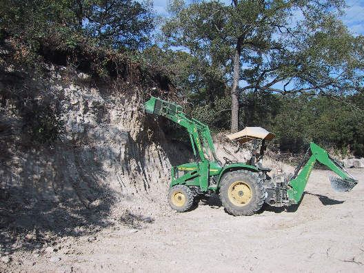

One thing You could to to protct the tractor is to have a spill guard like a wheeled/tracked loader has to hold rocks back. One thing that worries me is the mass above and how a rock tends to roll or bounce down loader arms. One thing if you dont mind me asking is can you get the tractor on top of the cliff, if you can then use the hoe to dig down as far as you can with it and just let the material fall as you scrape it off and dump it then drive the tractor back down and use the loader to load the loose stuff then you can use the hoe to rake the remaining bench down. I had a good friend break his back on a hill like yours digging it out with a full sixed hoe, it just takes one 50 pound rock from that height.

That's quite a reach for your loader! No wonder some of the loose stuff pops down when you are digging up there. If you are really into doing it with your tractor, bringing in a couple truckloads of clean fill could give you about a 2-3 ft ramp to work from so you aren't right at the limit for the loader. Of course you'd have to move the dirt ramp as you worked your way along the bank. Overall, it would probably be a lot quicker to bring an excavator in for 1-2 days to knock the thing down.

After seeing your picture, I'm certain your 4700 is not the tool of choice, but rather the tool of opportunity. I have some areas on my property that are very similar to yours, maybe even higher. I just refuse to use my tractor in that situation because I know I would destroy it. It's a hard decision, and I'm trying to be more sympathetic than judgemental, but I think that rock through your hood is a warning of things to come. You probably need a full reinforced cage around your operator's platform. Ultimately you have to make the decision on the amount of risk.

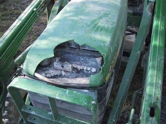

Now about your tractor... Is that plastic or fiberglas? The hood and fenders on my New Holland are fiberglas. I got a limb between my rear tire and fender and it made a 1/2" (marble sized) break along one edge and I can clearly see the fender's innards are fiberglas. Considering that the Chevrolet Corvette has used fiberglas since 1954, I think fiberglas has shown itself to be long-lived when exposed to the elements. I am very happy for the fiberglas in my tractor and I love computers too. Where would air travel, manufacturing, and communications be without computers? Anything can be abused. It's not the object, but the person in control of it that makes it good or evil. ...okay, I'll quit lecturing. /forums/images/graemlins/tongue.gif /forums/images/graemlins/laugh.gif /forums/images/graemlins/laugh.gif

Don, is it possible to work from above with the BH? I have a small gravel pit and have had good luck removing vegetation/subsoil first and then loosening the gravel and using the BH to push material over the edge. Bill C

"Did you check your battery for damage ? Whatever it was that ruined your tractors hood might have cracked the batteries case ."
All that was broke was the hood. The rock that broke it was only fist size. A lot of large rocks have bounced off it with no real damage but this one hit just right and the hood just shattered. I never noticed just how thin an flimsy the plastic in the hood is but now I am supprised that some of the limbs that have it before did not break it.

"JDParts shows a price of $210.00 for the 4500/4600/4700 hood (P/N LVU12063)."
That's good news. Only $210 for a part that cost JD maybe $20 or so. I expected a larger markup. I wonder how much the two decals will cost. I hope less than the hood.

"One thing if you dont mind me asking is can you get the tractor on top of the cliff?'
I wish there was a way to get up there but there isn't. Actually I am being very careful not to let large rocks fall. If I see any chance of anything of size moving I take full advantage of the hydro transmission to get away at full speed. I use digging bars on top of the hill to dislodge the large rocks so there are none near the edge where I am digging. I have dug down to a solid rock ledge at the base of the hill so when a 3000 pound boulder falls 14 feet from the top it shakes the ground. There is no doubt in my mind what they would do to anything that was in their way.

"Now about your tractor... Is that plastic or fiberglas?"
I believe it is ABS. It is definitely not fiberglass. I owned a Corvette for 30 years and I had much large rocks bounce off it with out doing any damage other than paint dings. One bounced of the hood and came through the windshield. It only made a tiny ding in the paint although it made a lot noise when it hit but then it was glancing blow to the Corvette hood whereas the rock that broke the tractor hood made a direct hit and transferred all of its energy to the hood. I don't know if the fiberglass would have survived if it took a direct hit but it would not have shattered into small pieces. The other thing in the fiberglass's favor on a Corvette is that it is protected from UV light by paint. I doubt seriously that a plastic tractor with molded in color would survive thirty years in the sun.

Right you are steve on the comparison cost of repairing a metal hood vs replacing a plastic/fiberglas hood. But what about 20 years from now when the hood has been discontinued......
/ Tractor modifications #38
Plastic can be saved, if you have a similar remnant. I punched a hole in a plastic dirt bike gas tank one. Broke the front fend, which was the same plastic. A guy used a hot air gun of some sort, and used the fender material to "weld" the hole in the gas tank. Worked perfect...

"Plastic can be saved, if you have a similar remnant."
Not the stuff that John Deere uses! It shatters into small pieces. Of the missing area there were about 50 small pieces that I found. I even found a handful of small pieces in the air cleaner.I have repaired many plastic items by using a small wood burning iron to melt them back together and using similar plastic as filler rod but not this type of plastic.
I was at my dealer's yeaterday to pick up the $165 worth of oil and filters to do the 400 hour service. They had another 4700 in to have its hood replace for the same reason so mine is not an isolated incident. I priced the extra armor kit and it is $615 so I guess I was better off just replacing the hood since it is not all that much more than an oil change!!!!

The components of the kit are also available for individual purchase to meet specific operator needs. See how much just the hood guard costs, if it's reasonable it could save you money in the long run.
