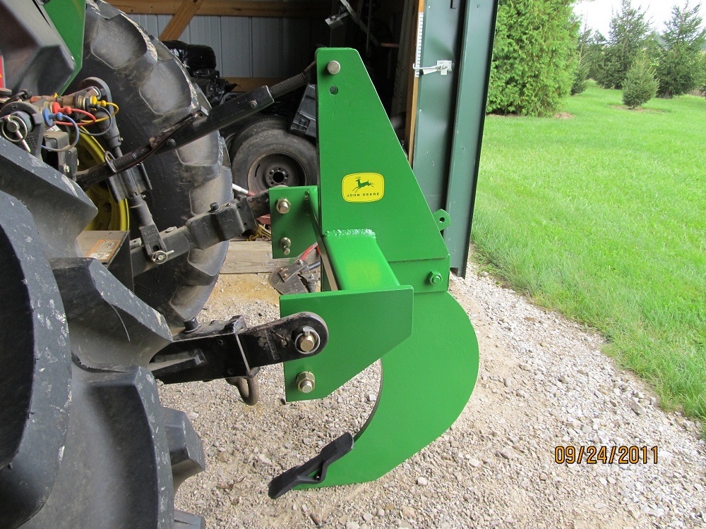

Here's the only ripper I found effective to rip stumps out with. I did try a box blade type thing but it didn't grip right and I thought was hard on the tractor. I felt something would bend or break so stopped using the box blade thing that had the shanks but no blade.
This is one I rebuilt (thread on TBN) and used behind a bigger tractor. I would come in under the main portion of the stump and just drive forward as slow as I could. The curved portion of the blade would slide under the root and lift up the stump. I did 8" and a little bigger diameters.
This put no strain on the tractor other than what it was intended for. The problem is I had a big holes to fill and lots of stumps with dirt on them. After I filled the holes they kept settling on me and I had to keep filling as that happened. Too much work. But I did rip stumps out PDQ.

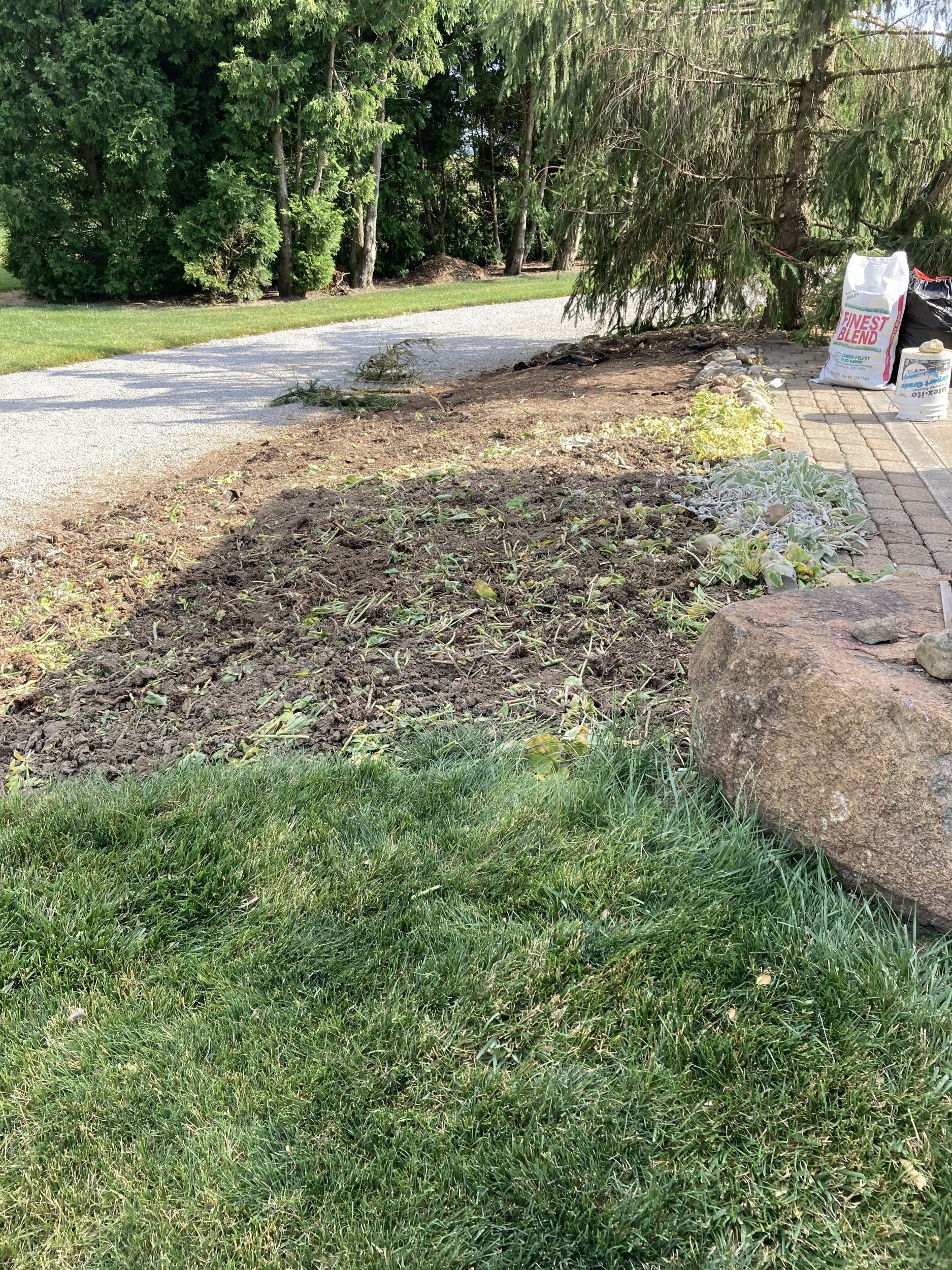

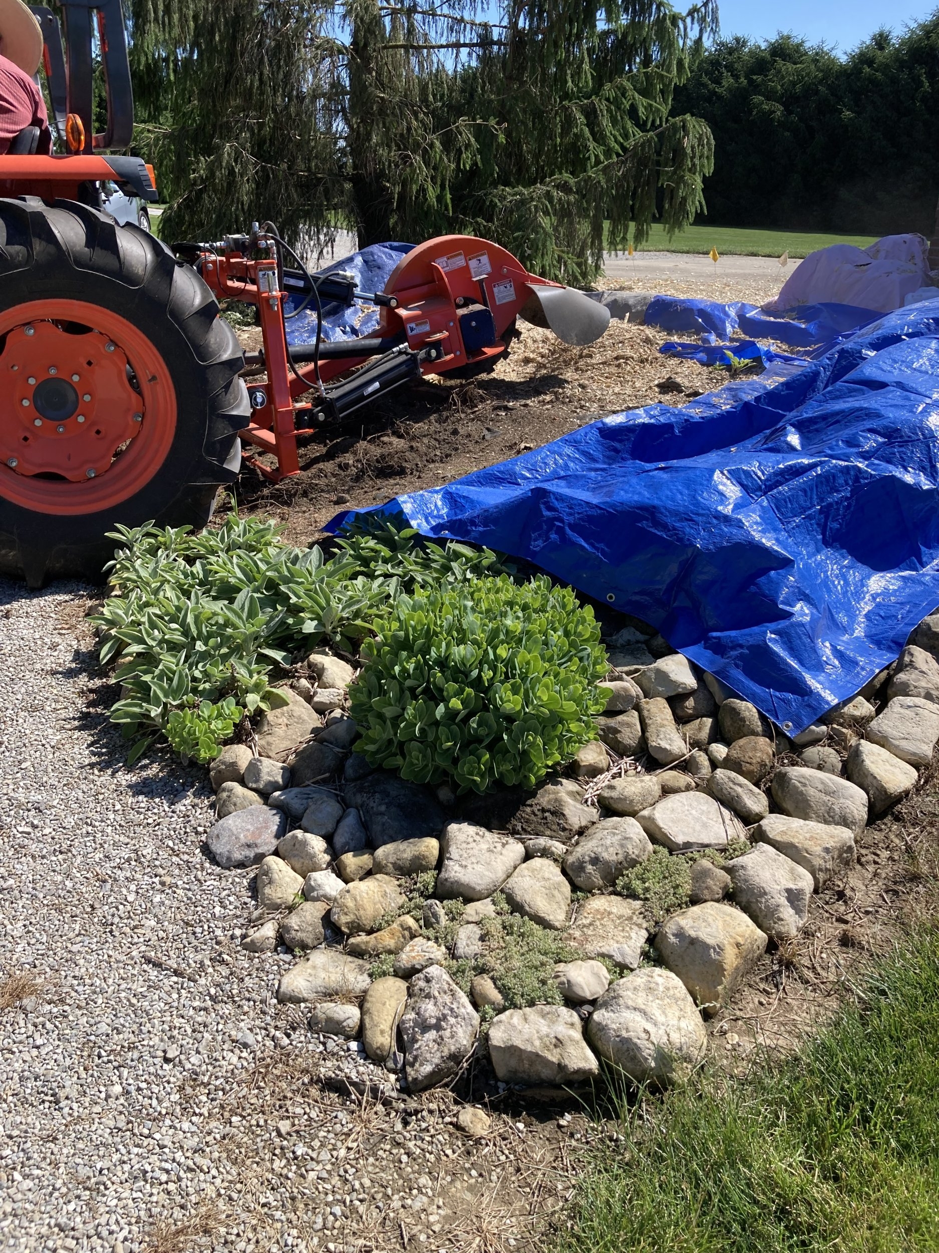

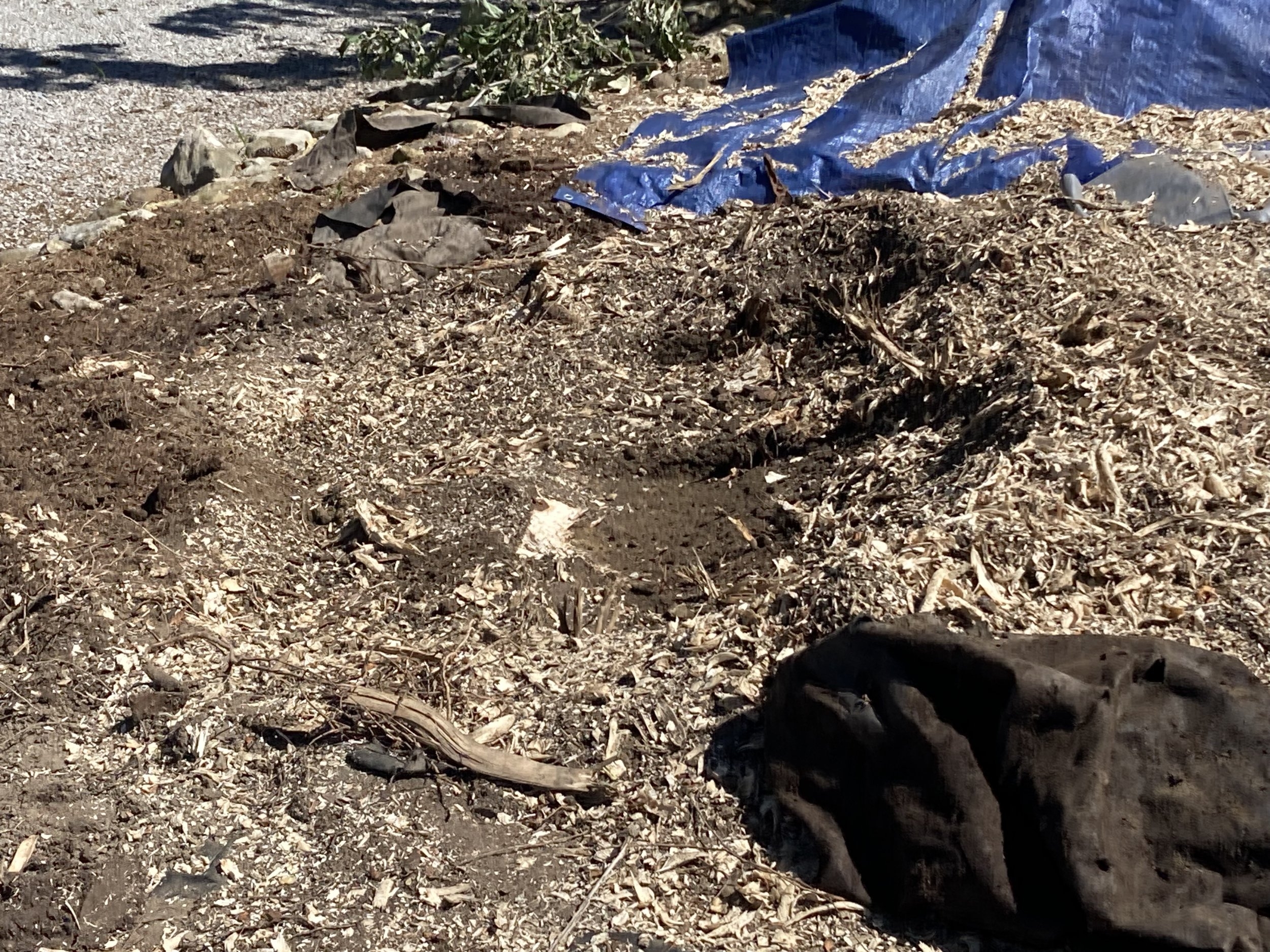

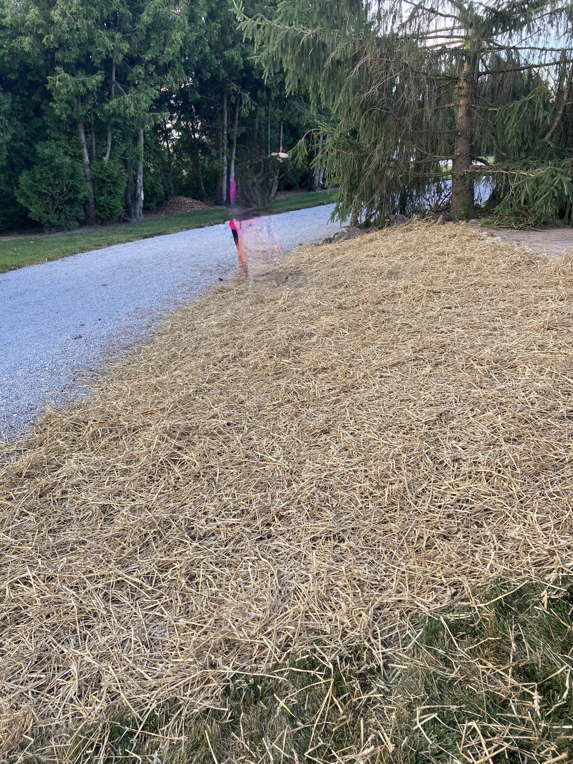

I've done everything possible to get rid of tree stumps for over 40 years. I've burned, cut flush, backhoe, bulldozed and nothing was fully correct.
Finally, I bought a 3 pt hitch stump grinder and in my first few hours I satisfactorily ground 10 meaningful stumps below grade. And on top of that, I believe I could sell the grinder for more than I paid.
Recently, I ground a 16" softwood stump that was close to the house. Below grade maybe 5" is all that I wanted.
Then, I spaded the ground, added a little fill, seeded and strawed. I set the sprinkler on top, watered multiple times a day and six days later the grass is popping through. From annoying large stump in a bad place close to the house to a week later almost green grass and no one is the wiser. I've ground stumps in the woods as well.
Of all the ways to deal with stumps, buy a stump grinder--I have a LandPride--grind everything and save 99% percent of your time for the wife and kids.
