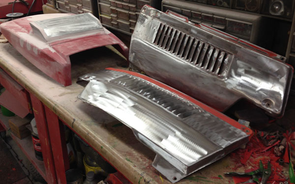

I am sanding on the hood and side panels today and should get them painted this afternoon :thumbsup:
Also here is the first picture of the rear tail lights . aaaranchkinghoodsanded.jpg

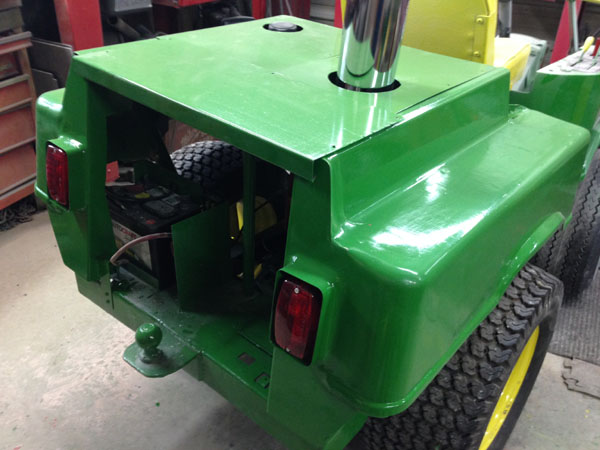

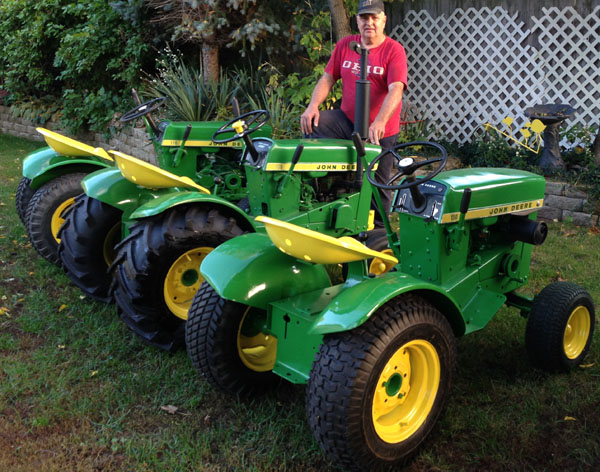

Test drove the Bolens , kept jumping out of all gears?? Got the Ranch King Parts painted this afternoon .
Pulled out the three jd round fender tractors to see them side by side for the very first time.:)aaaroundfenders.jpg

Love those tires on the middle one!

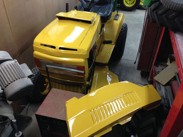

Here is a picture of the painted hood and side panels for the Ranch King. Not perfect but solid like new with the nine cracks repaired. :dance1:aaaranchkinghoodpaint.jpg

Man I could sure use your skills, my mom's 345 hood is all cracked up and it's around $400 from the dealer. I have contemplated a few times trying my hand at fiberglassing and painting itn. The canopy on my 1070 is the same way. What paint are yoy using on the plastic panels, does regular enamel work?

Yes , just regular tractor paint and a paint brush . I did not use fiberglass , I just riveted thin metal on the inside of each crack and used just bondo and sanded it smooth and a nice thick coat of paint slapped on with a paint brush. In a couple weeks I can sand out the rough spots and it looks good enough for me and my grandson to have fun on, ha,ha.
