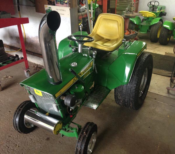

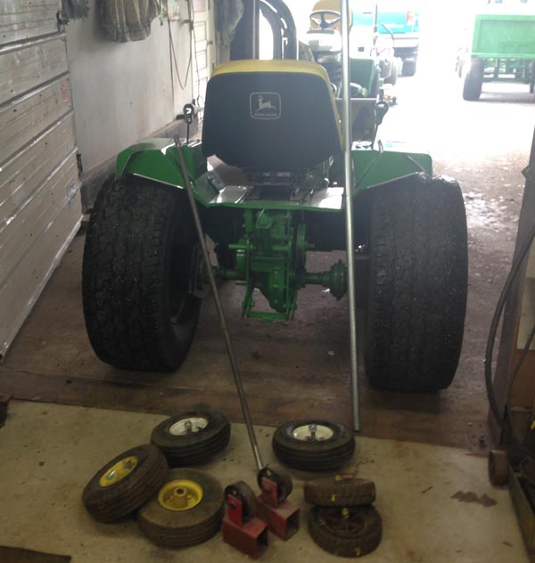

Thanks for the kind words , much appreciated . I hope I continue to give others ideas for their own crazy projects. Todays project is to build wheely bars for the rear of my grandsons hot rod tractor. More than once when I popped the clutch I thought the front of the tractor was coming all the way over, ha,ha. This will solve the problem. aaaaweelybars1.jpgaaaaweelybars2.jpg
