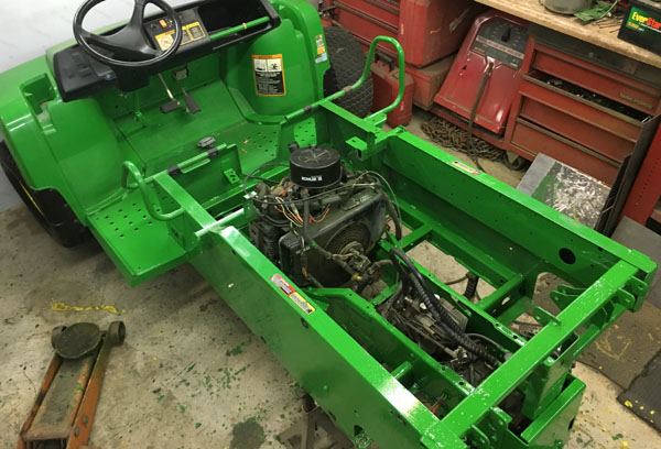

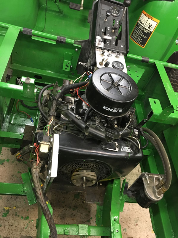

The cub has the 18 hp twin Koehler .
Todays picture shows the Cub Cadet frame now inside the JD Gator and welded in place. aaaasembly2.jpg

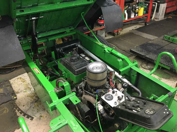

Here is the next progress picture of the DeereCubGator project. You can see I narrowed up the Cub dash and reinstalled all the guages and switches in the new smaller area. It is all mounted to the newly fabricated center console I made today . It is actually all fitting together very nice. aaagatordash.jpg

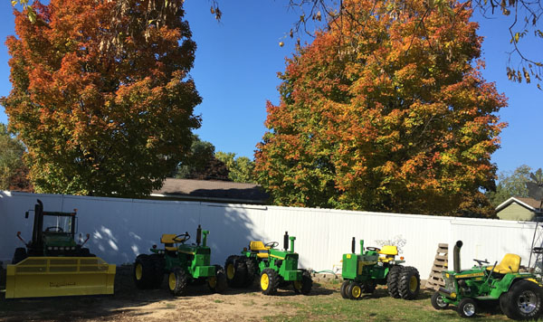

Looking like fall in Northern Michigan today in our backyard.

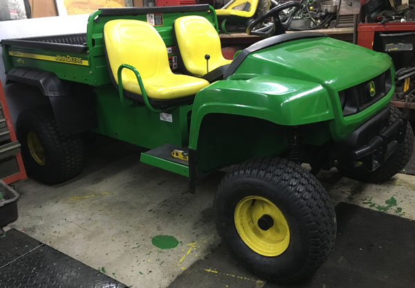

aaafrontlift.jpgFront lift kit , Today I removed the front suspension and tweaked the front swing arms, built new shock mounts and tweaked the tie rods. Now the front sits much nicer along with the rear lift I did a couple weeks ago. My next project is a roof for the Gator next week.

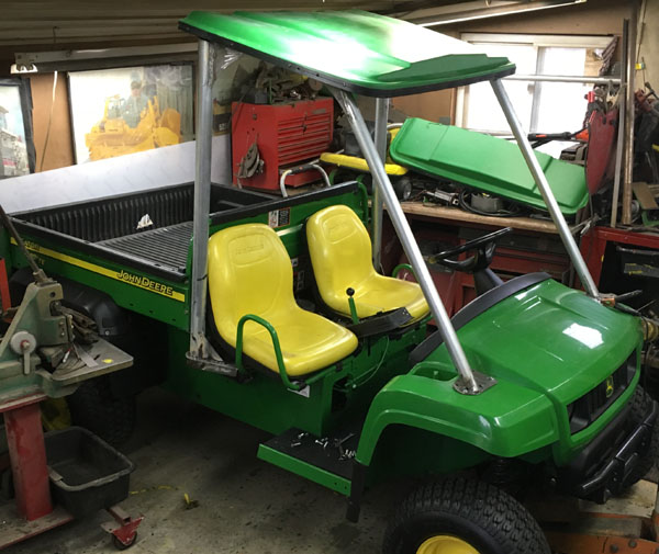

aaagatorroof1.jpgTodays progress picture shows some of the first roll bars cut and tack welded together . Also I set the roof on for the first time after trimming 10 inches off the rear of it to get a more sporty effect. Also I tilted the roof down in front for a better look . Once it is all done I will paint all the roll bars and the roof black. Nothing fancy but another fun challenge. Hoping to share the finished video this weekend.
