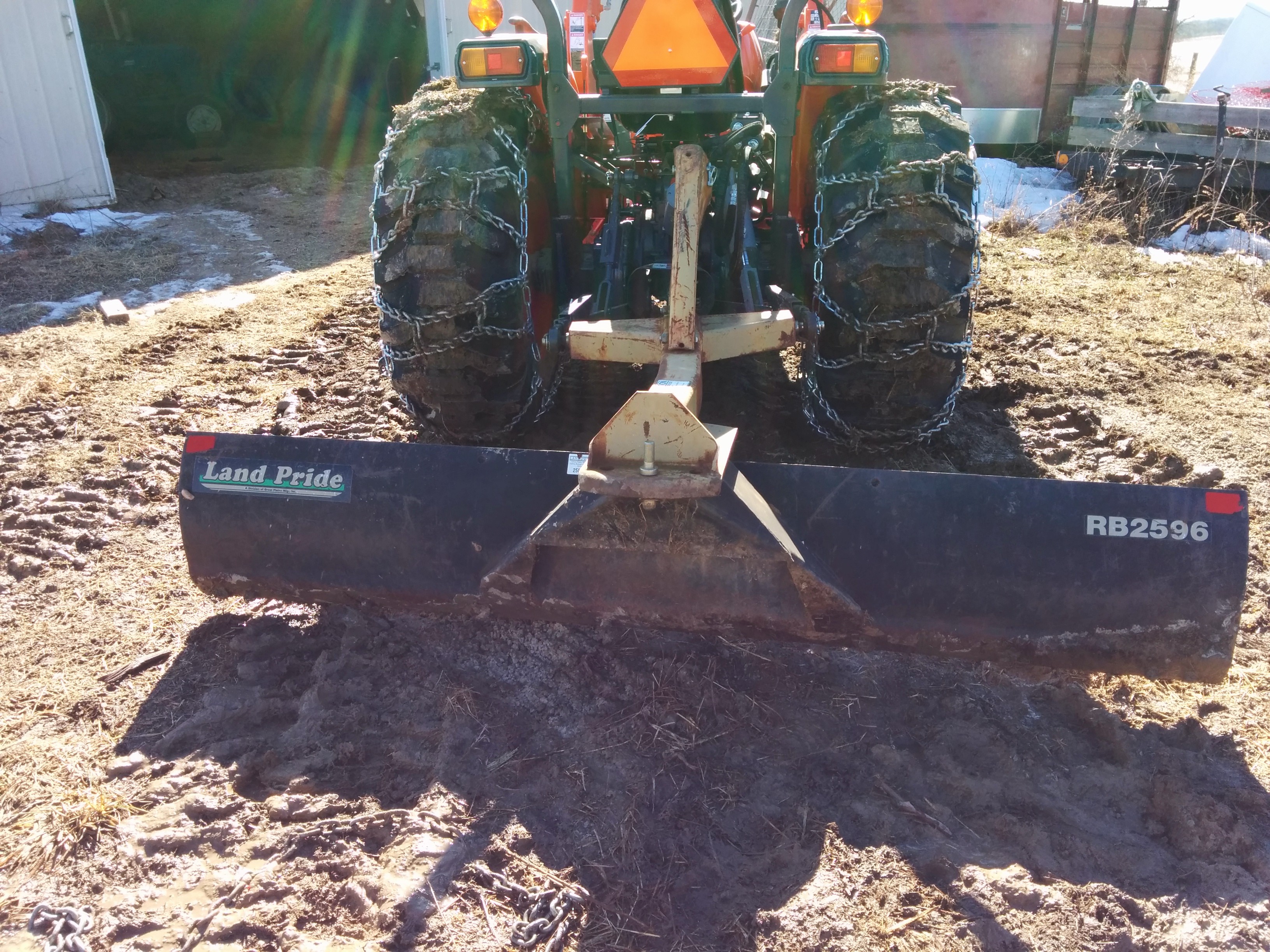

But take your time and watch craigslist. I bought a nice blade on craigslist. The previous owner had bent the frame all up and couldn't use it. Since I have a hydro remotes on the rear arms that didn't really cause me any problems at all. $100 for this:
The actual blade was perfectly straight.
I got the chains from one of the online stores, tirechains.com, for about $300. It is true that in recent years I haven't needed them, but when we really get snow it makes a huge difference.
