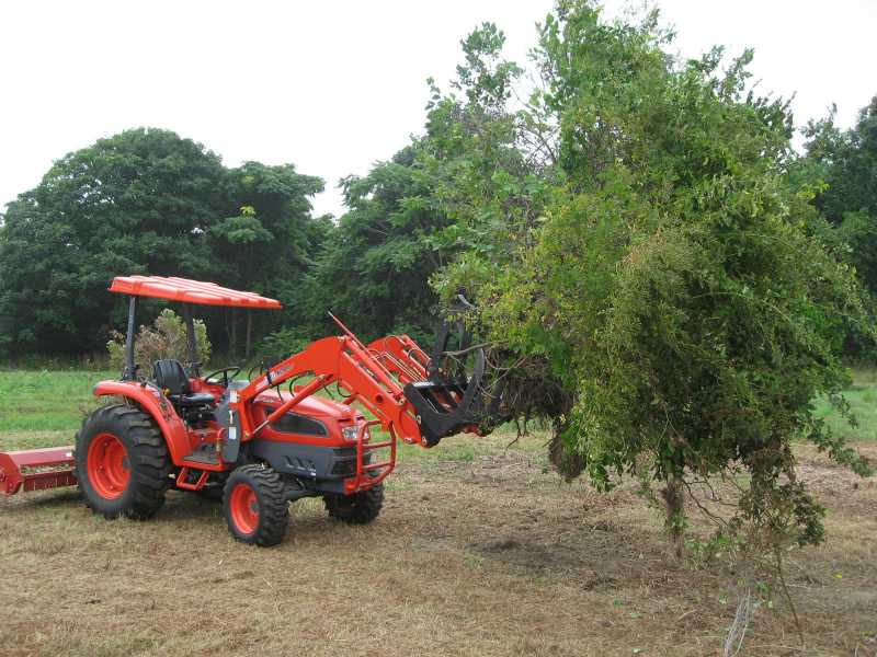

If you were happy with the T140 you could certainly get that sort of FEL performance from a midsized CUT. The T140 has lift capacity rated at 1400lbs. Almost any of the midsized 35-40hp CUTs can match that. For less than $19K I got a Kioti DK40se with 2700lbs lift capacity and it would directly mount the spade bucket you already have. Skid steer QA adapters for the other tractors can be had for between $300-600.

Island - skidsteers are usually rated by safe operating loads (ROC or rated operating capacity) for lift capacity while CUT loaders are usually rated by maximum hydraulic lifting force available. ROC is typically less than half of the hydraulic lifting force available, and a skidsteer rated for 1400lbs may actually be capable of lifting 3000lbs or more, though not necessarily safely. However it can lift 1400lbs safely all day, day after day. The CUT FEL rated for 2000lbs can certainly lift that occasionally but may or may not do well day after day, and likely will require an enormous counterweight on the back end of the tractor (filled tires + a weight box or heavy implement on the 3ph) to safely lift the load, while the skidsteer is ready to go with no added weights. (A few skidsteers have optional rear weights that raise their rated operating capacity slightly.) The CUT's FEL is also limited by hydraulic capacity at the rated weight. I would not recommend using a tractor FEL above maybe 75% of its rated lift capacity (not to be confused with a skidsteer's ROC) and then only with every last ounce of ballast called for by the FEL manual.
While both are fun, they really are two different machines. Skidsteers get stuck in rough fields and are rough riders anywhere. Tractors can't maneuver in tight spaces and are tiresome if loading chores will be done for more than 10-15 minutes a day.
