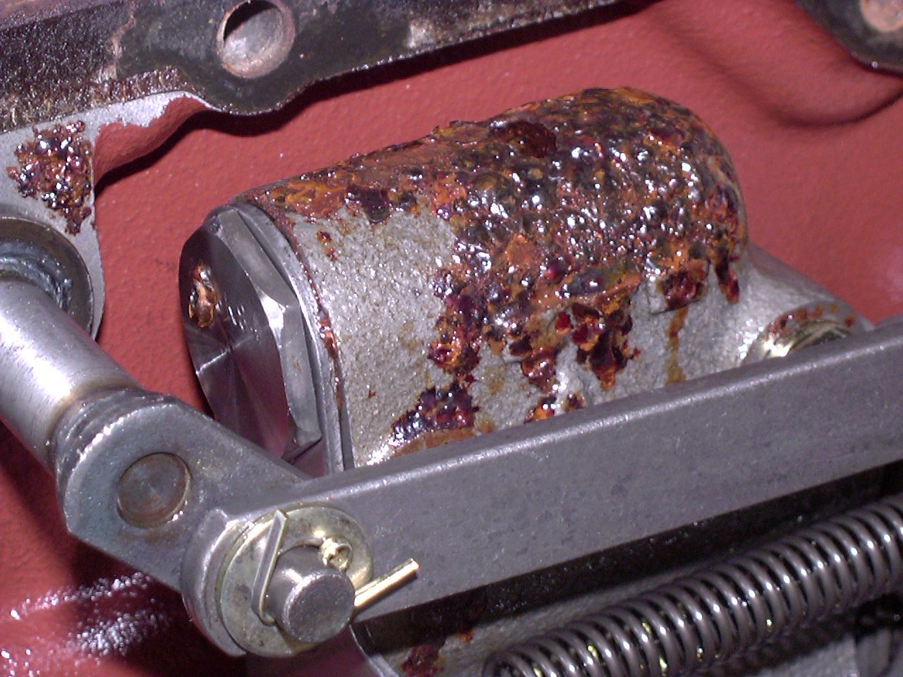

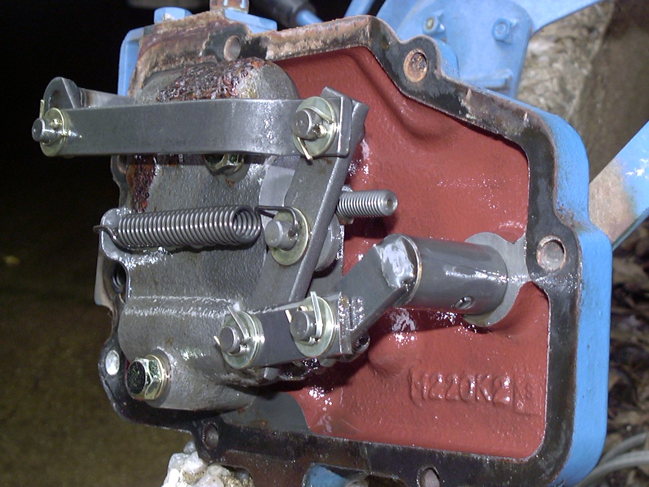

So back to parts cleaning (even though beer is a better topic)... I'm new to all this tractor work but have saved a bundle in the last couple weeks.
I've taken off the control valve cover with control valve assembly attached. A NH service tech said (sight unseen) to soak it in a 'solvent,' blow it out with air, and soak it again.
It appears that over the years the gasket failed allowing water to drip on the top of the assembly causing sort of a carmelized rust layer.
What solvent do you recommend to soak this part in?
Will your solvent damage any of the o-rings inside (I don't plan to take the assembly apart)?

How about automatic transmission fluid-ATF. Been known to do wonders.

Are you sure that's a gunky deposit and not rust. Kind of looks like rust from here. A gasket scraper and wire brush might be the easiest route.
   / tractor parts cleaning #17
looks like rust to me to...

Kroil, wire bristle "toothbrush", Kroil, compressed air. No damage.
