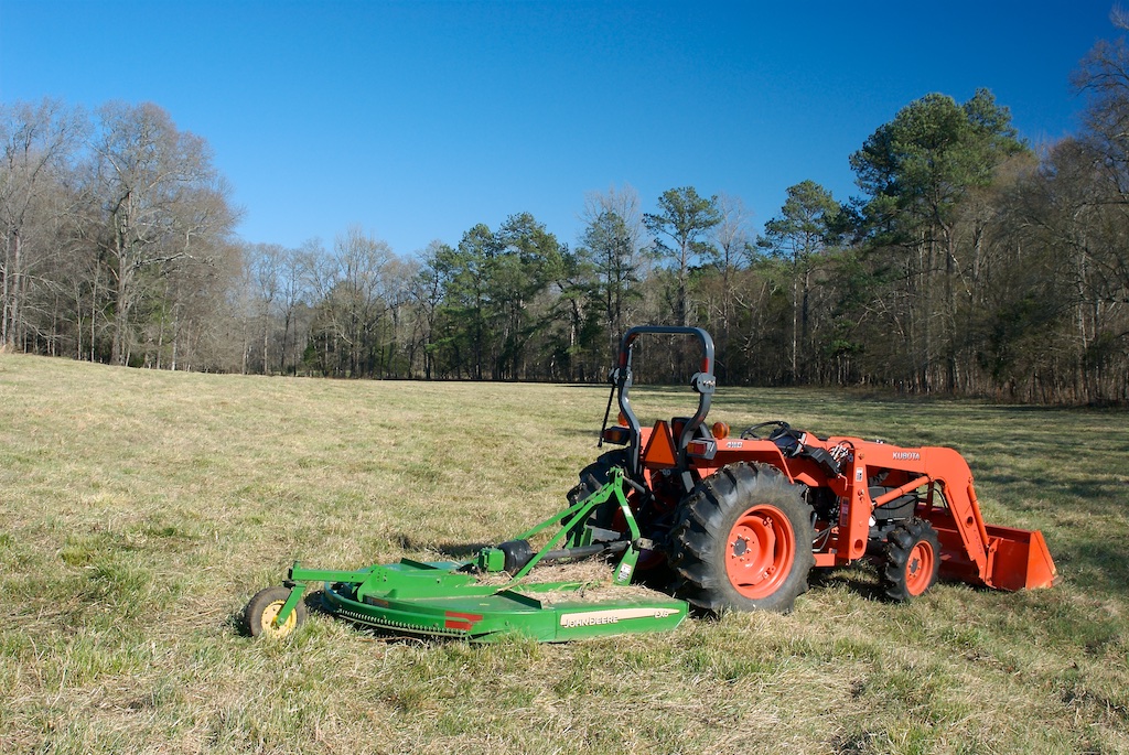

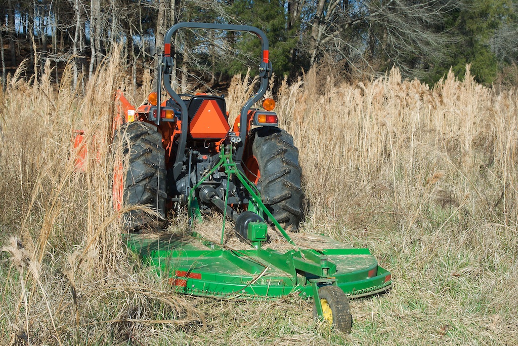

Well, just for a reference, I tackled this with my 45 hp tractor and light duty 6' cutter:
This is the end result:
It took a long time and there was only minimal brush mixed in, but it was not a problem for the tractor or the tiny mower. So as to a 10' mower I think a lot depends on what you are cutting and how wet it is. If the stuff in these pictures had been green and wet it would have been tougher if not impossible. Most cutters have a recommended minimum PTO hp. If you will be doing lots of pasture work you may need two. A 10' pull behind and maybe a 6-7' three point for smaller roads and confined areas.
