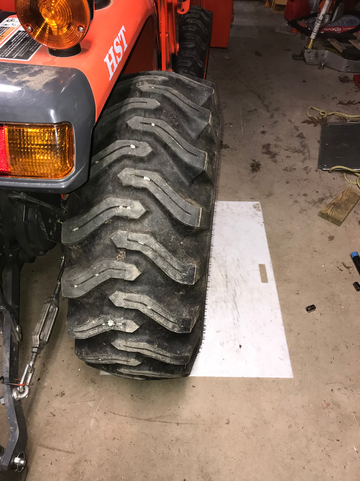

   / Tractor Recommendation - 10 acres, mountains, VERY steep driveway #38
Bro Tek spacers for L3200 (same chassis as L3800). Surprisingly easy install.
Rear R4 with spacers installed. We did it for tire chain clearance.
Thread.
My similar starting thread.
Our driveway is only 750 and we usually have it plowed, but we Average 10 of snow per season and got 14 last year. We use the FEL bucket with Edge Tamers. We grooved the R4 for better snow traction, and recently got logging chains.
