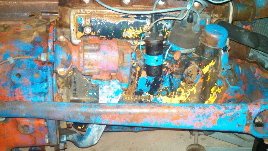

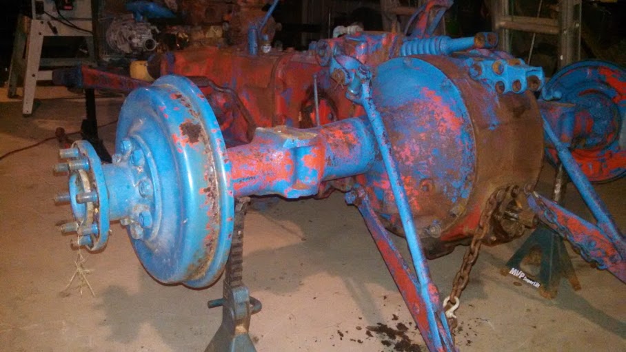

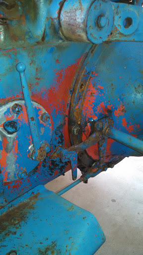

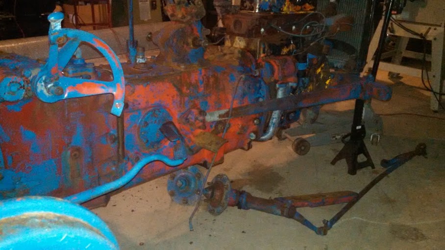

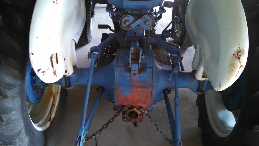

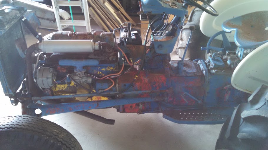

Decided to bring home another Ford. This time, to make look parade-worthy. I told my wife it'll be ready in 2 years. :laughing:
Anyhow, just thought I'd keep track of the process here.
The sheet metal (already removed) is junk.... every bit of it.
The gas tank itself it fine, but there are tons of busted bolts and make-shift fasteners all over the tractor. I'll be dismantling a bit, drilling and tapping. I've thought about doing paint/rust removal right away in one fell swoop (easy off, power wash, phosphoric acid, primer), but I might just start tearing parts off and prep along the way.

i did a ford 950 a ys ago that had nearly every bolt or stud from the transmission forward, and about half from the tranny back, busted off, cross threaded or stripped out, or stuck so bad they had to be drilled and extracted.
i did nothing but remove and repair fastner and holes for 2 weeks of work solid.

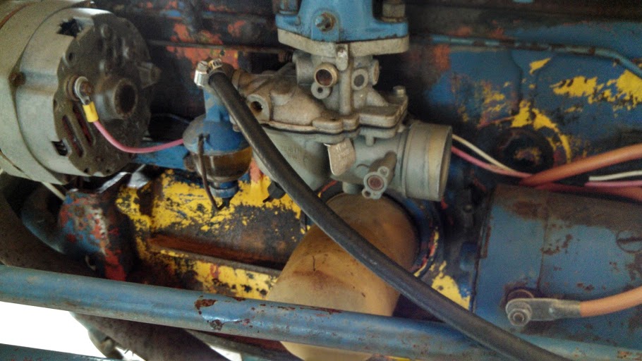

Actually, my father-in-law bought it last year as a favor to the guy that owned it. He and I got it drug home and tried starting it... only hitting on 1 cylinder (the cylinder with compression :) ). Did some digging and ended up pulling the head to have it rebuilt. The short block was in great shape (was replaced some odd years ago). Don't know why the head and gasket were so bad. Anyhow, the engine is together and purring like a kitten. Metal is bad, wiring harness is cobbled up, gauges don't work and there's a ton of broken studs throughout. Runs real good, the 2-stage clutch feels good and the gears are tight and quiet (no whining like I get from my well-used 860) and both brakes are working.

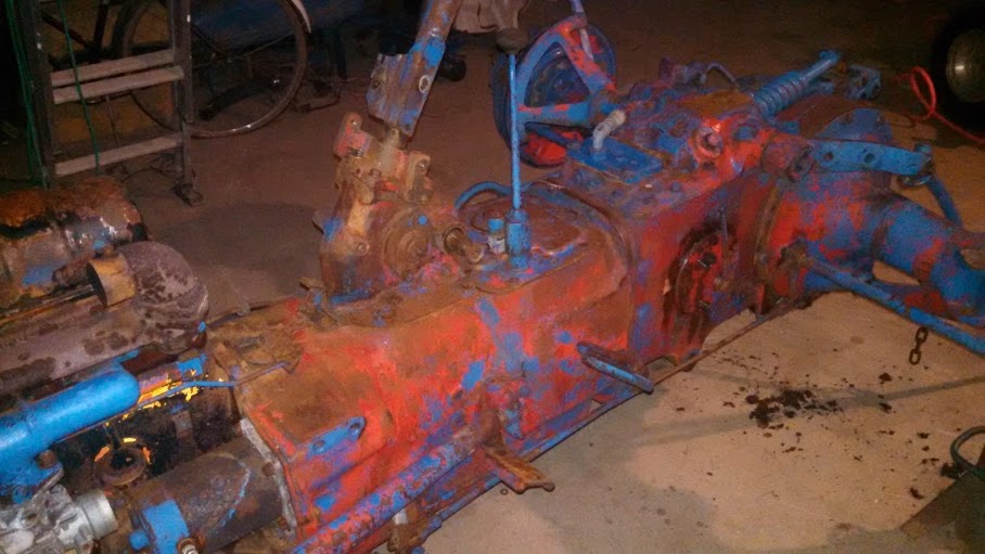

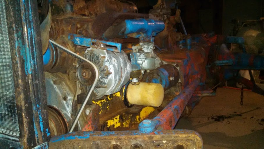

Did the oven cleaner thing today. Looking through some earlier pics, I did manage to remove some of the blue paint, but that's about it. With the rain coming, I just wanted to get this thing in the barn... I'll finish the stripping/prepping right where it sits.... which probably means elbow grease.
I have a pile of garbage started and a pile of parts to refurbish... I'll have to get those pics another time.
Now I know why the tires sat so far away from the fenders.... extensions.
