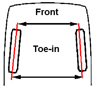

   / Tractor refuses tp run straight #17
This drawing shows toe-in. It may help you understand better.
#18
Thanks for the drawing and shall try to use this to rectify the problem in my tractor. Thanks also for the quote. However,I beg to reason that for some people this is the situation,to be really honest. I should not be discussing this as this is not the forums arena and am only responding because there is a quote.
