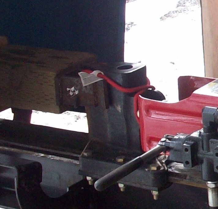

I may have pounded my bracket down a bit by dropping big blocks of rock maple on it. Other then that it works fine but it is relatively new yet.
These log splitters are pretty decent machines, I know what you mean about the table bolts though a few times pieces got stuck or were just the wrong length and got pinned against those brackets and did sever a bolt or two. Thought I should show how the hood was pressed before someone got the idea the splitting wedge was pushing directly on the sheet Rhino-body work 004.JPGmetal- this (adaptor) was migged together when I couldn't get a u-joint to separate..it worked really well for that to

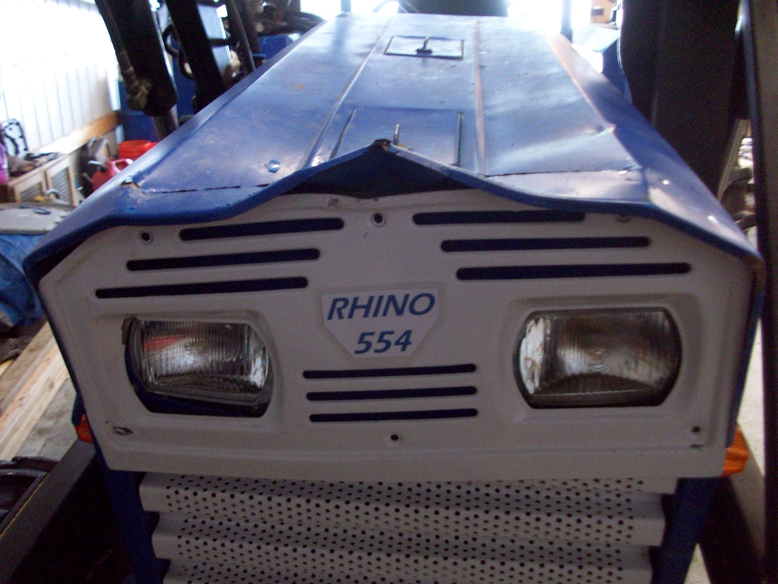

Here's an update on the body work progress-this a different view after the damage, the home made Rhino-bone head caused carnage 006.jpgRhino label jinxed me I think

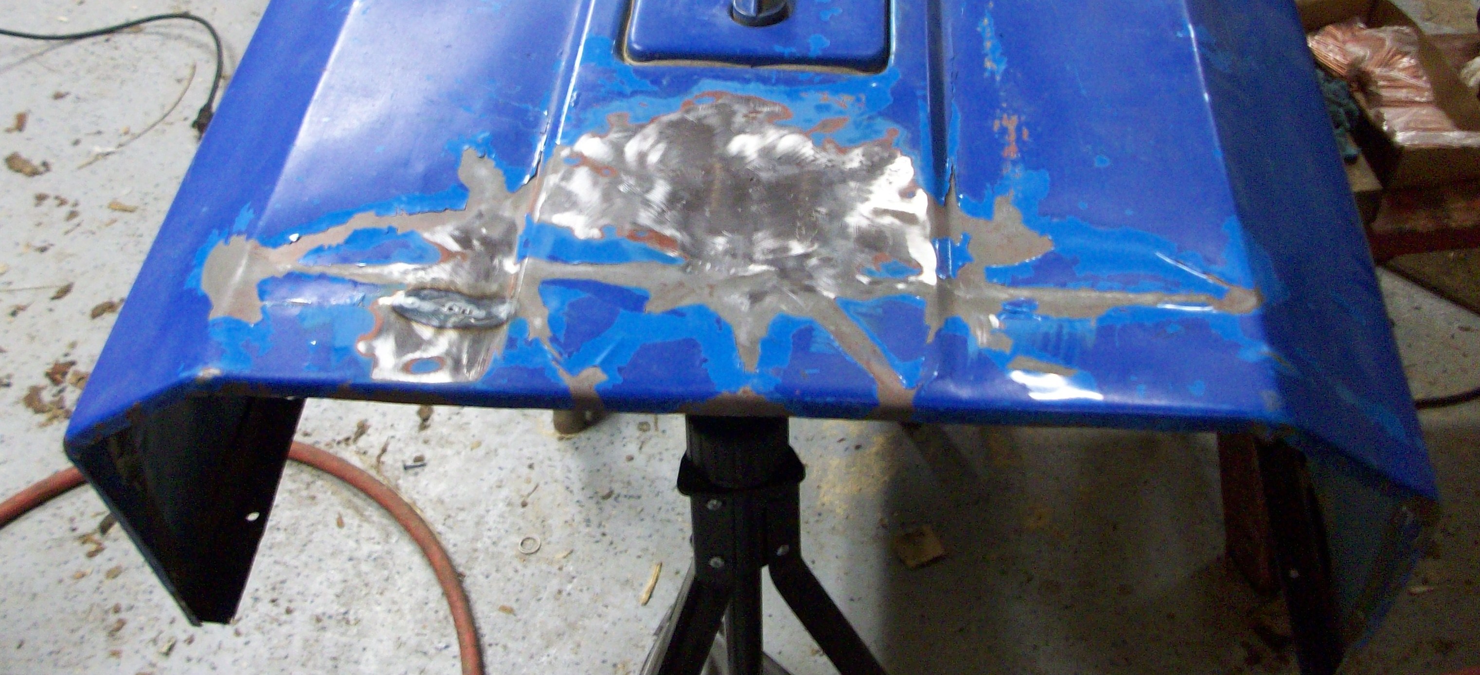

the hood so far-the metal was stretched so bad that hammer dolly/torch- wet towel wasn't enough. Finally used a 3" cut off tool then pressed it on the log splitter then mig welded and ground it down. anyway here's how it looks so far , Thanks for the input, and you guys are right on the mark there's definitely bondo or Short strand fiberglass in its futurerhino-bodywork2 004.JPG
