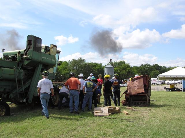

However, this was Class was different, it had tractors and was very interesting and informative. This class along with other Firefighting and Rescue classes are given once a year by the Emergency Service Training Institute Texas Engineering Extension Service at Texas A&M University in College Station, Texas. The class is 36 hours and last a week. About 2300 professional Firefighters (paid and volunteer) from all over Texas and beyond attended this week. The Ag-Rescue class is limited to 75 people and the class was full.

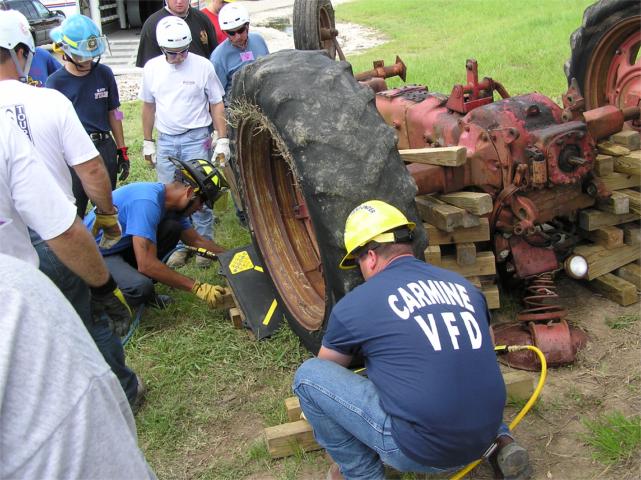

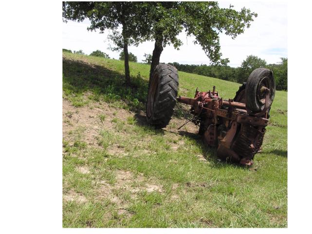

The tractor scenario we had was an older Farmall had turned over and was upside down on the side of a dam. The driver's leg under the rear wheel.

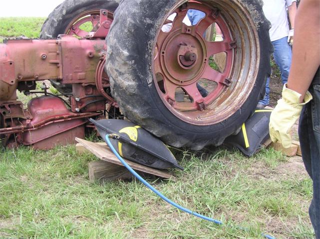

Using wood blocks (cribbing) we stabilized the tractor and lifted the rear tire by using a "cylinder lift" with air bags. See attachments below.
As you can tell by the last picture we learned all the places that farmers get hurt and trapped on their equipment. We also learned how to rescue a person from a grain storage bin.
So I guess you might be asking: "How was the wife entertained while I was having my tractor fun." Well, go to the last picture, see the smoke in the background, she was putting out a car fire in Firefighter Phase-One course.;)

Eagon, Our VFD also does not have the equipment and manpower. Our training on the new equipment is limited. The Instructors were very helpful and understanding and they suggested different sources of knowledge and equipment, for example: (1.) The mechanics at the local JD dealership could help dismantle the equipment quickly, (2.)train with and use mutual aid with the surrounding VFDs that have the equipment needed, (3.) the farmer's neighbors might have knowledge of the equipment and have the tools needed or know someone that does.
They also pointed out that whenever you move equipment watch out for the other side of the equipment it will move and may make the matters worse. Use cribbing every inch of lift on both sides of the equipment, have EMS ready to transport when you relieve pressure from a crushing injury, they told us how to prepare and transport amputated parts, etc etc...

Jim, all conditions and the victim must be assessed. There are no set rules. This set-up depending on the number of people present and their training would take about 10 minutes once on location with the equipment. Star-Flight from Austin will take about about 30 minutes to get here.
The rescue can be done with whatever you have to work with, just be careful not to hurt yourself or the victim more.
