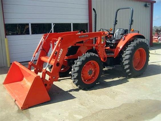

I suggest you look at a Kubota M59tlb it should be able to do everything you want to do and do it well. I have a Deere tlb and separate tractors and really like them but if buying straight up I think a good riding mower and the M59 fully equipped would be a very good choice.

I have a Kubota M 6800 that would do all you need. Make sure you get an FEL, Ag tires, and load the rear tires. I would recommend something in the 55 to 70 horsepower class, in a Ag tractor, whatever the brand. The size has never been an issue for me and I use it in really tight places often. I would also recommend a grapple on the front instead of a bucket. It is much handier for all round use.

hi ,welcome to this site. I suggest you have a look at Kubota M 6800 and Kubota M59tlb from your description.
