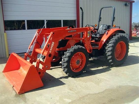

We found a Kumatsu D31p that a guy was really needing the cash picked it up for $6500,had to fix the tensioners and the thing runs like a champ. As for tractor I can do alot with my Kubota M5040(now is 5140) 5140.jpg
