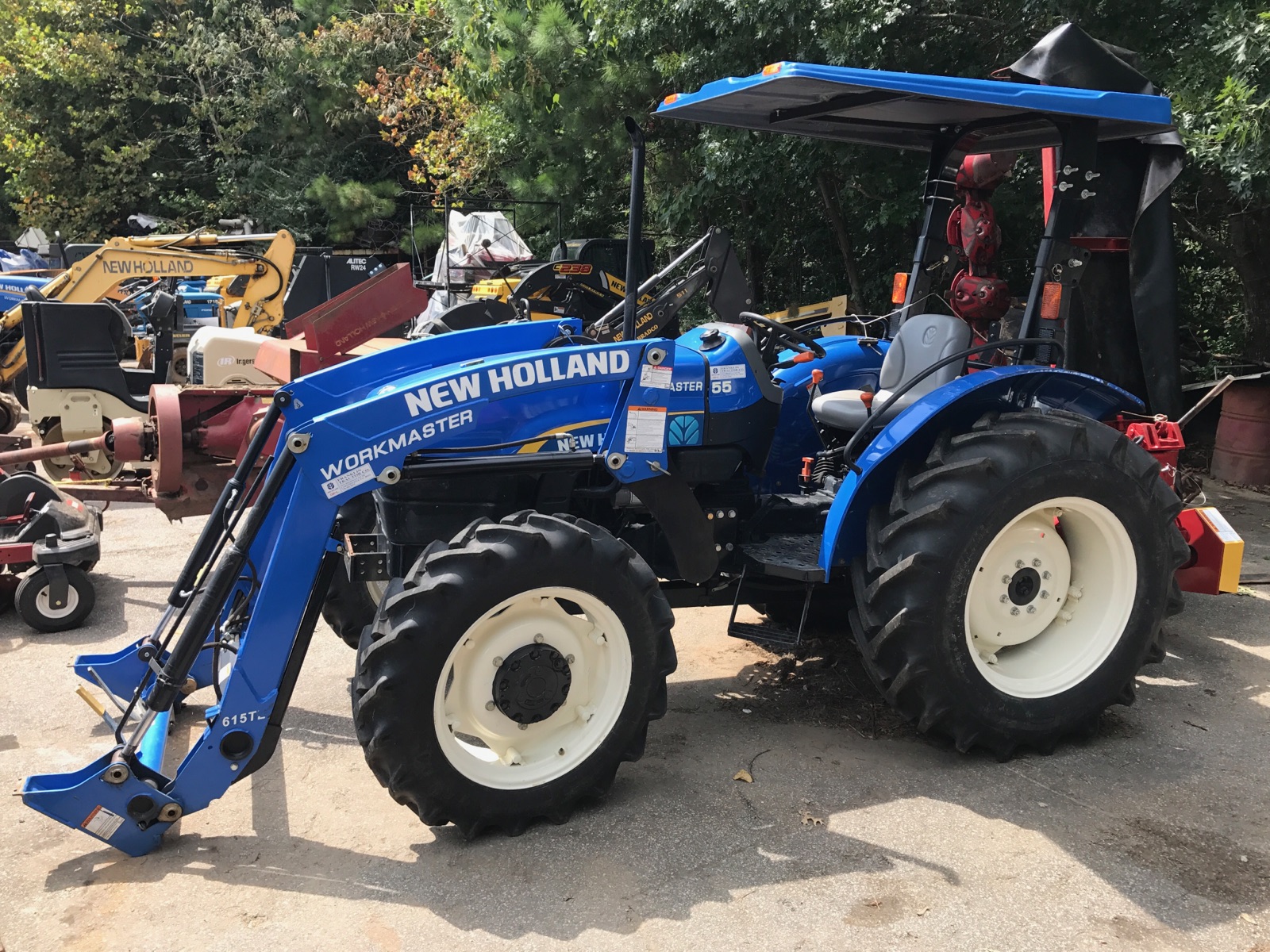

OP, just noticed you are in TN. This Tractor is in middle GA at a dealership, trade in. I think it was a 14', it's a Workmaster 55 with 202 hrs, asking $20.5k. That's probably in line with most the tractors you mentioned new. May be to big for what you are after, but passing along just in case.
