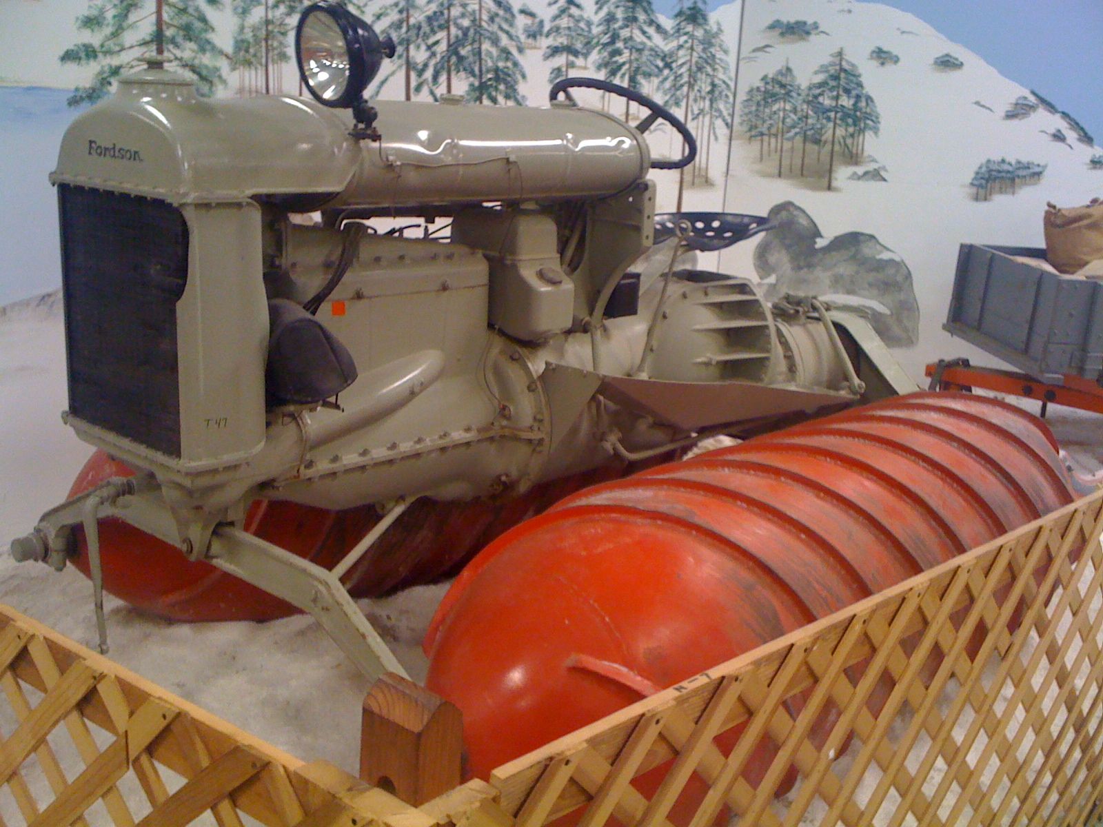

Much to my surprise, I actually ran into one of these at the The Heidrick Ag History Center & Antique Tractor Museum in Woodland, CA. See below:

Yes I too have seen this unit before and have asked the same question. WHY did it not sell like hotcakes,...it seems like a magnificent idea. Not just for snow but anywhere,....even be great on desert sand and swampy areas etc.
It is a great idea to "begin" with and could be lowered slightly for better COG and various changes and adaptations could be a wondrous machine. Doesn't have to be expensive and could be made just as safe as any other "thing".

The Russians also tried this design for one of their military vehicles. I suspect these didn't catch on is due to the rigid nature of the screws. They can't adapt to changes in terrain the way tracks can. A track system can follow the terrain more readily than a rigid screw can. With the screw, it's possible to get just a small contact point on the ground with the rest of the screw eating air. This is what I noticed on the Russian vehicle when they were driving it on solid to marsh ground.
However I still think this is an extremely interesting design concept that unfortunately didn't pan out.

Thanks for finding and posting the Russian videos. Another thought I had concerning the screws is that the flights would be subjected to extreme wear, especially if they are made of garden variety steel.
