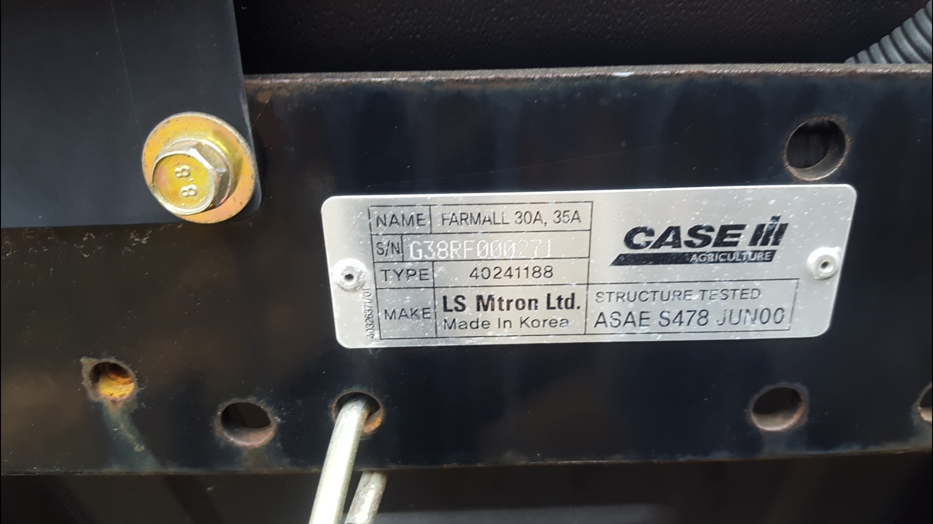

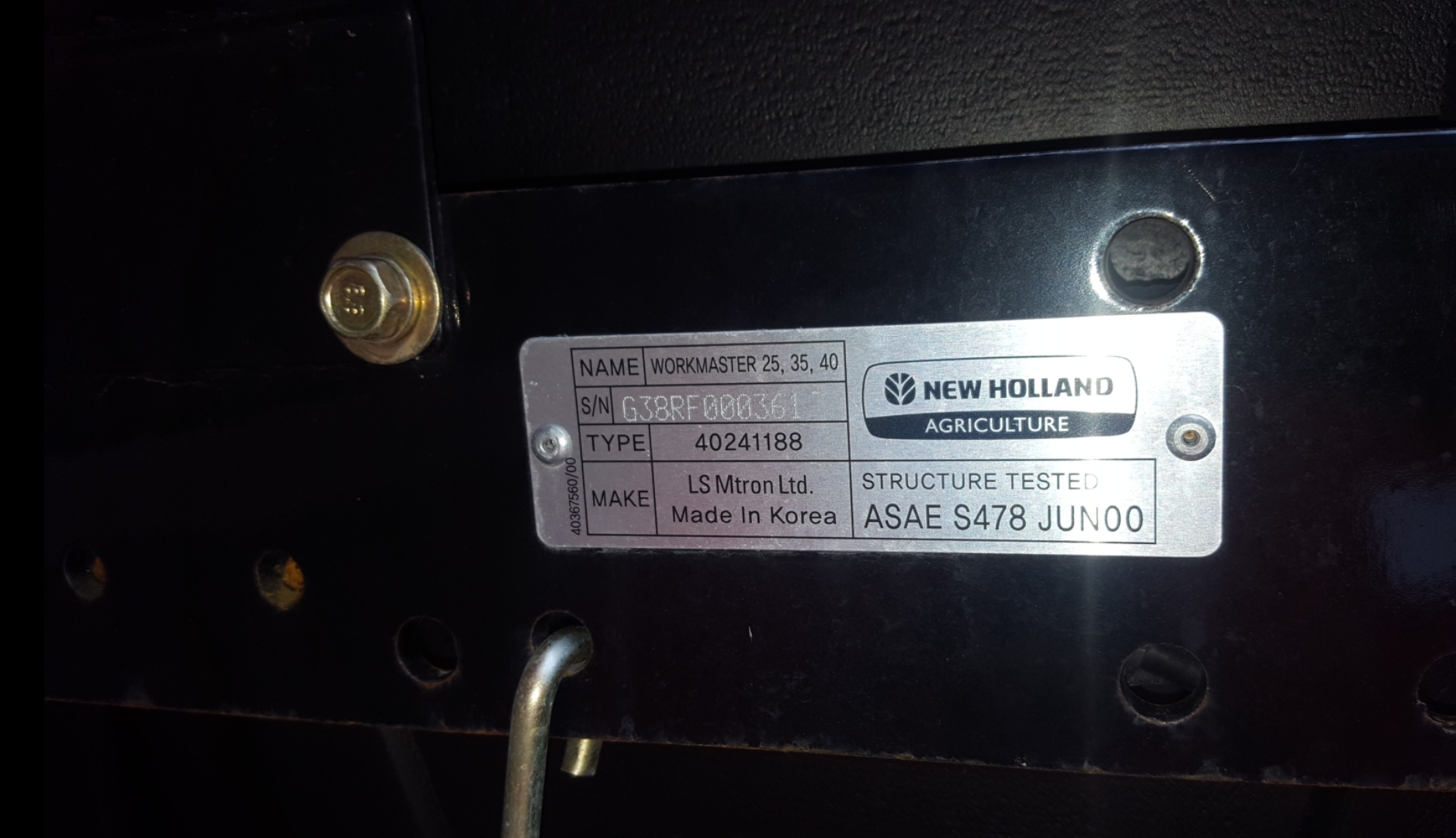

For those talking about the fit & finish of Korean tractors, I am curious what you think about the "American" CUTs by New Holland and Case IH.
I took these pictures last year at the county fair:
I bought an LS branded LS tractor and I got the same tractor as a Case / New Holland but for thousands less. And the loader that LS puts on them is much more stout than those Red and blue ones. It's a better loader than comparable Kubota and Mahindra models. I'm talking about the construction of it, not the specs. You can see the difference plain as day, just go look at them, take pictures, bring a pair of calipers if you want. LS is using 1" thick steel plate in places where Kubota is using 1/4" plate, and JD is using cast iron.
This wasn't supposed to be a promo for LS, just a counter example for the assertion that Korean = inferior in any way whatsoever. You DO get what you pay for, and what you are paying for is too often just a name.
