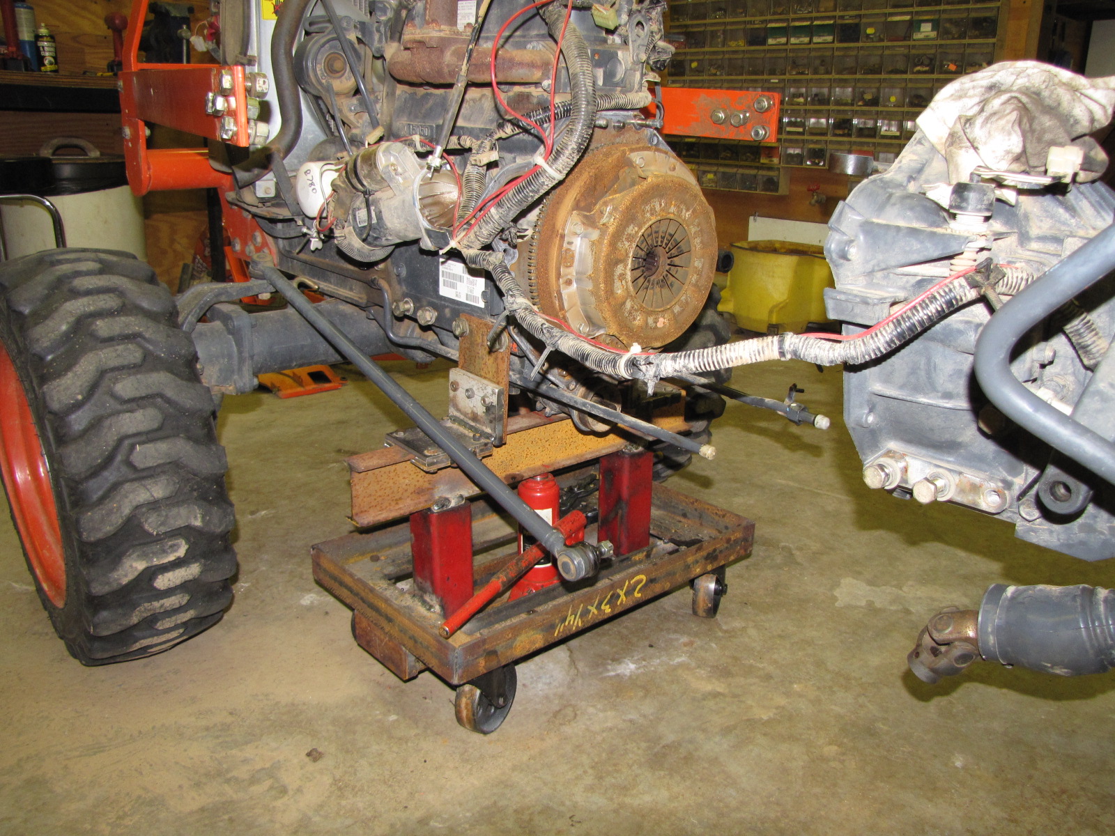

Here is what I made. It has been used on my L4240,B7800 and a 70 hp ford. All I had to do was make the plates that bolt to the tractor then bolt that to the slider on the small I beam.

Zebrafive I'm not knocking your splitting stand. In fact I like it. But if you really think about it you don't need a swivel wheel or wheels. If you are only moving the tractor parts a few feet apart to change a clutch or whatever then the wheels don't need to swivel. True they won't come back together 100% perfect but if you use alignment bolts it's close enough.
Yes, no need for a swivel wheel. I "over thought it" when I built it. I have not need alignment bolts
