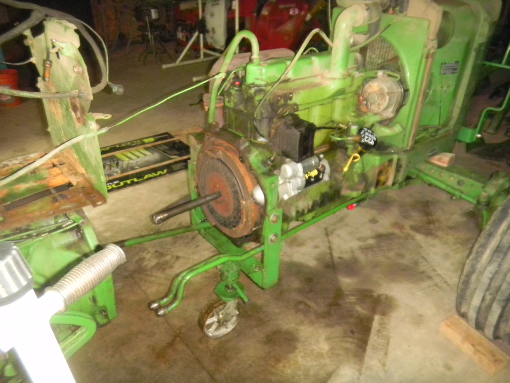

I built my own. U shaped to bolt to the same bolt holes that hold the side frames on at the rear of the engine. I made it so it adjust for width for easier installation. It has a single swivel wheel on a large threaded rod for height adjustment. I move the front/engine forward when I split and leave the rear half un moved with a floor jack to hold level.
I have also seen two separate stands (one for each side) to bolt to the side frame, each with a wheel at the bottom.

/ Tractor Split - Splitting Stands #12
Zebrafive,
Nice! I'm not sure my welding/fab skills are good enough to make my own at this point. Like to see a picture of your stand if you've got one.
Thanks for the ideas!
Here is a picture. It's my JD 203 split. I like to roll front 1/2, I think I have more control with the stand's swivel wheel and steerable front wheels.

Zebrafive,
Thanks for sharing that picture!.. Very nice. The side-to-side maneuvering with that single wheel is possibly even easier than with 2 wheels. (I'd buy something like that stand for a reasonable price).
Something like that is what I need for the front-move stand approach. But I will probably try the front-move lift approach as that is what I have available. (My current floor jacks are old and need attention so I'm not sure I want to trust them with the rear/cab movement at this point).
