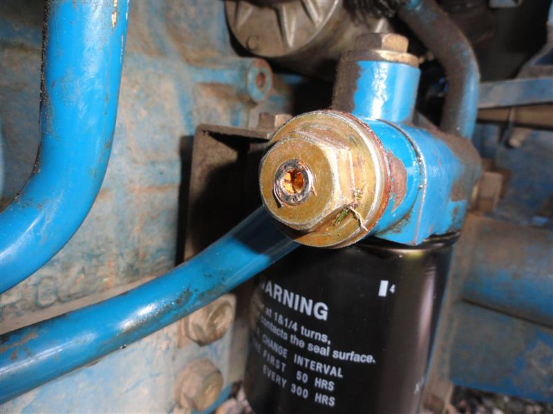

Luke you can read your charge pressure at the fitting as recommended. I would take the bolt and manual to a local hydraulic shop. They should be able to precision drill and tap the bolt for you. There is no issues using a plug in the end of the bolt after performing the tests.
If you are not comfortable with that you can get a spare. I don't know were you got the $300 price for the bolt I would bet $30 tops. Don't worry about purchasing a new bolt until you resolve the issue.
Another option would be to temporarily remove the hardline between the filter and HST. Bring them to the shop and get the proper fittings, tee and hose for testing. The banjo bolt is usually (npt or bpt) and can be replaced by a standard fitting and hose.

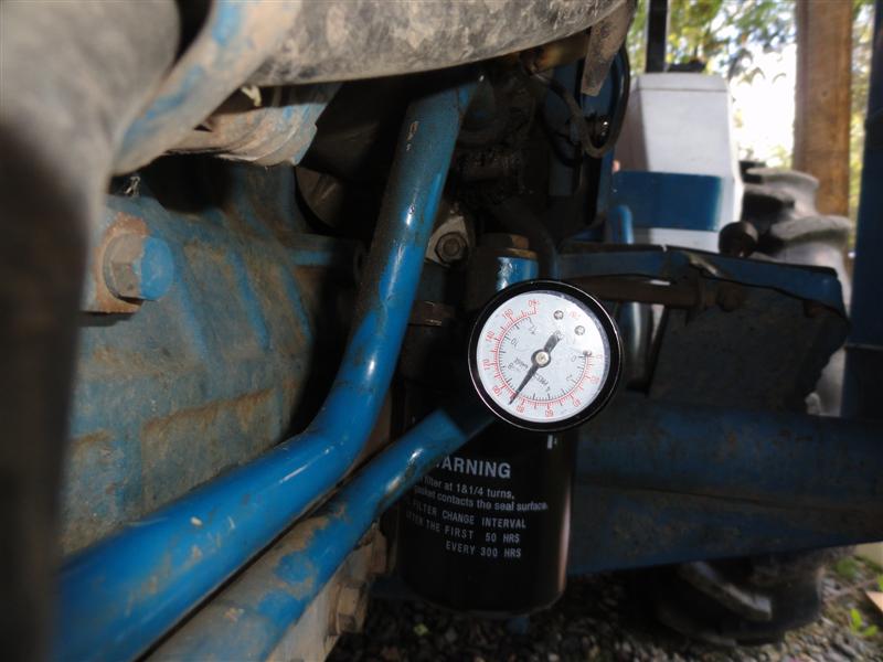

Today I drilled and tapped the banjo bolt and screwed in a 1/8" NPT pressure gauge I had (10 minute job - and free!) and checked the charge pump pressure.
At 2000rpm the pressure was 90psi, and the lowest it went was 60psi when the throttle was set to the lowest rpms. This is exactly where the service manual says the pressure should be.
After removing the gauge and before installing the plug I started the tractor and a nice solid stream of fluid started coming out of the hole in the banjo bolt. I don't think that actually tells me anything since the fluid wasn't flowing through the cooler, but it doesn't appear there is any issue with those components anyways.
I guess my next step is to separate the tractor and take a look at the high pressure relief valve and then the hydrostatic unit itself. Maybe it's something as simple as the spring in the relief valve has deteriorated.

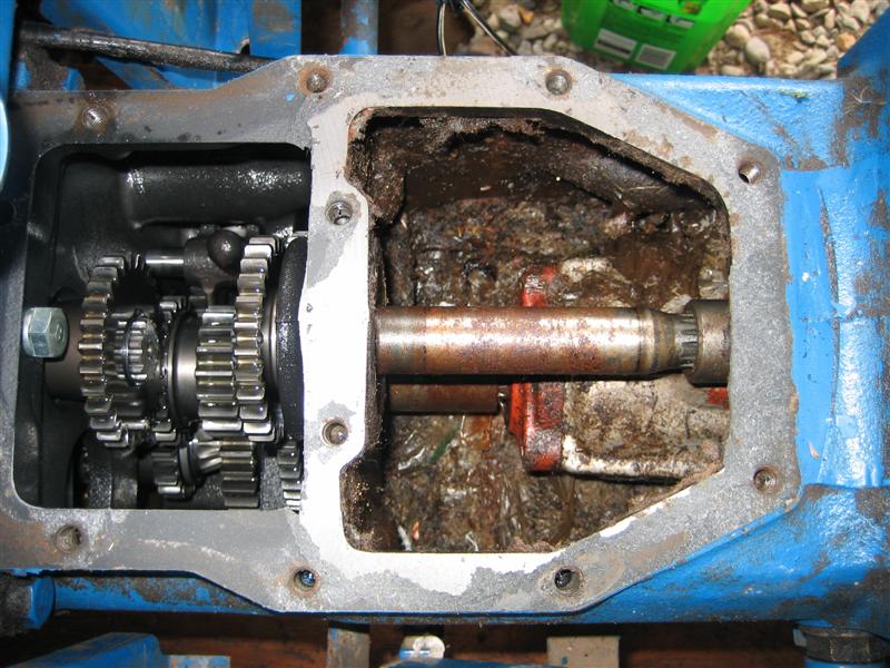

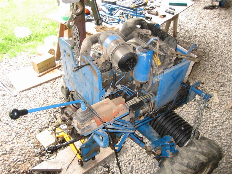

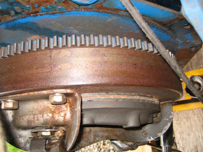

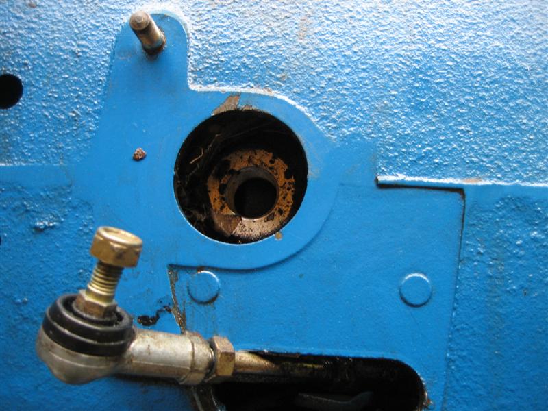

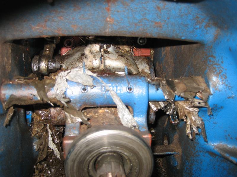

   / Tractor squeals under load after getting warm
#56

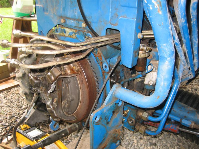

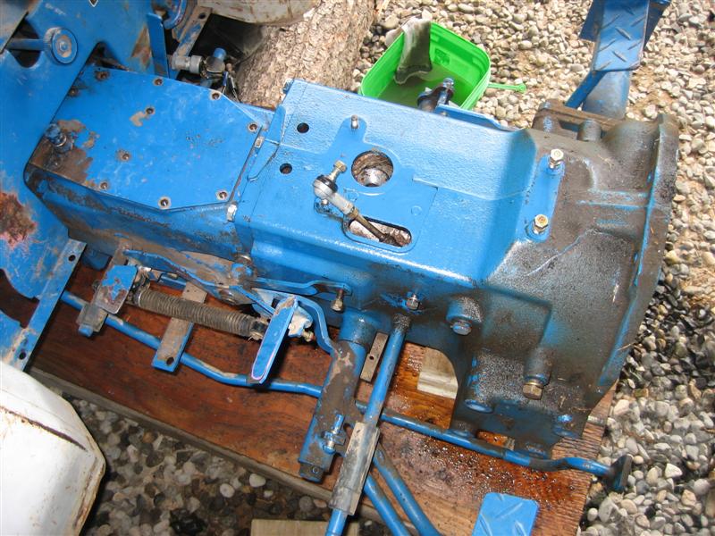

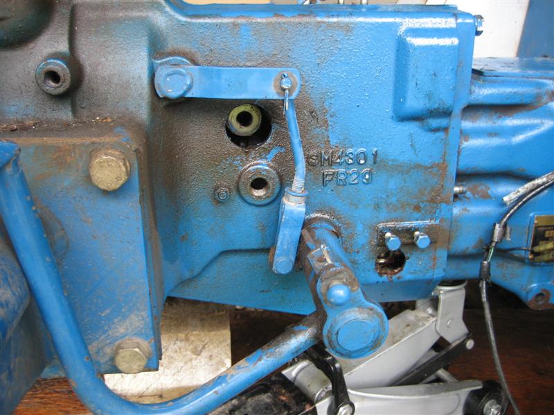

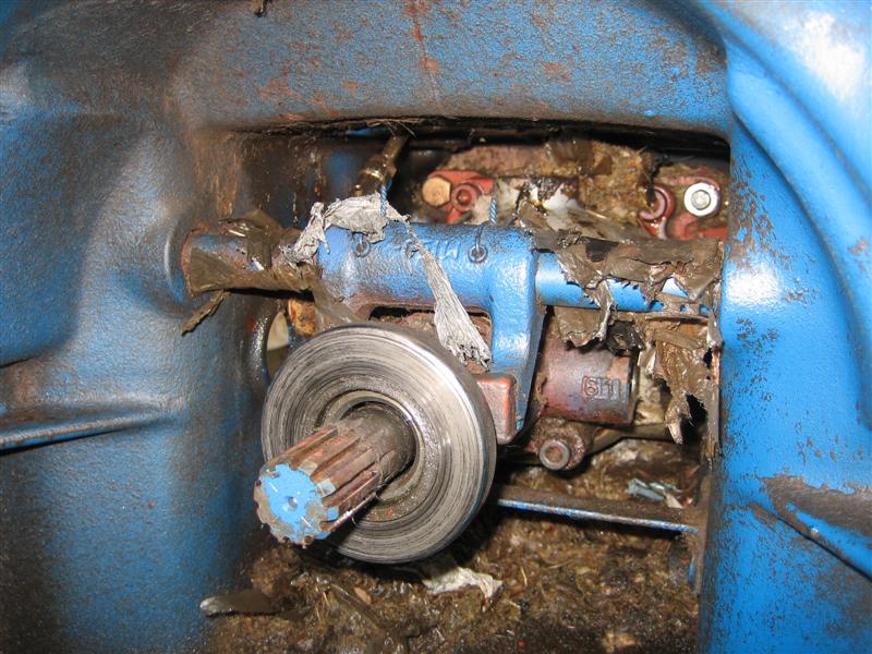

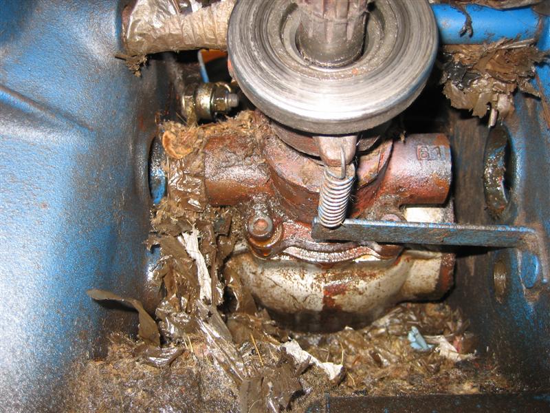

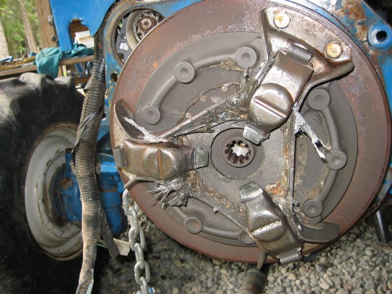

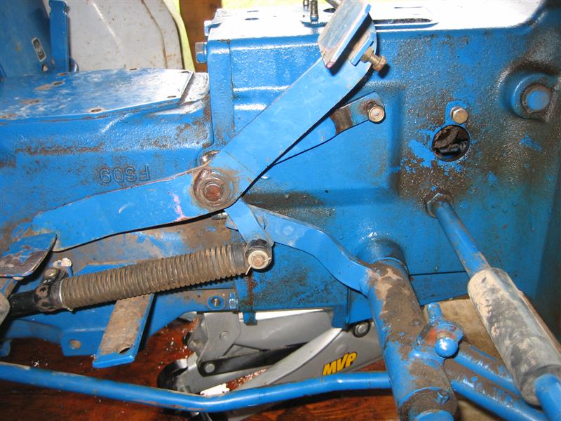

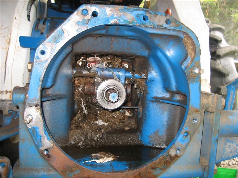

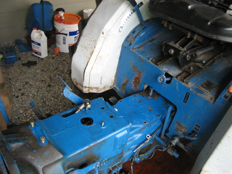

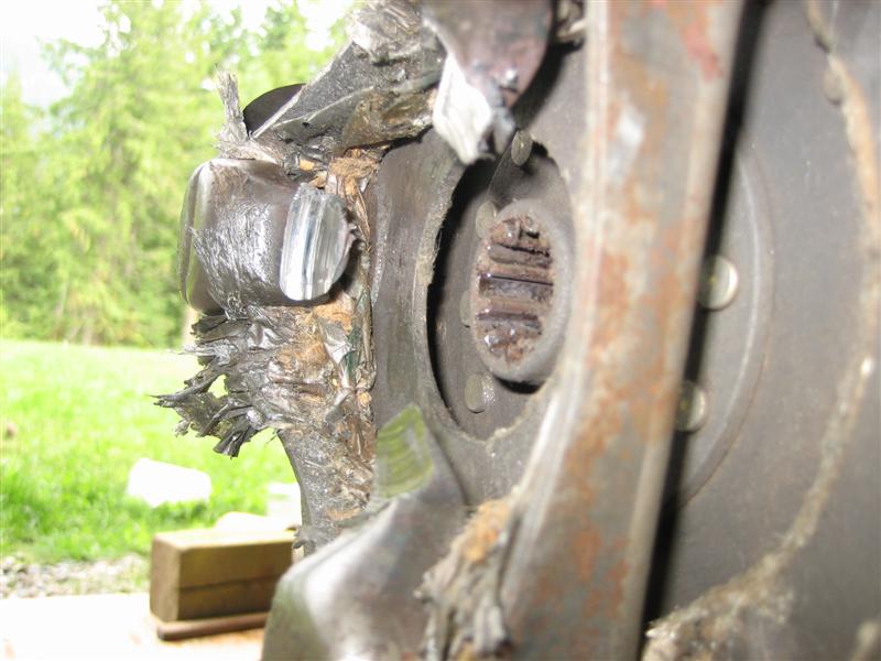

I separated the tractor! It was pretty easy, other than the fact that I first tried to separate it behind the steering wheel because that's where the HST is and I didn't have to remove the diesel tank or the steering wheel, but there are bolts inside holding the two haves together.
I ended up separating it between the engine and clutch at the bell housing, which is what the service manual says to do anyways.

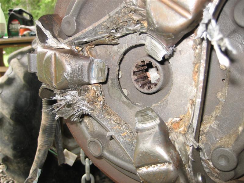

I found that the clutch release bearing is completely seized and quite worn. Where the bearing has been rubbing on the pressure plate, the fingers are almost worn right through and there is only about 1/16" thickness left. It appears that the set screw on the rod connected to the clutch pedal that adjusts the free play is too tight and possibly wasn't ever allowing the bearing to disengage the fingers completely.
I'll have to get a new pressure plate, and I'll also have to take it off to see how the disc looks.
I'm not sure if this is the cause of the loss of hydraulic pressure (squealing) as the engine heats up, but it's more likely this than the high pressure relief valve because there is a high pressure relief valve for forwards and one for reverse and I can't see them both exhibiting the same behavior.
I'll take out the HST drive, check it, clean it and also check the high pressure relief valves while I've got it apart.
I've attached some pictures showing the clutch and some plastic and stuff around the HST and around the pressure plate. It looks like a mouse may have been living in there.
Thanks again for the inspiration and tips.

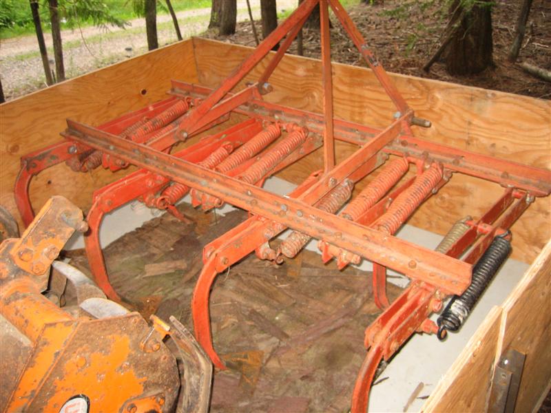

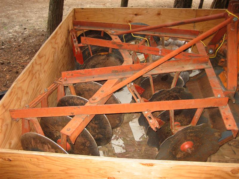

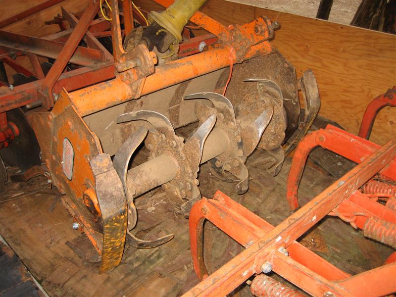

I now have a reason to fix the tractor - before the snow comes next winter. I spent a few hundred dollars today on some implements for the garden!

   / Tractor squeals under load after getting warm #58
OH, MAN!
The whole squeal problem was the mouse!!:laughing:
It doesn't like going backwards. Don't you know 'nothing about mice?!;)
The clutch bearing that rests on/ engages the pressure plate is referred to as the throwout bearing. There may be another smaller 'pilot' bearing that goes into the flywheel where the splined shaft runs through the pressure plate; but I'm a car guy so I can't say for sure they're used on tractors too. If there is one replace it too. Depending on the condition of the clutch disk and the flywheel face that it contacts you may want to have it resurfaced so you don't get chatter when you put in the new disk, etc.
Great pics; keep 'em coming with the reassembly.:thumbsup:
Wait: I'm confused?! How can you have a clutch and an HST?! You either have a manual or an HST transmission, not both!
Seems you clearly have a manual transmission; therefore you can't also have an HST.
Am I missing something?

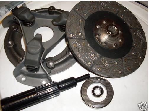

It's got a HST. I've never actually used the clutch for anything, although I have pushed on the clutch pedal to see what it did but it never seemed to do anything, which it probably didn't... A friend told me that he thought the clutch was probably to allow the disengagement of the PTO, possibly for safety.
I've already ordered a new pressure plate, both bearings, etc!
The entire clutch kit cost $179 - not too bad so far!
