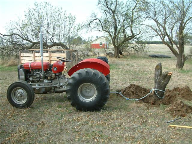

Some modern orchard tractors generally have a low center of gravity since they have to squat low to avoid damaging the trees. And standard field tractors can be modified fairly easily to lower the CG. My 1964 MF135 diesel is a case in point.
The normal tall rear wheels have been replaced by BF Goodrich 6-ply 18.4-16A tires (18" wide, 16" dia rim, 40" tall overall) and the front axle spindles have been replaced with shorter ones to keep the tractor level. The previous owner made these modifications to work in his olive orchard.
Good luck.

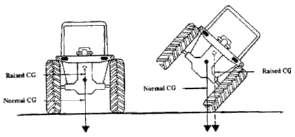

"If you feel that it is unsafe then it is certainly is unsafe." ..so it comes down to feelings? A center of gravity height to width ratio also might also be a useful basis for comparing different tractors.
Well, if one thinks an area is unsafe, it probably is. Although, as mentioned before....it's also a matter of developing a comfort level with the equipment.
As far as this:
As I'd written in my original response, the manufacturer has no control how operators equip or use their tractors. A comparison such as you suggest would be for the tractor alone and could give buyers a false sense of security.

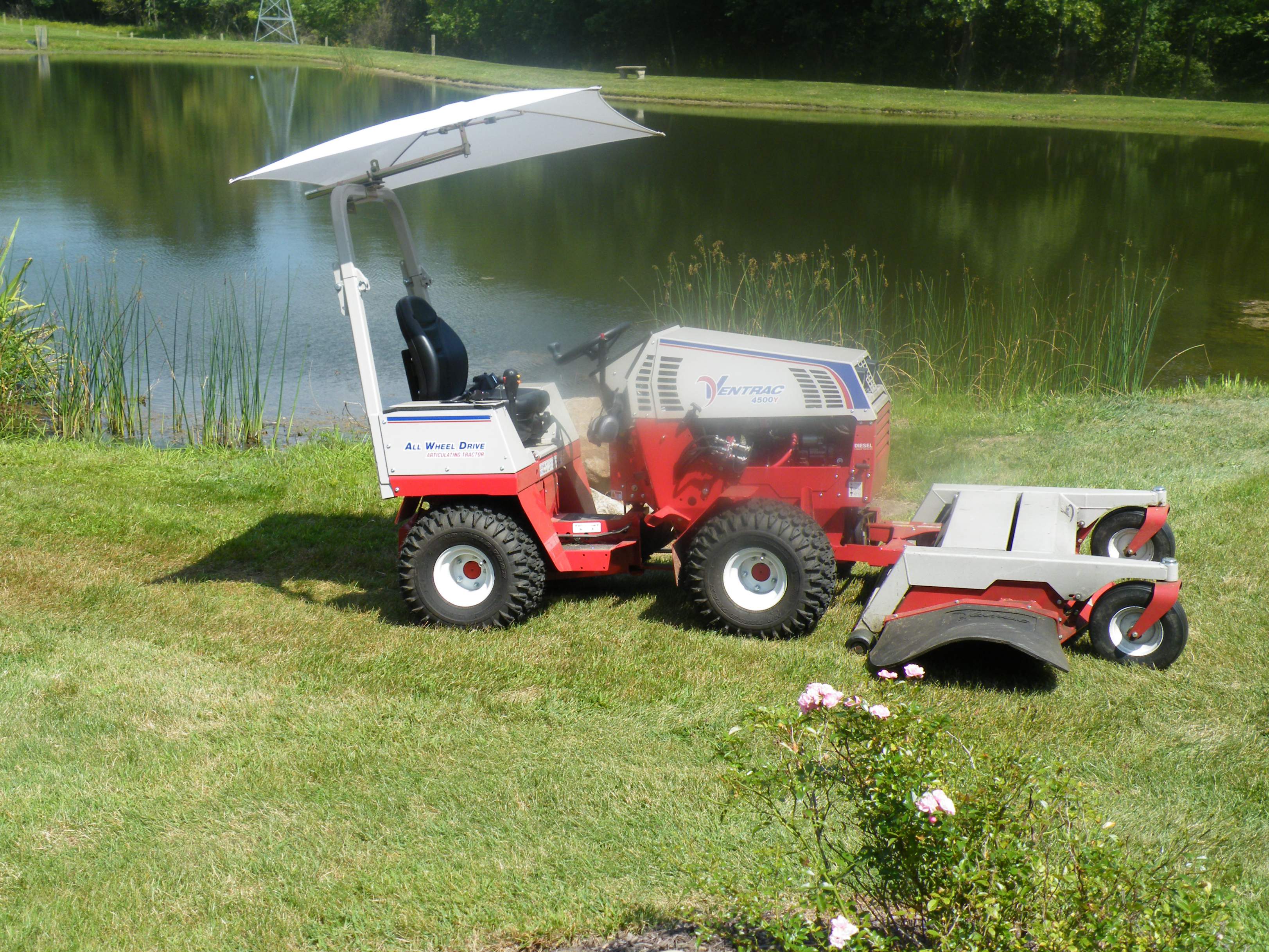

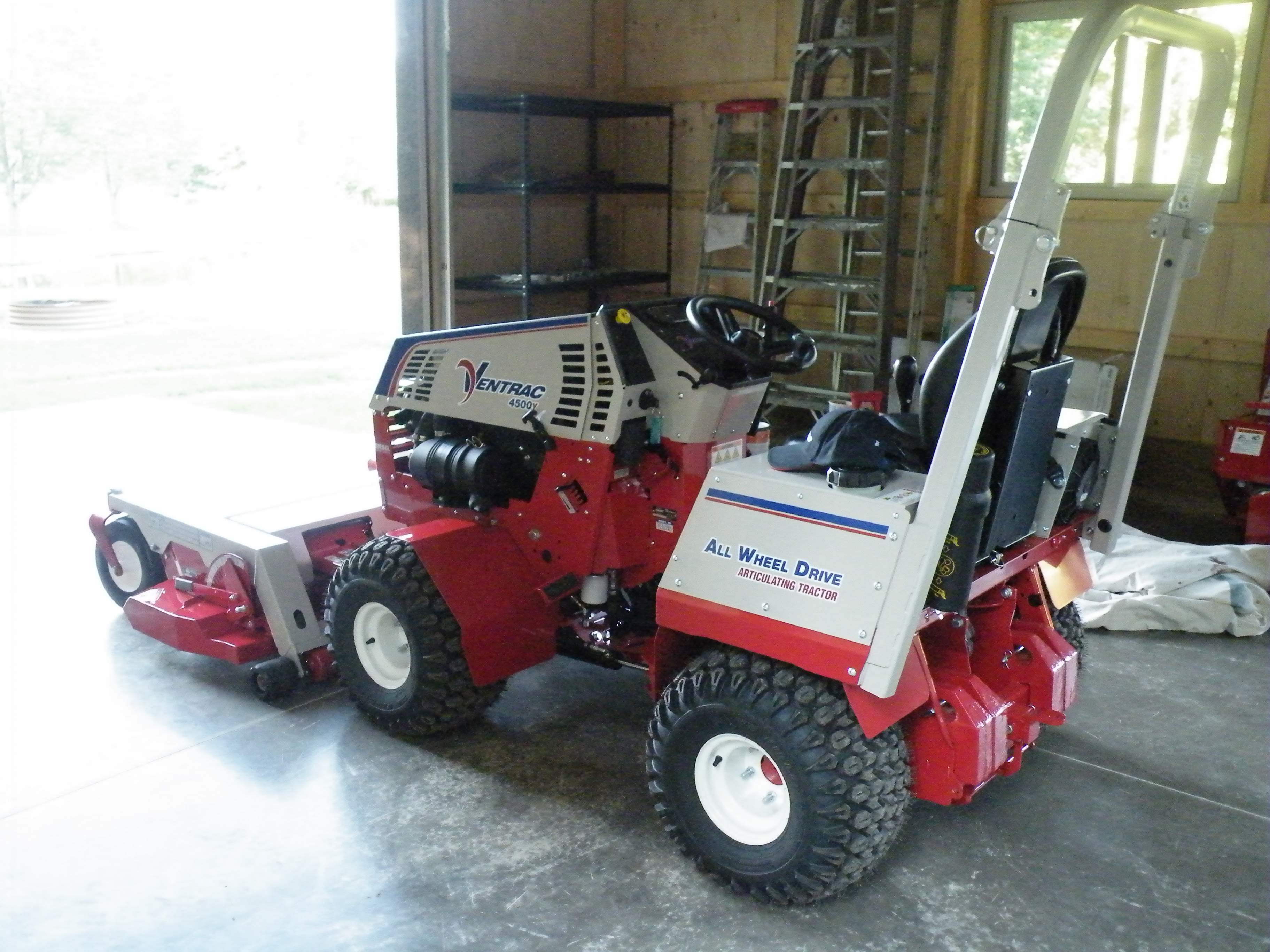

I use a Ventrac on slopes, Good for the Pucker factor.
