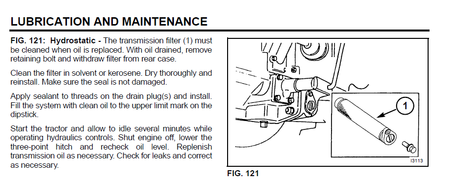

My manual says to replace transmission oil and clean the filter at 150 hours. So, I guess my tractor is over due for transmission oil change. Is this the same as hydraulic fluid? How do you "clean" the filter? Can anyone point me to a thread or any existing info on how to do transmission oil / hydraulic fluid change on a MF 1433 or equivalent Challenger MT265B tractor? thanks.
All of the tractors I have owned have had a replaceable hydraulic filter. Yes the hydraulic fluid and the transmission fluid are one in the same. What did you manual show about cleaning the filter? Is is a screen you remove? It should have shown some pictures or drawings I would think. To do a hydraulic fluid change, typically they will have several drain plugs, a main drain plug and usually some on the final drive cases on the rear axle near each rear tire. Usually the front axle requires a change at the same time. Be sure to look in the manual for the recomended fluids for each. The front axle is likely different, and is not a part of the common sump. Since this is a Hydrostat tractor it is likely to have a hydrostat filter that needs changing also.

I should have read the manual more carefully. It does provide instructions on how to clean the filter. I'm adding to this thread so it might help someone with the same tractor in the future.
