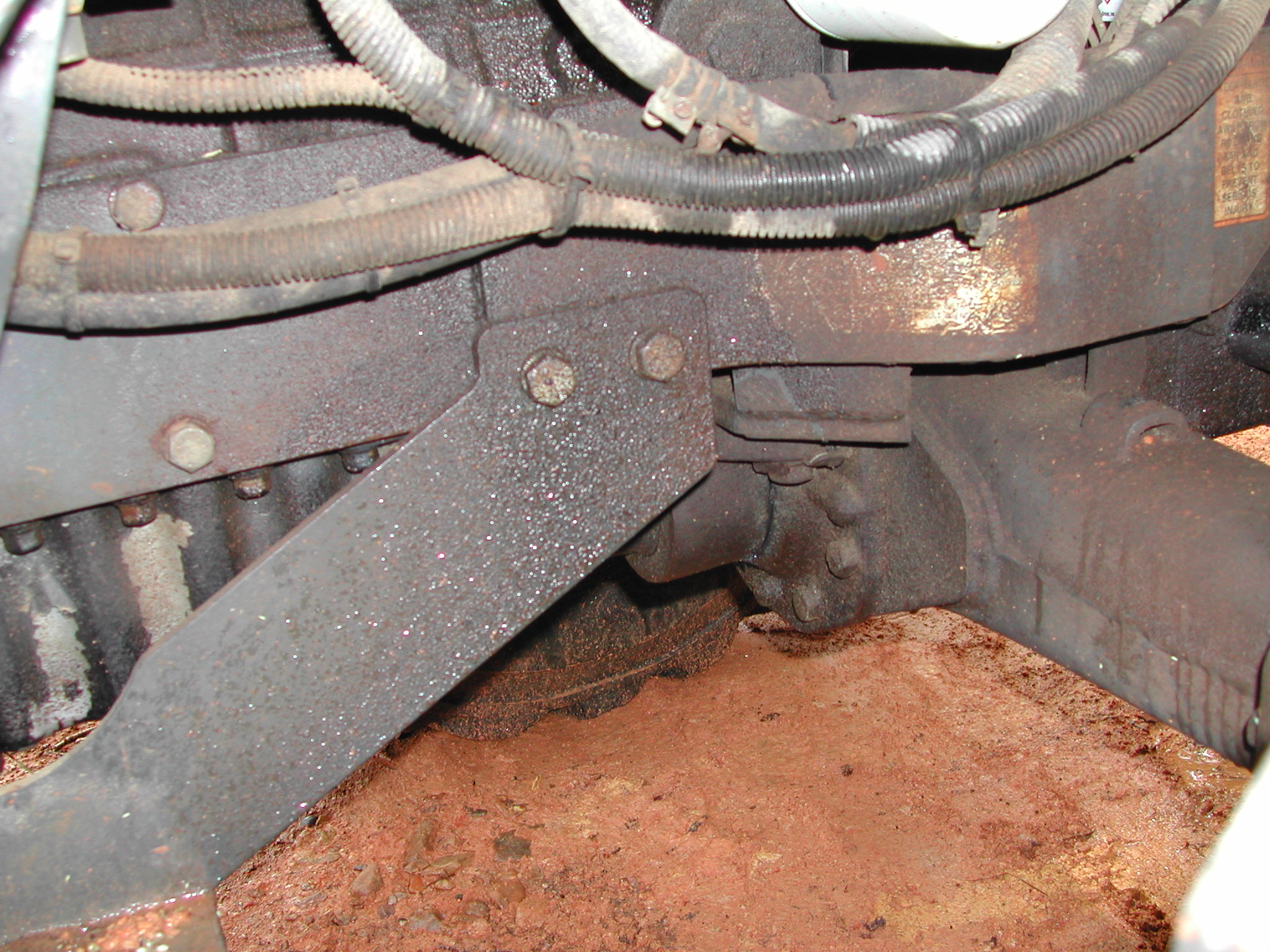

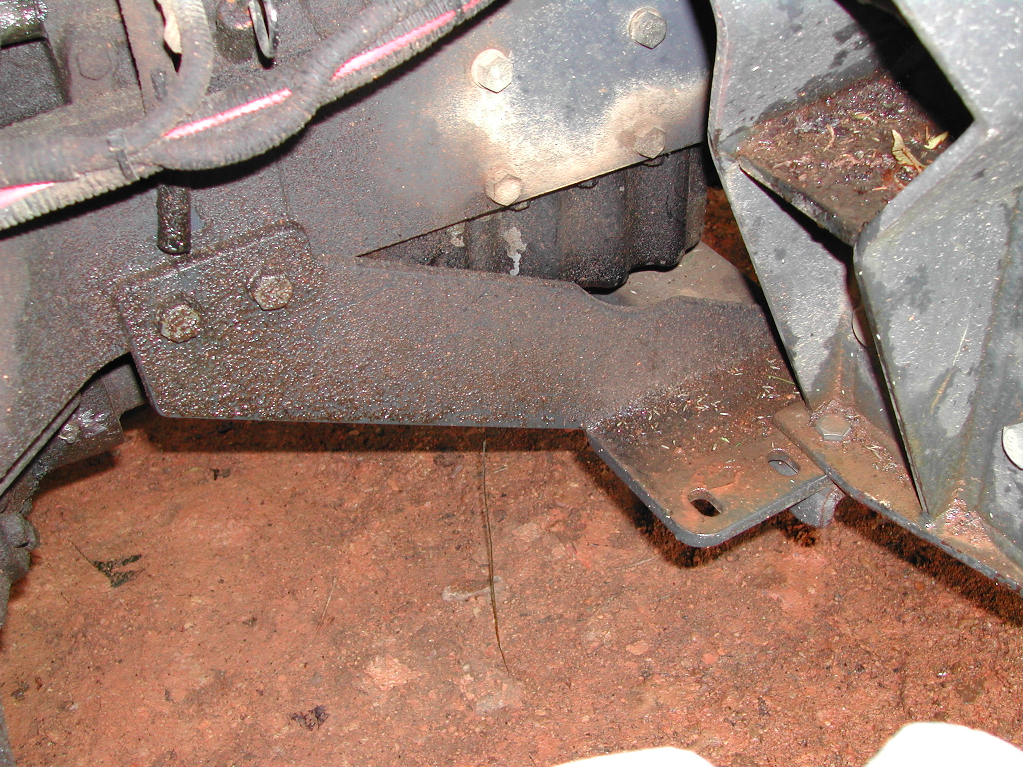

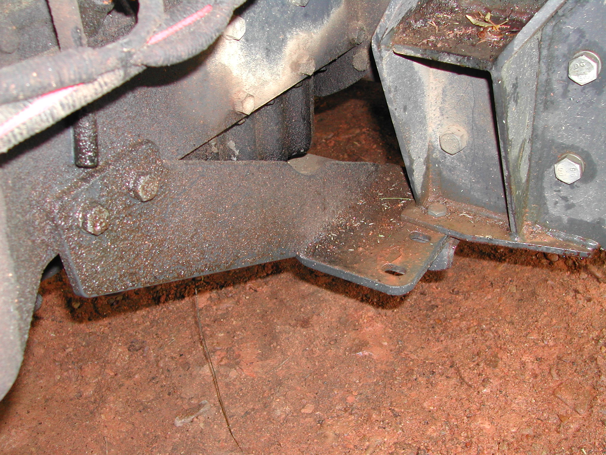

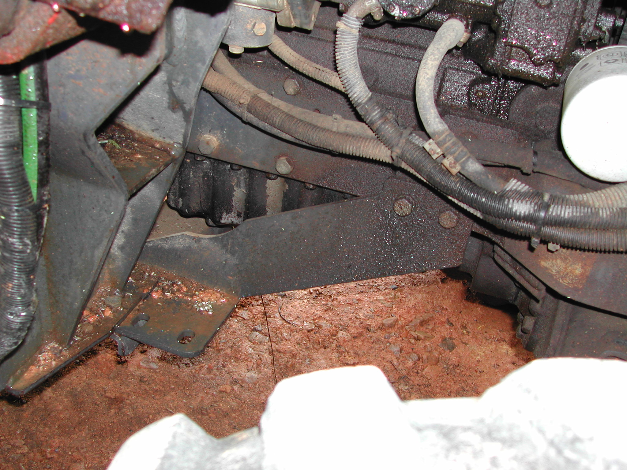

I just got to the post - I'll try to get some pics of them tomorrow (Fri). They came from Mahindra and really added some structure to the engine/trans connection. Supposedly these were standard in 4110s built later than mine. Honestly don't know if Mahindra/TYM produced them or KMW did for the loader kit. Mahindra sent them to me at no charge back when I was discussing my problem here back in 2004 or 2005, whenever it was.
OK - it's Friday and here's the update. I was able to take a couple of pics AND found the packing slip that came with the braces to me in July 2005. They were built by KMW Ltd. and the part number for the pair is 1590-2008, called rear mount brace package. If I remember correctly longer bolts came with them for the ones that go thru the frame rail into the engine block and the bolts/nuts to connect them to the crossmember.

Thanks! I started to fab up some bolt on brackets connecting the same frame pieces and then got lazy and just welded some braces in. I connected the loader frame to the engine frame. I’ll look for those brackets, as I tend to work my equipment pretty hard and any additional support would be helpful. Thanks again for the pictures and info...very helpful.
