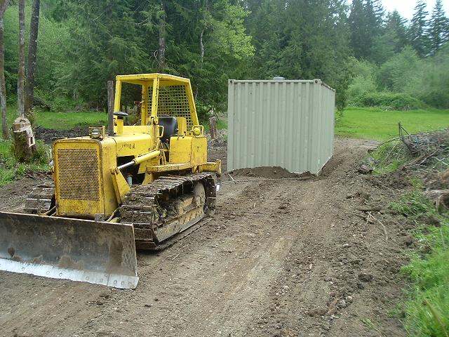

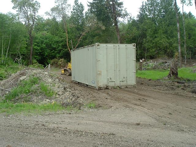

My tare weight was in the 5000 lb range too. The dozer did not damage the wooden floor of the container except for where the oil leaked but that oil should prevent rot even better than the fancy marine plywood they used.
I am not sure if a tractor could just drag it along. I moved the container with the dozer and it wasn't very easy. The front of the container digs in like a tractor pull sled. It's not the weight as much as the brick shape digging in. It sure leaves a smooth road though.
In your particular case, you should have shortened your cables so the dozer was picking up slightly on the front of the container. It would have pulled at least 40% easier.
I moved one 1/4 mile in desert sand with a 2 1/2 ton 6x6 truck during Desert Storm. Gotta pick up on the front to prevent the shovel effect you had. Then the loose material under the container acts as a roller.

Good point, if I was able to keep the nose from plowing then it would have been much easier but to be honest the leveling effect was a pleasant surprise and key to my education at the school of hard knocks. I thought to myself "cool, a nice flat road" then when winter came I discovered why a flat road is no bueno. That road is now heavily crowned.
